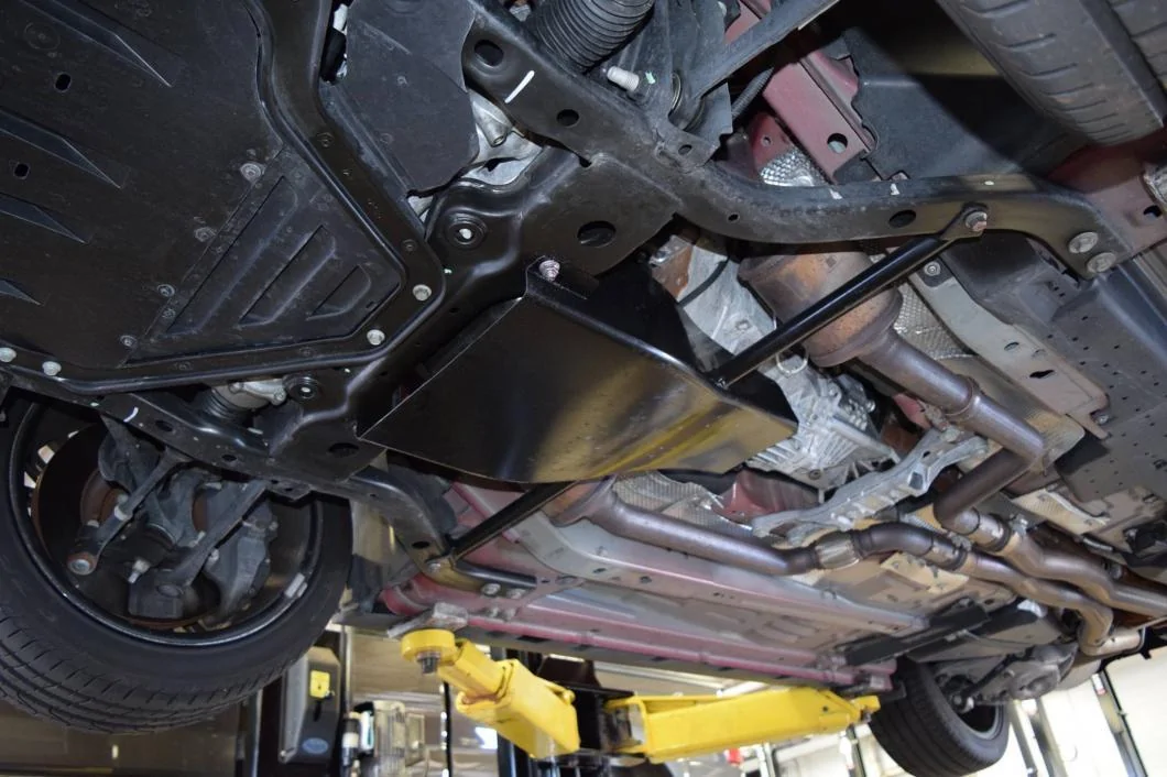

Oh noooooo. I dont have the skill to fab something like that... or the knowledge.... or the tools.... or the materials... I kinda suck. I was crawling around under the car today getting ready to wrap the exhuast and Im not even sure my idea would work. The diff is tucked pretty neatly underneath the exhaust. While driving the air is blowing over the engine, tranny, the full length of the exhaust and then kinda sorta onto the diff but not really because its tucked up so high.

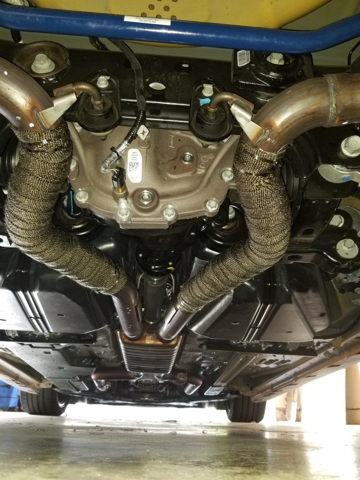

Anywho, Im also worried about the wrapping the exhaust. It has small metal heat shields already between the pipe and the diff. If I wrap them Ill be insulating that area, not allowing air to flow between the pipe and the shield. I may be doing a good bit of work for nothing. If the wrap and the 75w-140 fluid doesnt really do much to help then I may pick up one of these tanny coolers. It looks like it forces a good bit of air across the tranny which is a bonus, but
would also funnel a good bit of air in the direction we want. Again, this would be hot air blown over exhaust and tranny, but still likely cooler air than a 300 degree diff. Id rather not have to mess with taking it on and off every time I hit the track though as it would be to close to the ground for daily driving. Not sure if this will fit a 2018 though.

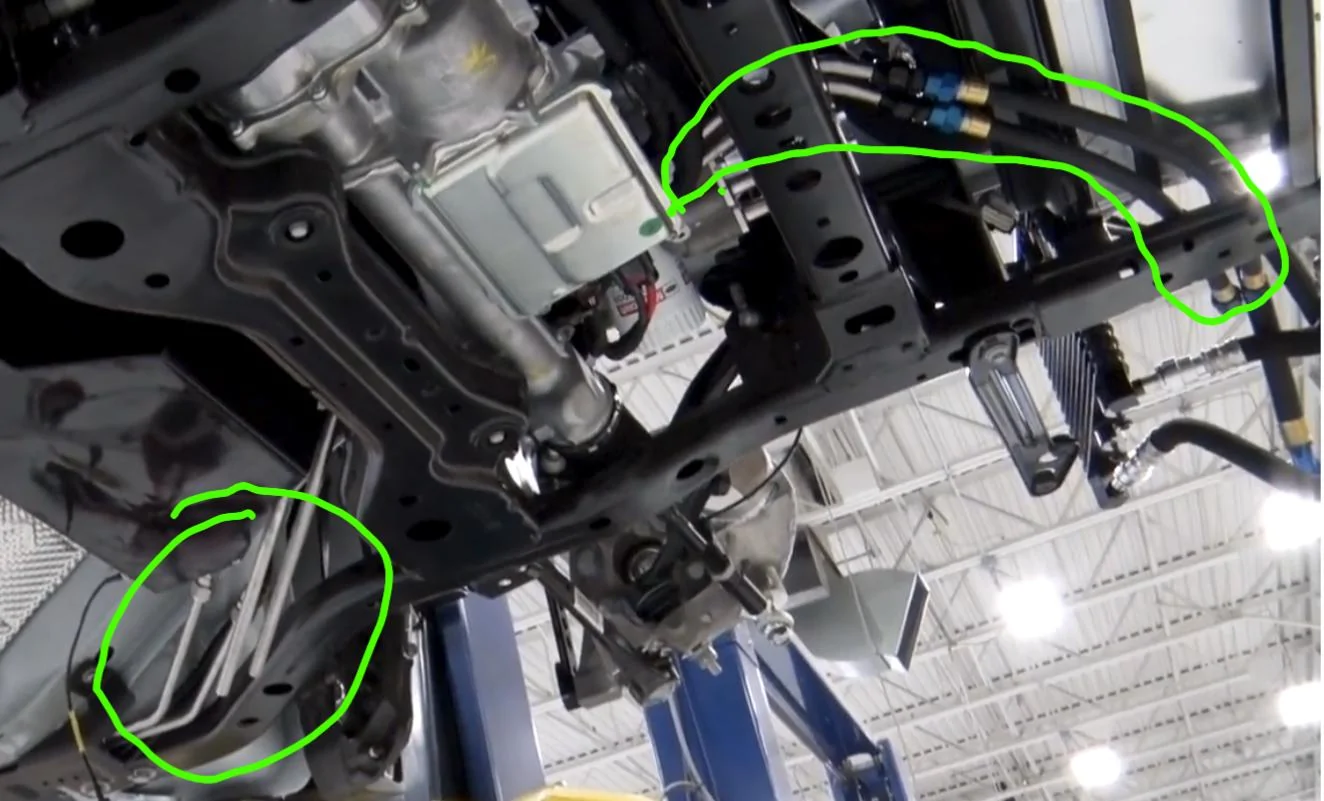

The FP350S put the diff cooler in the front. American Muscle posted a video interview with a FP engineer explaining the oil cooling improvements.

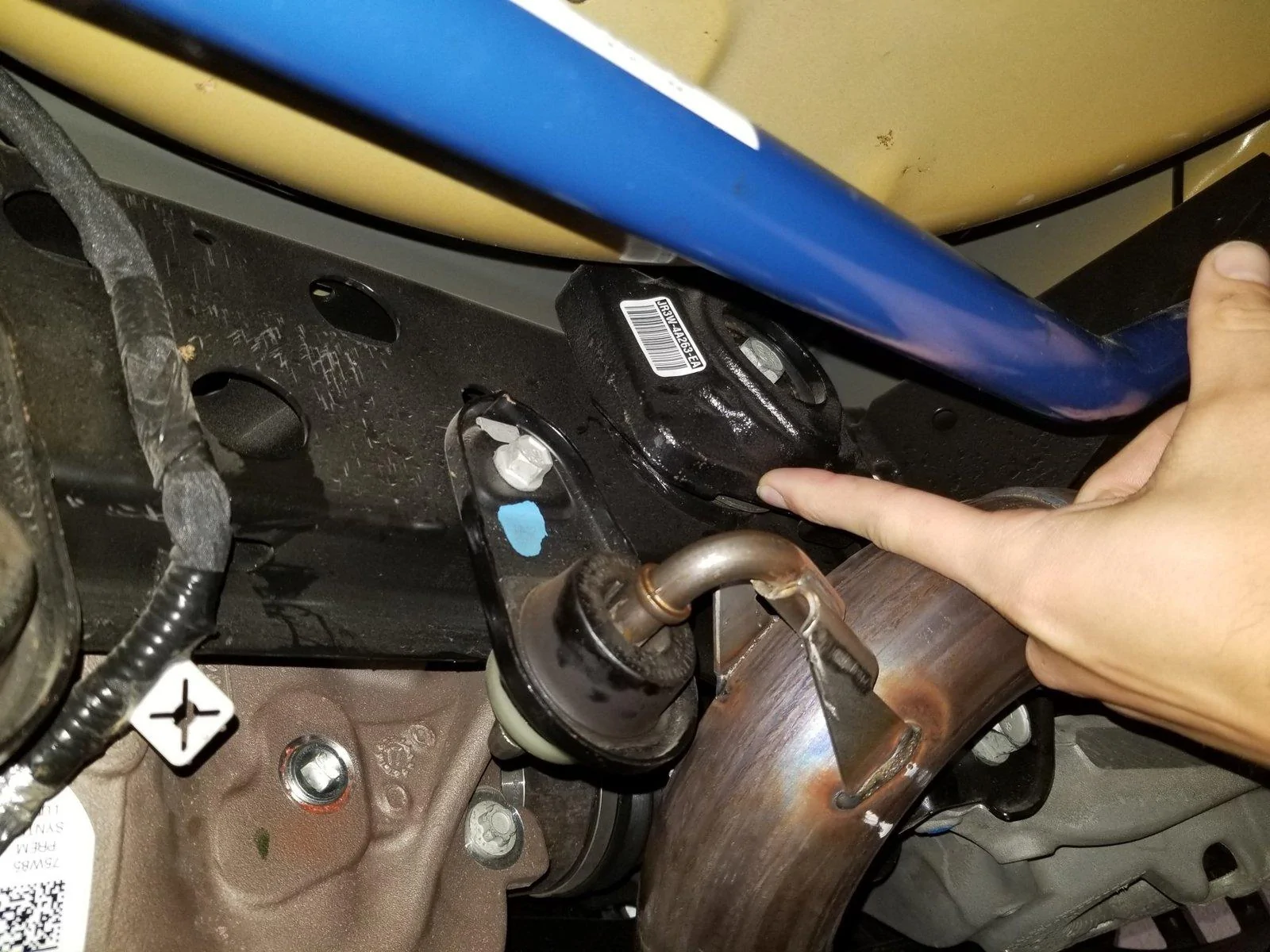

Ok, 75w140 and wraps installed, albeit sloppily. I shall see how it holds up next weekend in 100 degree temps. Also, does anyone know what this is? The thing im pointing to in the pic right behind the diff. Its like a flexible rubber... somthing. I thought the bolt was backing out at first.
