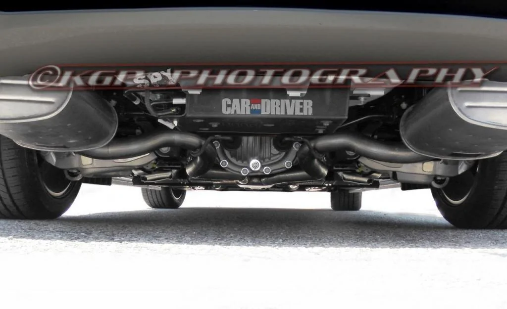

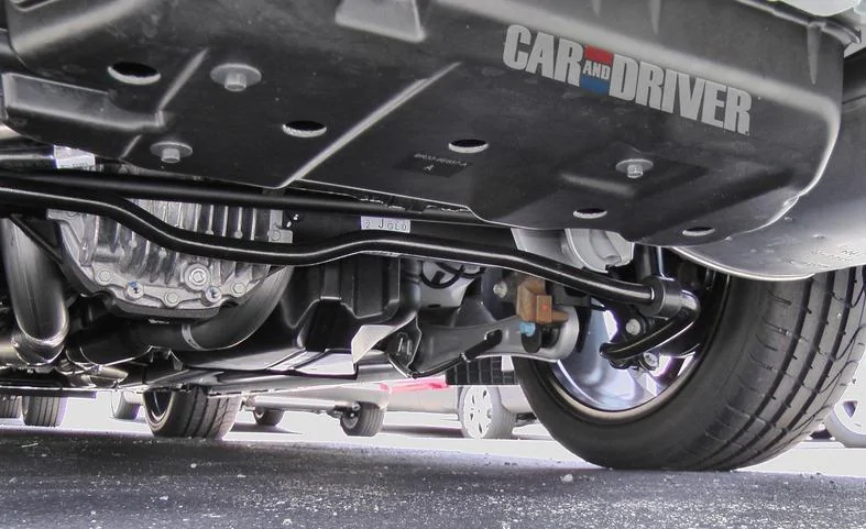

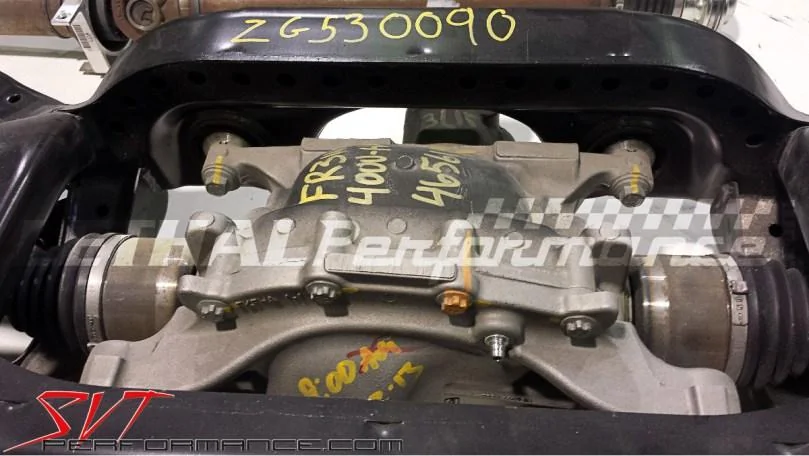

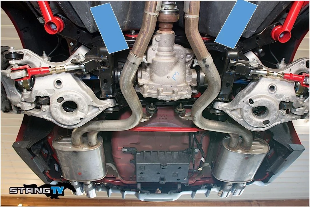

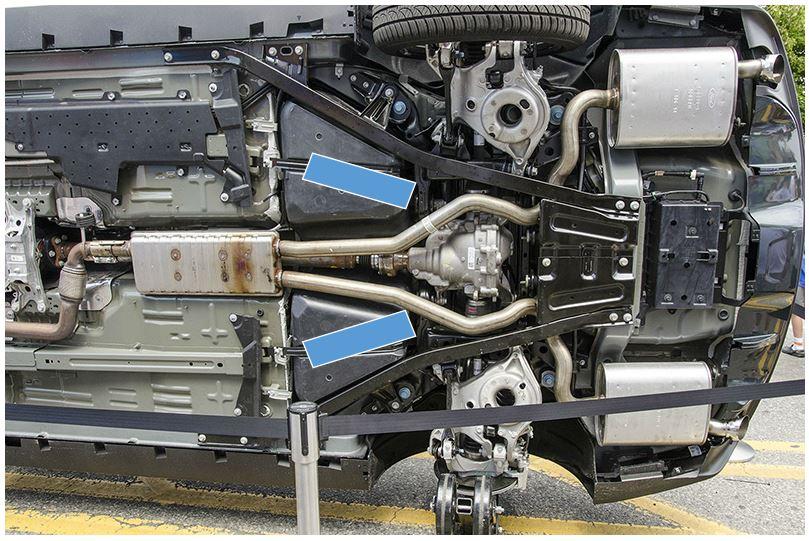

What Camaro does is essentially what you are talking about. The differential on the G5 ZL1 and the G6 SS/ZL1 cars are not cooled with their own, separate cooling circuit. What GM does is use the transmission cooler system by having the lines loop into the differential unit. Now, GM does use a small heat exchanger inside the differential unit, but the idea is the same. The overall system is cooled by one, fairly large, heat exchanger at the front of the car. Automatic cars also utilize the cooler inside the radiator as well.
The more I look at the underside of the Mustang, where everything is located (exhaust, suspension links, the IRS cradle structure, the diff housing, axles, etc.), I beginning to think that a finned cover may not do much. The reason is airflow - you won't get much since the S550 diff is pretty well tuck up and into the rear structure; you can argue, then, why did Ford and the aftermarket do a finned cover for the SRA cars, but the SRA sits lower and the architecture of everything in the rear of the older cars has less in the way.
If you look back, the early designs of the S550 did, indeed, have a finned cover:
http://www.drivingenthusiast.net/se...is-2015-mustang-irs-pre-production-prototype/
I think something creative, at least to get through a 20-minute session, could be done with brake ducting being placed strategically under the car to direct airflow towards the diff. You will see something similar done on amature/semi-pro race cars for the rear brakes and, in a similar functionality, with all levels of racers as an ad-hoc AC system through the front windows (works really well, I can vouch for it).
Also, consider a breather element in place of the jiggle cap if you only drive the car three-seasons. There is heat in the internal air, too.
Worthwhile read if this isn't posted/seen already:
https://torsen.com/667-2/
