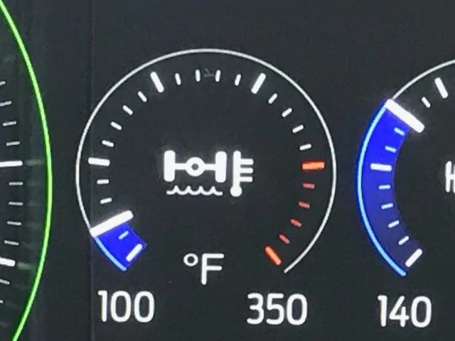

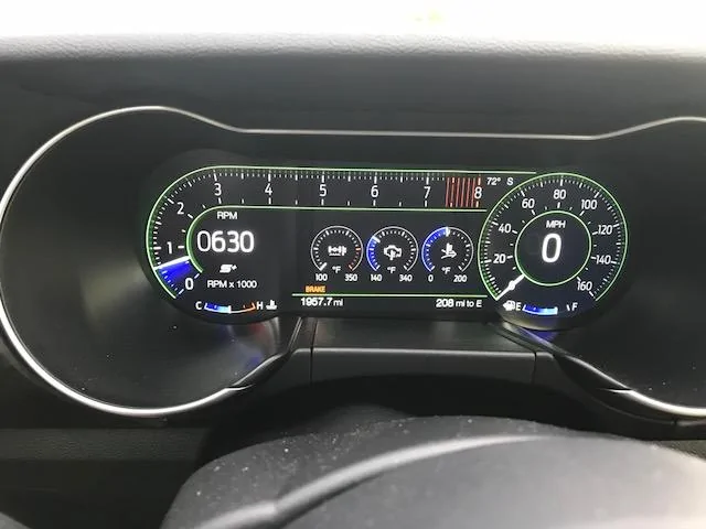

Have it selected on my digital display, works fine in daily driving... does take a while to one up to 100 f+
This photo was only about a ten minute drive...

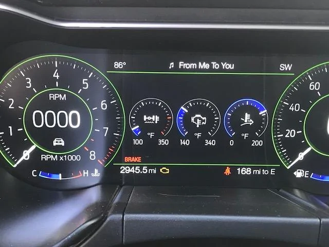

A couple more pics. This is after a 9 mile drive in 90f temps. Sitting in the driveway for about five minutes after turning it off.
