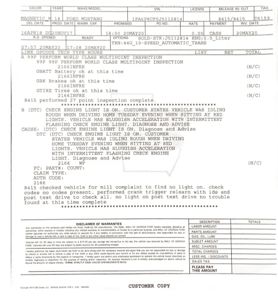

Driving last week, and I noticed when I was sitting at a red light that it seemed to idling really rough. RPMs were hovering around 400 but bouncing up and down, and it felt like one of my kids was kicking the bottom of the seat - at first I thought I though I just had the stereo up too loud. At the next red light I noticed that it was still rough, and it seemed a little sluggish when I accelerated. During the last couple of miles on the way home it was still rough, and I started getting an intermittently flashing check engine light. Parked it when I got home, ate dinner with the family, and then drove it to the dealership for drop off that night - it drove completely normally and didn't seem rough at all, of course.
Service department looked it over the next day. Test drove it - no problems, checked it for stored codes (none) and performed a crank trigger relearn on it with a normal post-service test drive.
Since then it's been fine. Service notes are attached below.

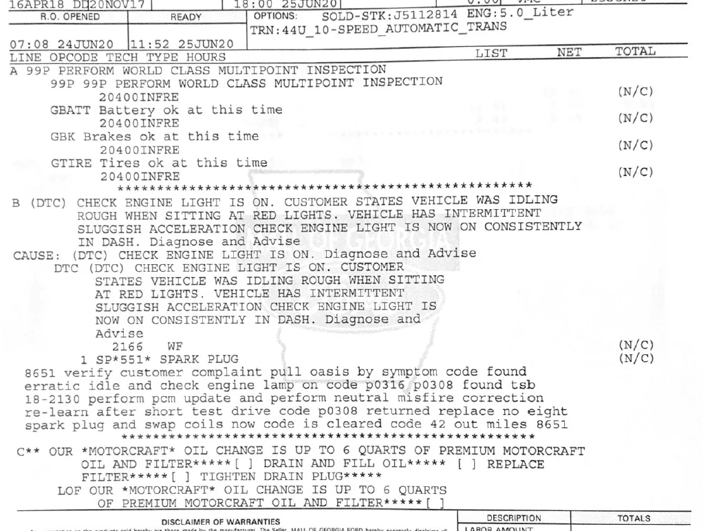

I got the car back yesterday. Service notes included below.
It looks like my car was showing both the p0316 and p0308 codes. Based on TSB 18-2130, they reset the PCM and performed a neutral misfire correction relearn. After a short test drive, the p0308 code returned, and they replaced the spark plug for cylinder 8 and swapped the coils which cleared the code.
The car ran like butter this morning on the way to work. Honestly the best it's driven in months. Makes me wonder how long this issue was going on. I haven't seen any check engine lights other than what I reported in this thread, and I'm pretty attentive to it given my past issues.
