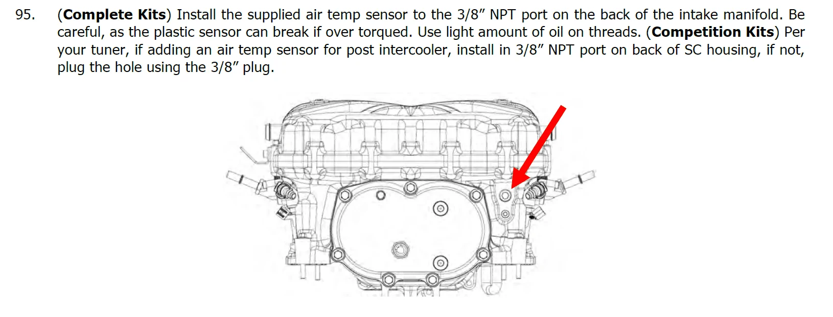

Does anyone have a picture of this? I'm having trouble finding any sensor on the Whipple 3.0L G5, it makes me wonder if it's not installed, but I'm not sure where to install the VMP sensor I have.
J17GT
Apr 21, 2019
838
739
IL
2017 Mustang GT PP
From the install manual. I'm curious how doable this is with the blower on the car? It's a pretty tight spot... I may need to swap mine out some day.
