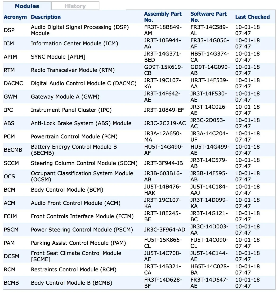

So, seeing as to how you are able to install the Digital Dash Cluster into the 2015-2017's, I've been curious about the modules in the 2018's (and since I have a new 2018 myself). So I went to the Ford ETIS site, registered and input my VIN. I then went to the "Vehicle Software" tab, and the returned results displayed a list all of the modules installed on my 2018 (attached image here).
Maybe this listing will help others too.
I'm posting this list here to see if the listed modules already installed into a 2018 S550 are what is needed to be present in order to swap in a Digital Dash Cluster into a 2018 - or if some of these already existing modules would also need to be replaced. I hope I'm stating that in the correct manner....
Notes:
My Vehicle: 2018 EB Premium w/PP
Trans: 10R80
Rear: Torsen 3.55
Interior Features:
No heated steering wheel
9-spkr Shaker system
SYNC 3 (no NAV)
No BLIS
No Magneride
Your input is appreciated!
