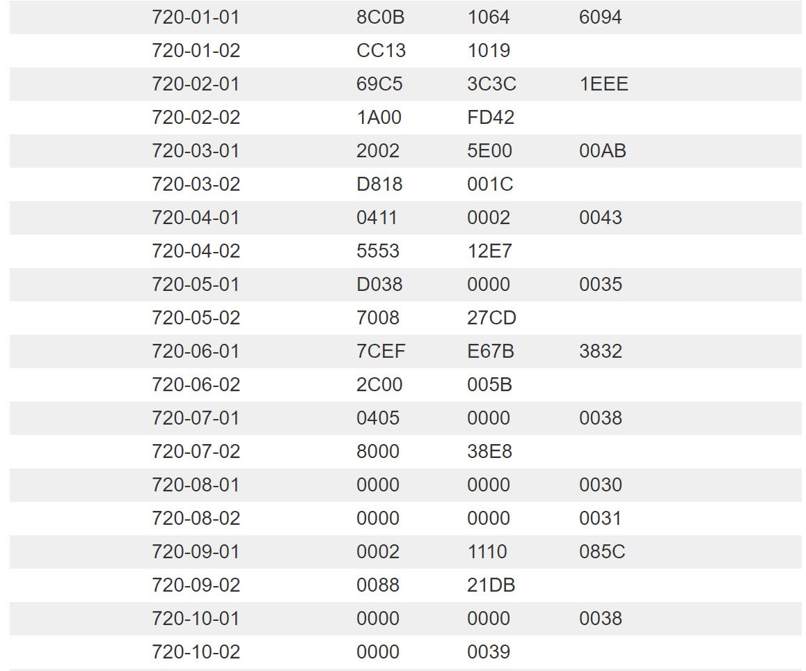

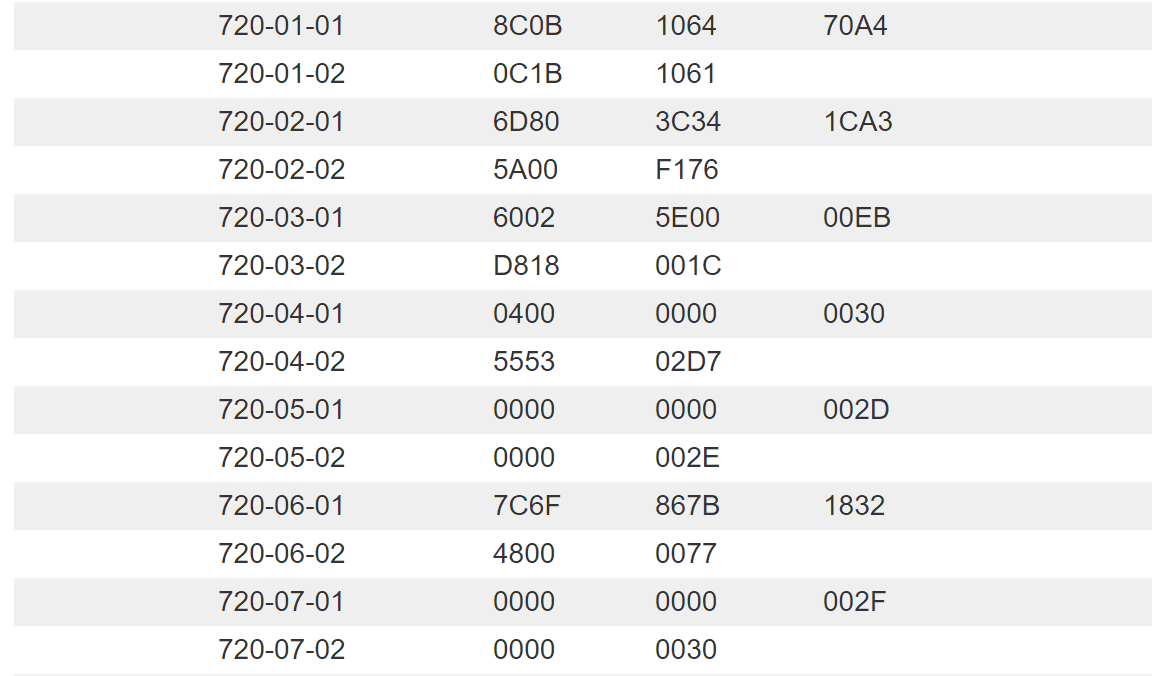

I think this is an issue that must me discussed in the As-built data thread. If we can find the as-built data of the IPC module of a 2018 model and compare it with a 2015-17, we might identify what needs to be changed.
Ask and you shall receive. Haha
Top is 2018 LCD
Bottom is 2017
The LCD seems to have a few extra lines of code.
Edit: Added a more direct comparison between 2 premium GT automatics. One 2017 and one 2018.

Nice find Zack!
There are not just a few extra lines on the IPC module of the 2018 with digital dash. You will notice that there are also differences in blocks 720-01-01 to 720-07-02 that are present to both models. It would be a good project to analyze those differences/additional blocks.
The thing is that although we can modify existing blocks, we cannot add extra blocks to a module using FORScan, maybe the dealer can? :shrug:
