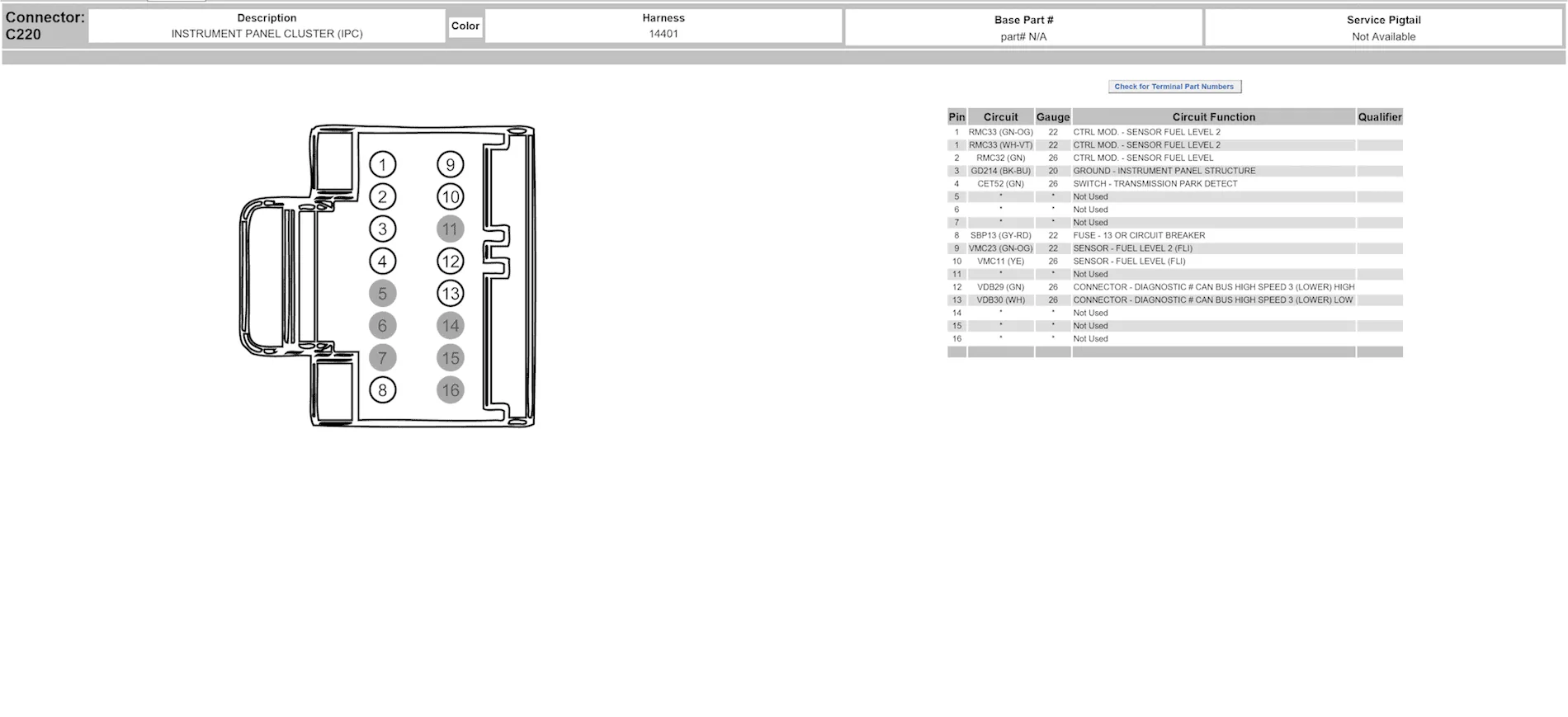

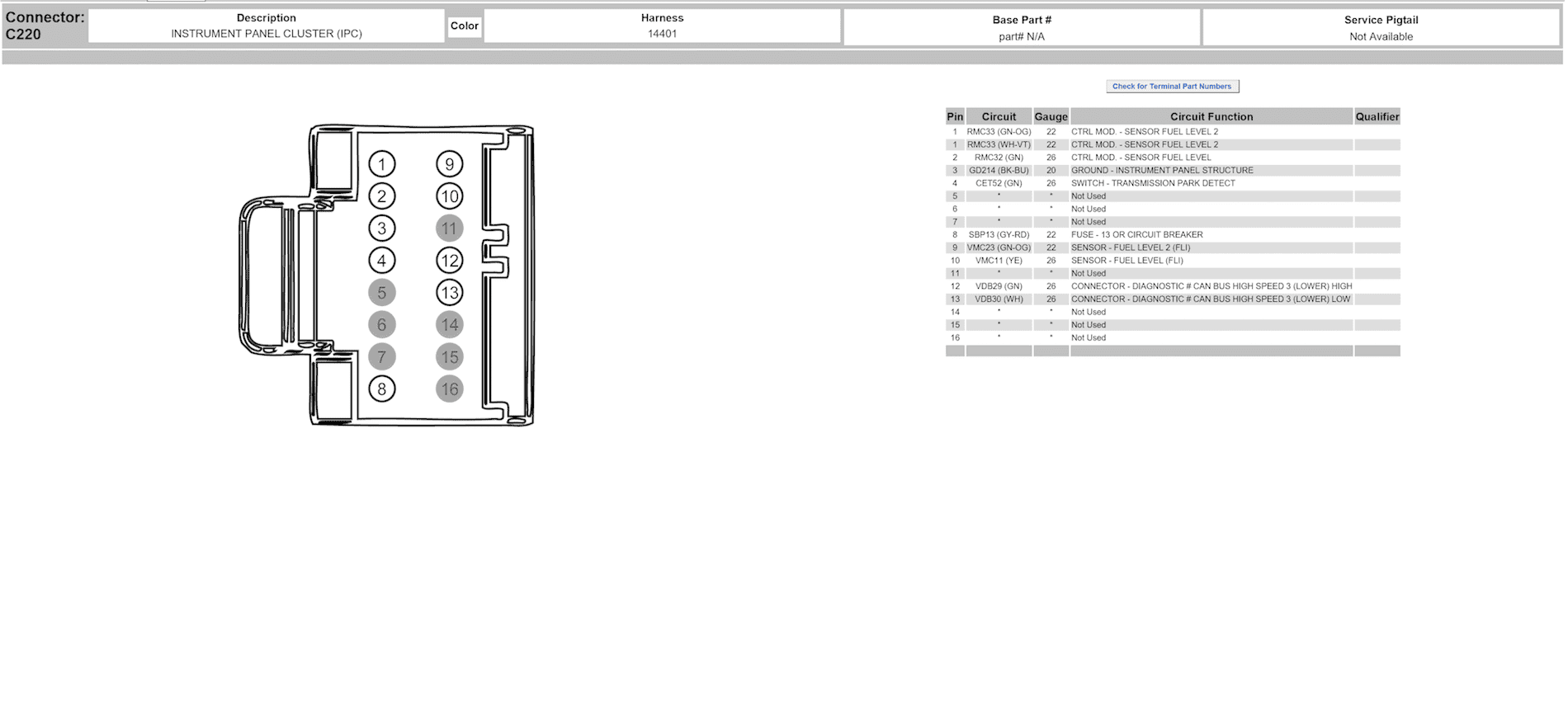

Well I went ahead and purchased a pass to the wiring diagrams. The IPC connector is exactly the same for the LCD cluster as the analog 2015-2017 cluster! (not surprised)
Top is 2017 and bottom is 2018 (no separate connector diagram for LCD which means the analog and LCD share the same connector pinout)

The only question now really is programming. How the LCD cluster will react to being in a 15-17 vehicle. My main concern is transmission gear indicators for automatics and the drive modes. The 18 of course has the 10 speed and slightly different drive modes. There is a chance that this will cause an issue but IMO I think the cluster will be a direct plug and play mod for 15-17s as well as base 18s.
As long as we can find a cheap and reliable means to program the odometer then we should be all set! Ordering directly from Ford will allow for odometer programming but used clusters will required other means.
