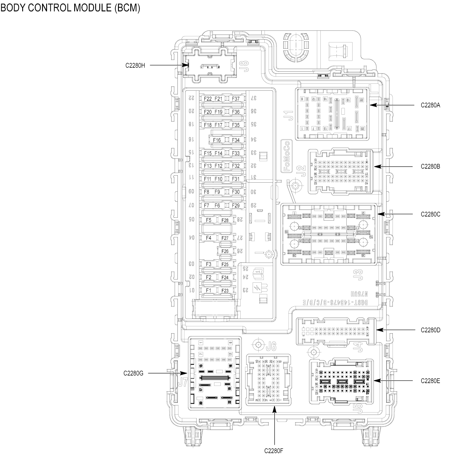

It really is not all that difficult. The diagrams let you know the exact pin number and even the wiring color. On every connector there will be physical markings on which pin is number one so you can orient yourself. From there it is simply adding pins and splicing wires where needed.
My suggestion is to use as little of the OEM harness has possible. That way you are not adding more work then required. Limit your additional wiring to just the required leads. Tap into the Gateway module for CAN, run the additional wires to the clockspring, and then just run a switched power and ground ensuring that you tap into F37. F37 is populated in 15-17 vehicles with a 15a fuse and the lead you can tap into is pin 16 on C2280A on the body control module.

[MENTION=20657]db252[/MENTION]
Here is the C2280A connector view.

Thank you very much. This is all helpful and confusing to me at the same time. I'm sure I'll just make a harness and return the entire dash harness that I ordered.
