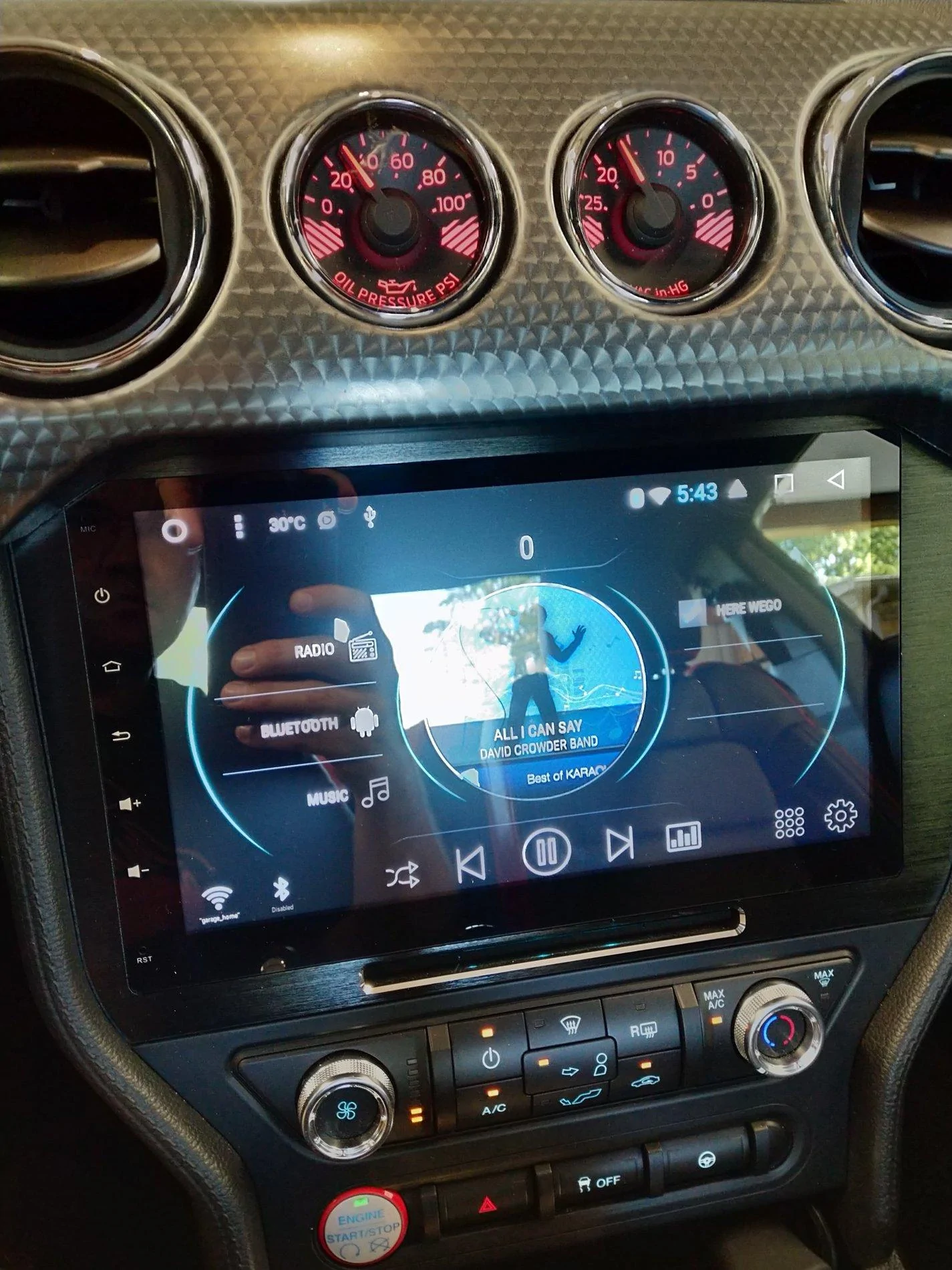

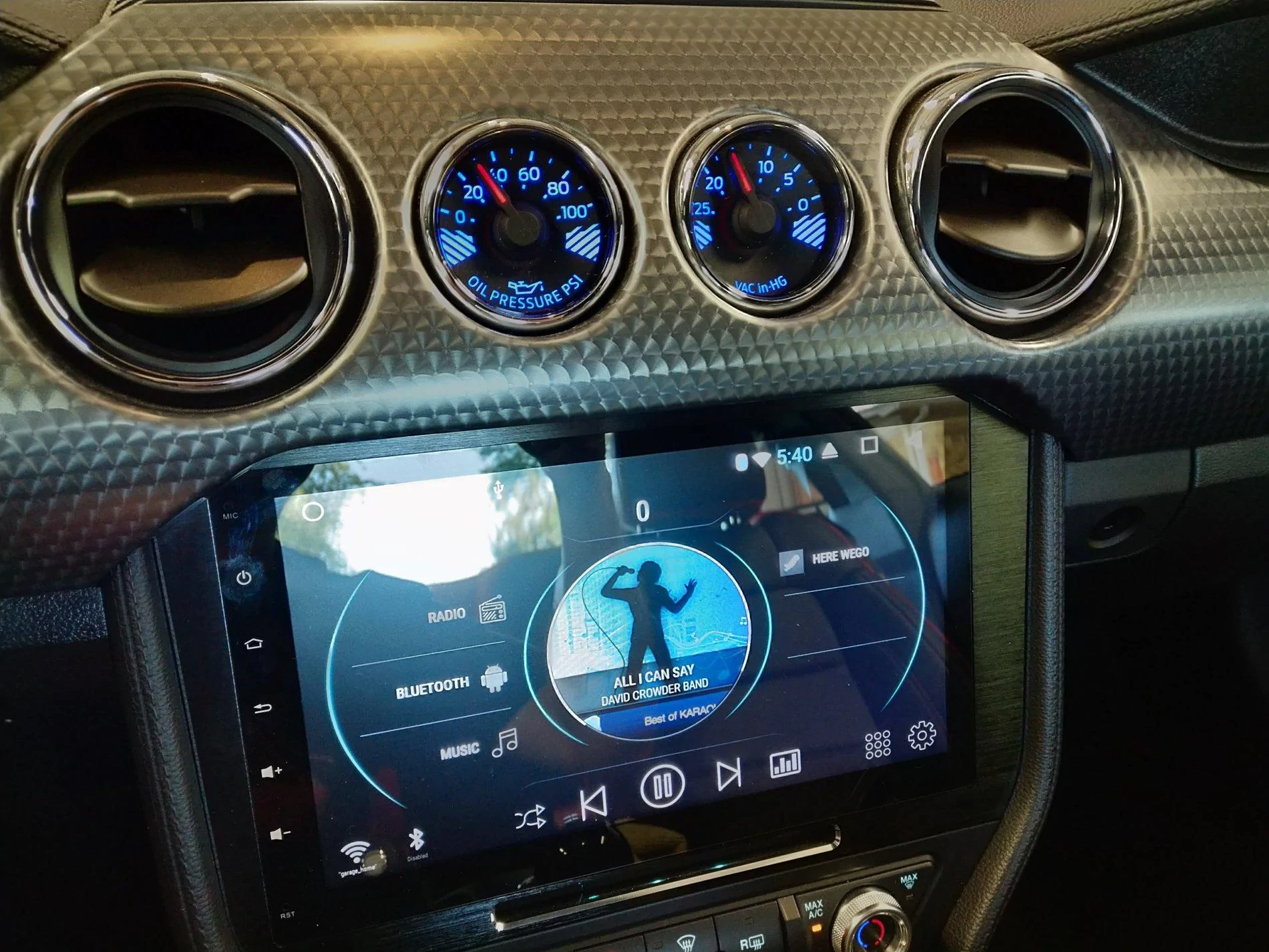

I just did this install on my base 17 gt performance pack car. Using the base as built info provided I think everything is working. This also enabled the center vac and oil pressure gauges to change color with the primary color. I also have a 10" Android unit and the audio controls still work.
The only glitch I've been able to find is the new back/return button on the wheel will send a repeated volume down signal to the headunit and freeze out the radio buttons for a while.

I just did this install on my base 17 gt performance pack car. This also enabled the center vac and oil pressure gauges to change color with the primary color.
Whoa. That means the base has the same gauges as the premium, at least for MY17.
When the GT350 gauges didn't have MyColor when installed in a Premium PP the explanation was the gauges didn't have color LEDs. I said at the time that it didn't makes a lot of sense for Ford to do anything to the PP gauges to make them GT350 but to slap a oil temp face on the right gauge and send temp numbers instead of vacuum numbers to it.
If Ford doesn't even make a non-color version for non Premiums, why have different hardware for the tiny number of GT350s.
I'm thinking the GT350 gauges could do MyColor in Premium if someone figures out what other box decides to send MyColor info along with the gauge values over the Canbus and gives it a slap upside the head.

I think the MyColor info is being sent by the IPC, that’s why it started to work on randy_tho‘s car when he put in the premium (lcd) cluster. I also believe that all the signals for the different gauges are already present on the can bus. Therefore the gt350 gauges show temp values while in the same car the GT gauges show vac.
You might be right that the GT350 gauges do have color leds but I fear the firmware or the chip inside the gauges just ignores the color change info.

I suspect the GT350 gauges don’t even have rgb LEDs. I have them in my premium GT and they do not change color. The programming in the gauges just reads can info sent from the IPC. It is not a can networked module even though it’s a connected device. In non GT350s the oil temp is estimated.
