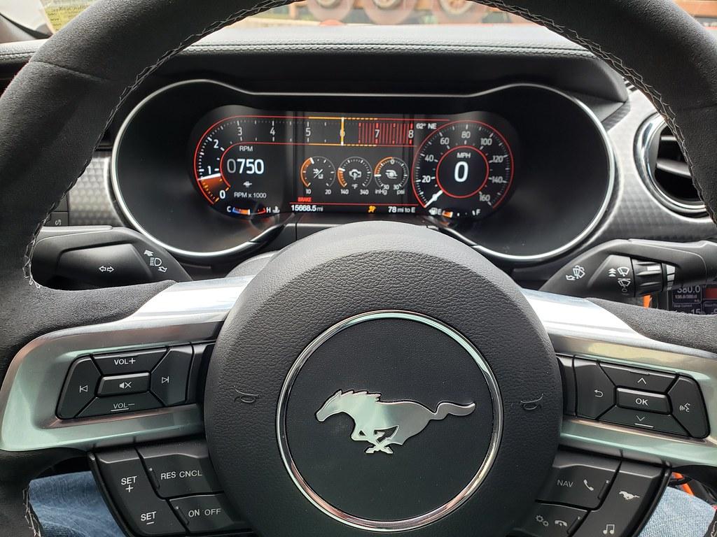

Installed my digital dash today.
smooth sailing, no issues.
thanks Sam!

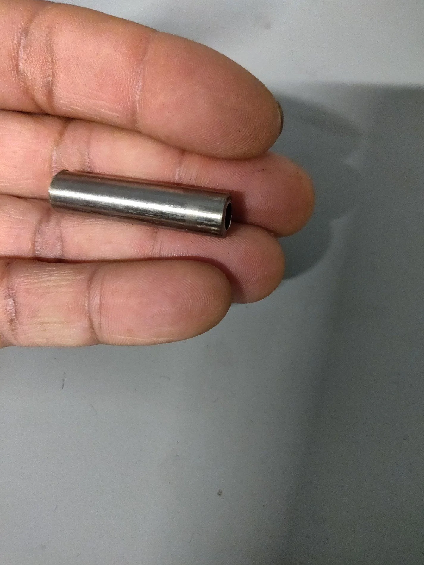

Does anybody else feel their cluster lens (clear plastic) is quite loose? I think this might be causing some rattles in my car. I have 3 screws holding the cluster down and I used a bolt/nut combination on the right side to keep tight. Thinking of maybe running without the lens or some silicon to hold the lens down.
dawolf
Mar 10, 2016
43
Chicago
Ruby Red mustang GT
You need some type of post
You need a couple of plastic or metal post/ tubing behind the top cluster screw holes. Cut to the correct length they will prop the cluster up to the proper position. That position is butted against the four small rubber bumpers on the back of the cluster bevel. You would have no rattles afterwards.
