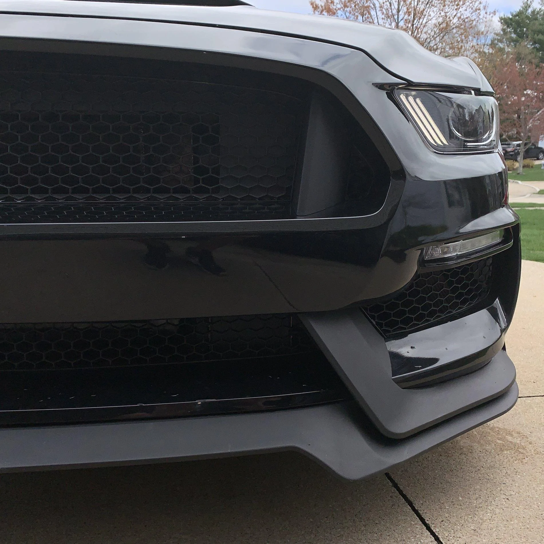

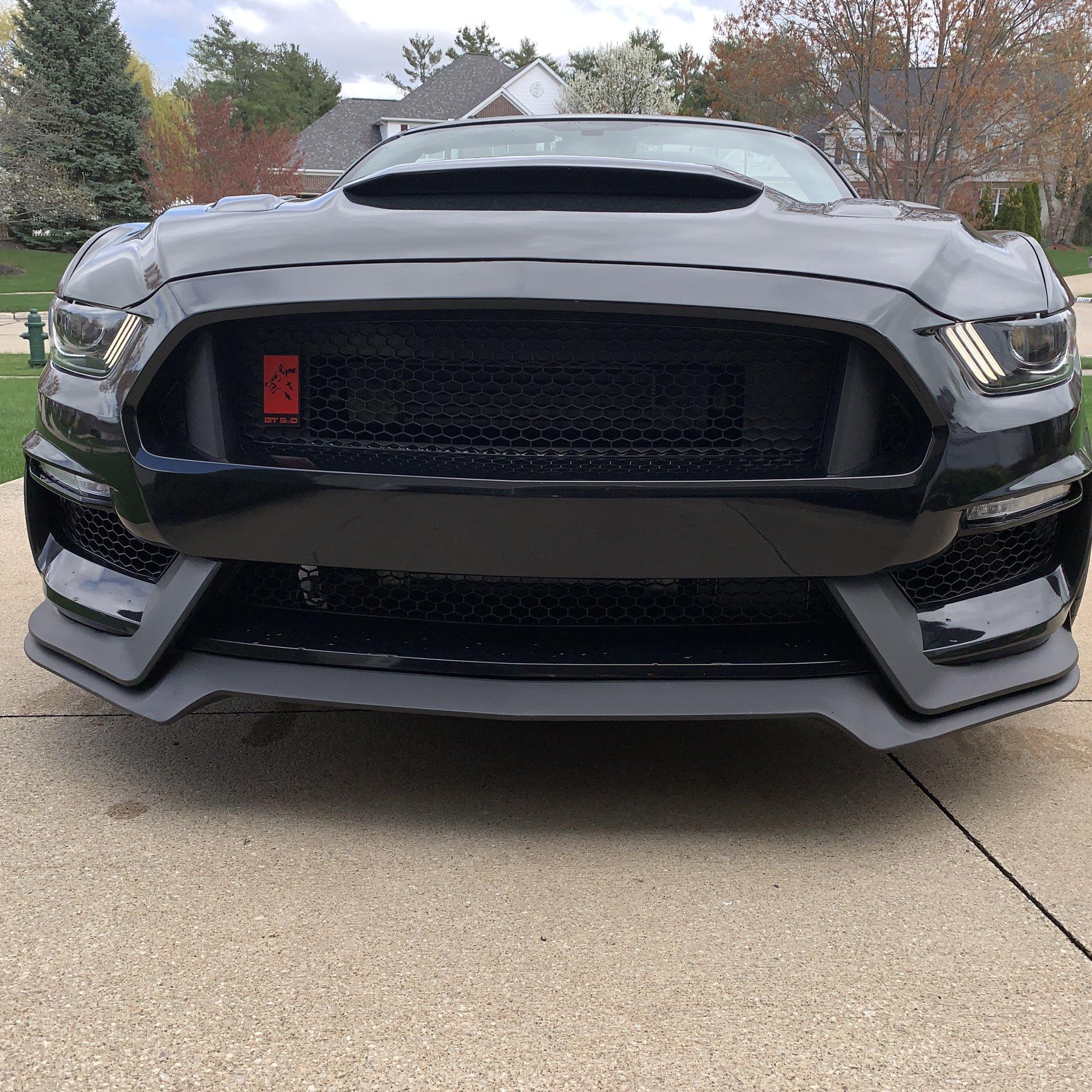

And it will work with the GT350 lcon Motorsports front bumper.
