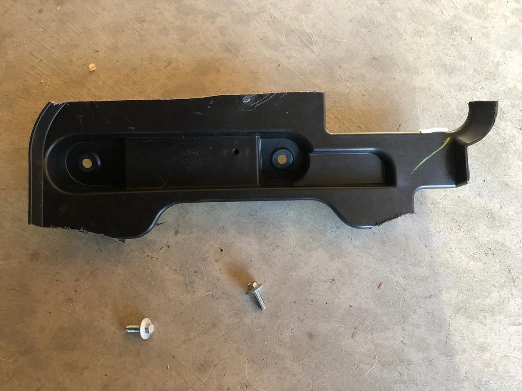

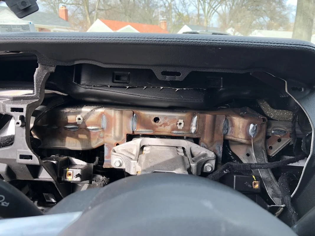

Remove plastic backing:
-Remove two screws
-Cut plastic backplate out. Refer to pictures.
Add foam padding on dashboard brace to keep the instrument cluster from rattling. I also recommend adding a piece of felt or foam on the other side and top.
Just my two cents on my experience with this particular step as I was trying to be as undestructive as possible.
The bottom two legs of this piece can be separated, with a knife, from the main dash as they are only glued on. The top (chopped off in picture) is also only glued to the top shroud by four spots of glue which is easily separated with an angled pry tool. This allows the piece to be removed whole. This does however mean that the new cluster will have no bolt holes. So if you go this way, these will need to be cut off still and will need to epoxy these back in.
Just thought I'd let people know it's possible to remove with near zero risk to any surrounding hvac.
I'm not understanding this. Maybe I'm the only one. Can you elaborate?
Top of trim piece where you can see 4 spots of glue that held it to the underneath of the cluster shroud.
Excuse the child drawing but in profile this is what I was trying to say. Insert a pry tool at the top of the piece. This will free the top.
For the bottom, take a knife in a right to left or left to right direction to separate the piece.
