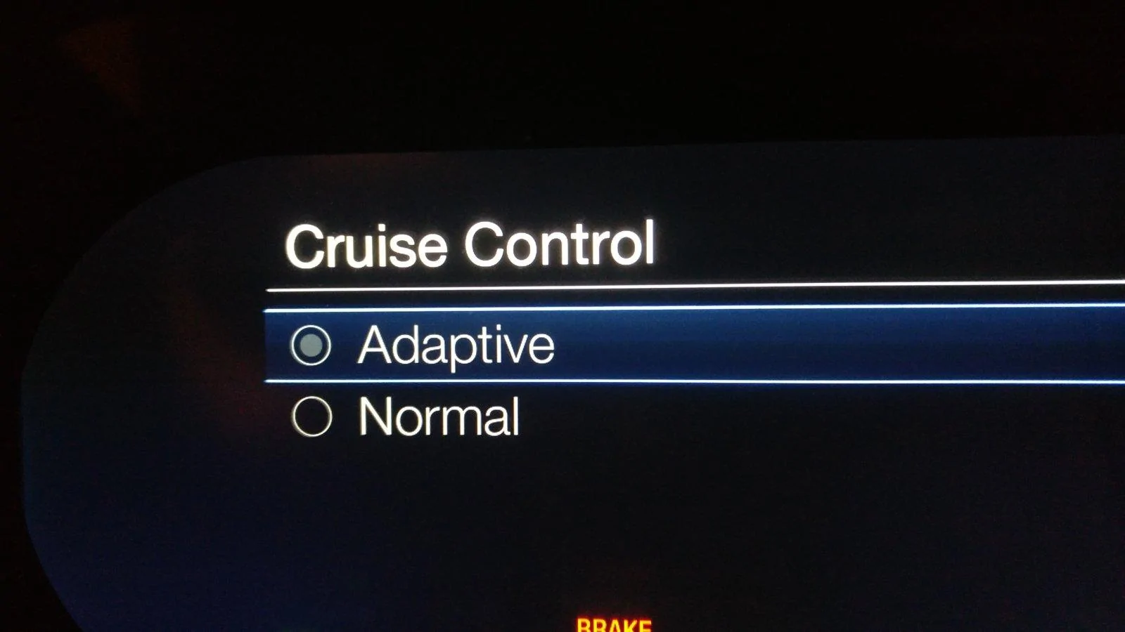

I have Adaptive Cruise Control and I have ordered my parts as well. As soon as they come in, I am going to upgrade the car. Let me know if you figure out the Adaptive Cruise Control issue. When you say the option is grayed out, I am assuming in the FSCAN tool when you attempt to program the IPC? I shall update you once I complete my install :)
Below are the SCCM and Switch which I have ordered. Listing them below so we can confirm that we are using the same switches:
Left Lower Steering Wheel Switch: JR3Z-9C888-FA
Steering Column Housing Assembly: JR3Z-3F791-AA
It's greyed out in the IPC itself under "driver assist"/"cruise control". The forward collision detection still works, it's something between the SCCM and the CCM that's not programed/configured correctly. As far as the part numbers, after some looking at several websites, they list part (FR3Z-9C888-DA). I have switch part number JR3T-9E740-FAW. Maybe that's the problem?

You need to replace all FOUR steering wheel switches for any 2015-2017 with adaptive cruise control. Go back to the first page and look at the parts required list. I have several people with working adaptive cruise on cars that have purchased plug n' play clusters from me.
You need the -FA switch to get ACC to function.
I actually didn't find this page until I got my kit from hellhorseperformance.com. I didn't know this was a thing until they posted it on facebook. They sent me 4 switches, but only three actually fit. I received 2 upper right switches in the kit. Figured that was normal so I only replaced 3. I've contacted them to find out why and now just waiting to see what they say. Might explain why things aren't working. Thanks for the help and i'll see if this fixes it.
