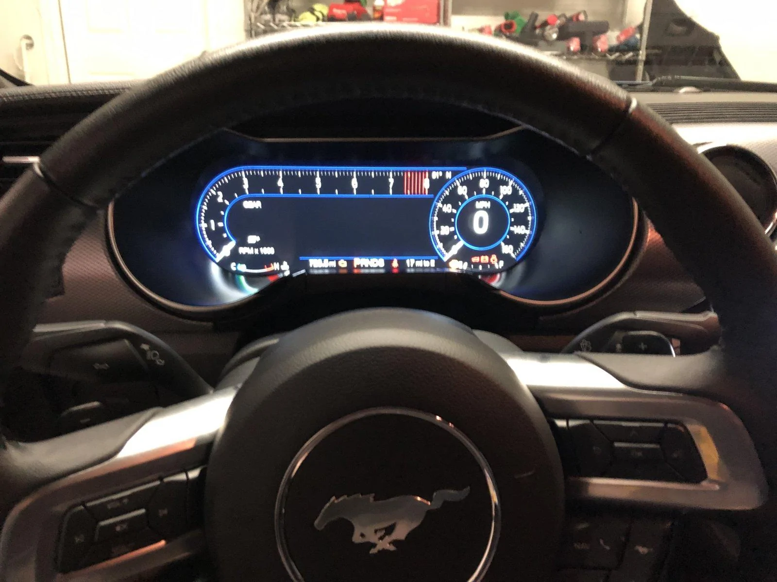

I just performed my install pretty easy install little over an hour thanks breeves cutting behind the dash was the nerve wrecking part but it came out great plug and play

Just watch the videos and take your time. I watched the videos thru my phone in the car and followed step by step. The hardest part was removing the long center dash piece. The guy in the video made it look easy but he already had it partially disassembled. Just take your time and use the plastic interior panel removal tools so you don’t break any plastic clips.

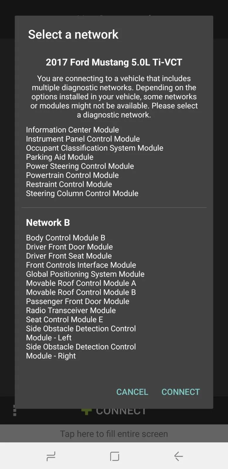

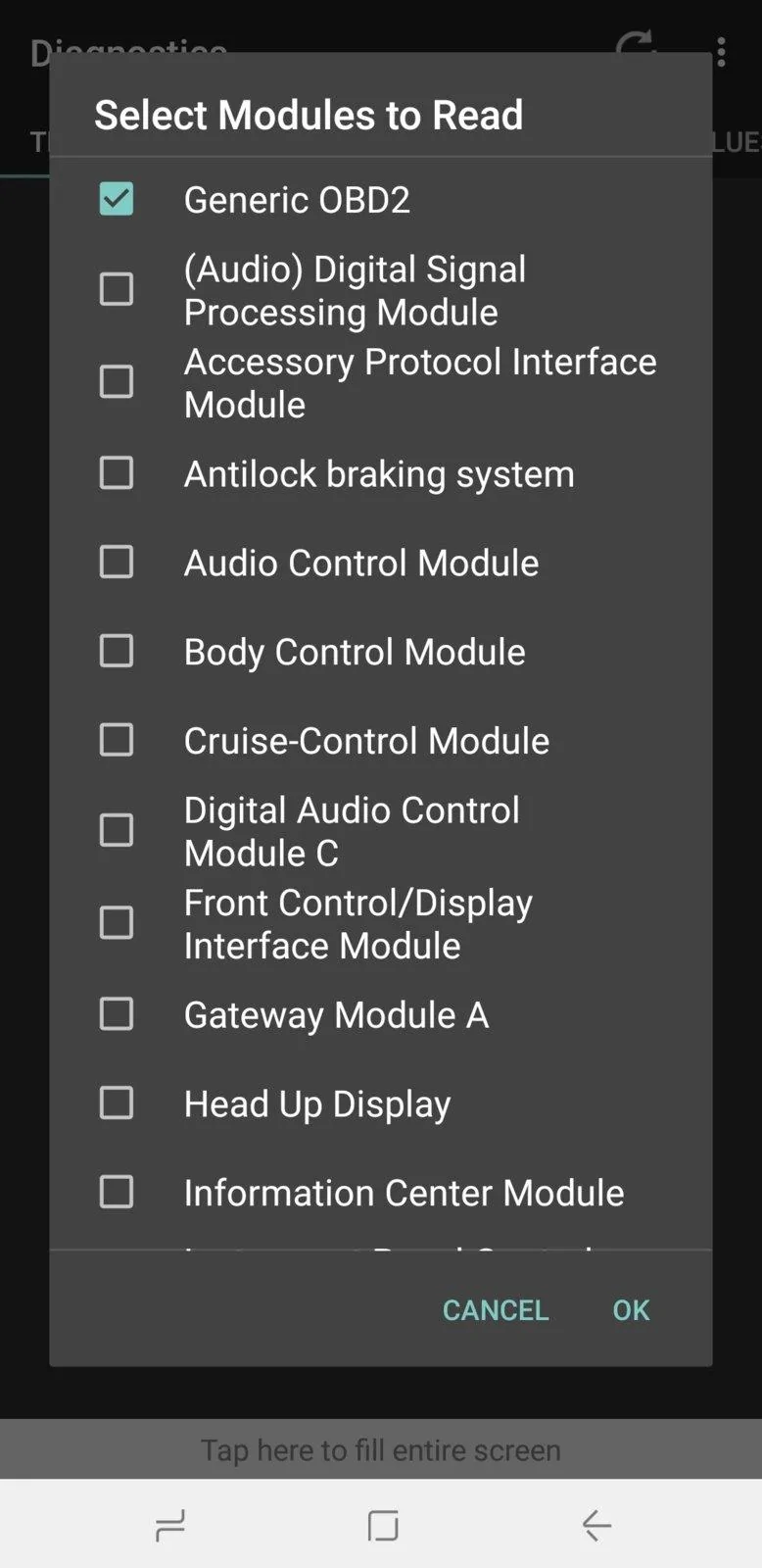

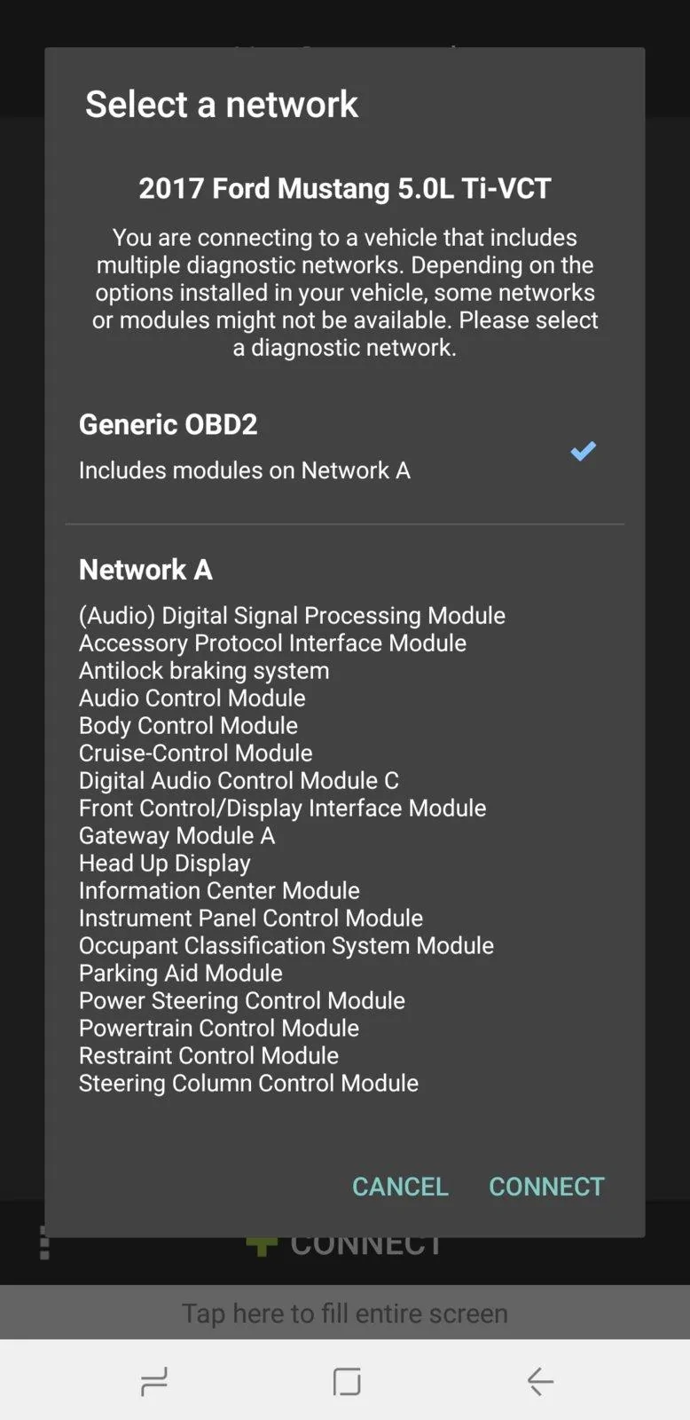

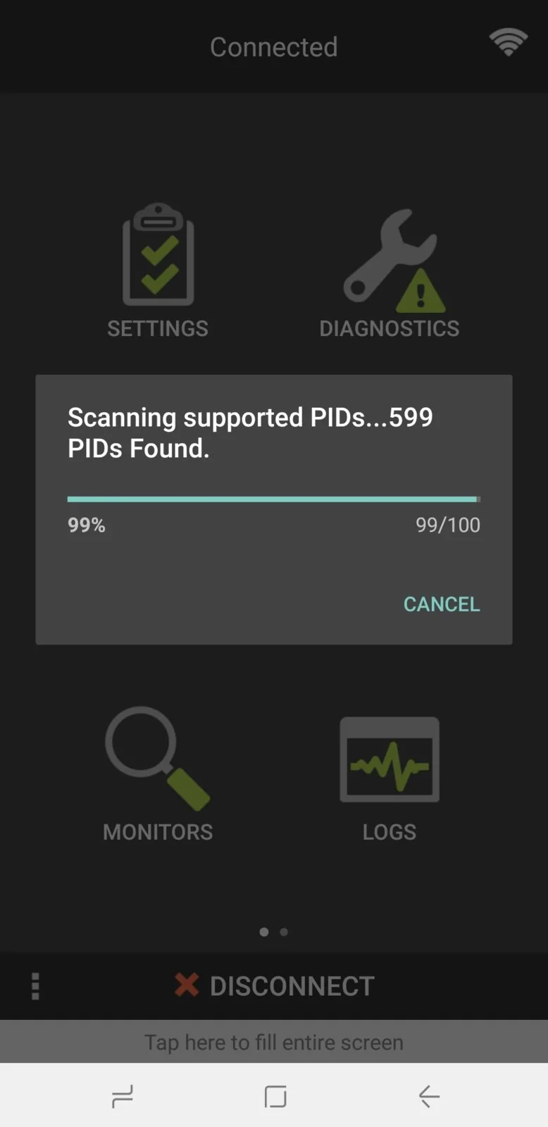

OBDLink MX + (Plus) Warning !!! ScanTool has released a new OBLink MX called the Plus. It is NOT compatible with ForScan yet. However, it has some really cool features for Android and iOS. For example, you can access all the modules via your OBDLink app on the phone. See screenshots below... Not sure if you can program them via the App BUT you can read their settings and run diagnostics on them.
Because it is selling on Amazon and Amazon is showing it as the "new model available," I wanted to let everyone know before they ordered to use it with ForScan and discovered that they cannot see all the MS and HS2/3 buses.

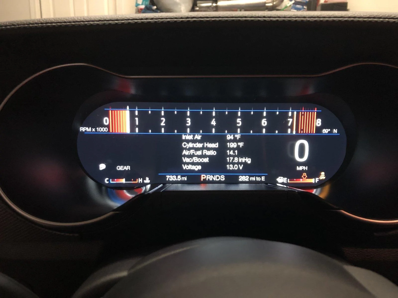

Breeves,
On your Google doc spreadsheet, for the IPC build.
You have your own build starting on Line 81
What build is that you have starting on Line 104, for which model car?
Have you recently updated any new codes? Thanks!

Thats just where I put code that I'm messing around with. Nothing important. Just start with the baseline and adjust from there. Nothing has been changed.

The problem is I did the base build and I lost Line Lock , Launch Control and Hill assist ? :(.
I then tried entering your build starting on line 84 and got a error msg on the first line it wouldn’t let me use/ save that.
Any help would be appreciated As I really miss Line Lock and Hill assist :(

I may need to revisit that base code..I've had several people say they've had issues recently but I never have any problems when I program them. Just did one today. I can provide programming for you for a small fee that will bring that stuff back. Let me know if you're interested.
