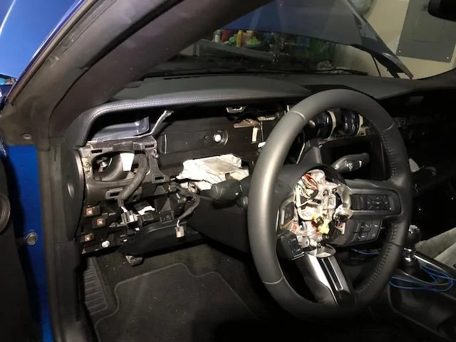

Here’s a picture of behind of my 2018.
I unfortunately don’t have the part # off the sticker of the dash itself but if I go back in for any reason I will let you know. I do have the multiple pages of gauges and the oil temperature gauge however if that helps.
So did you have to cut anything out on yours?

Granted not the greatest pic but it looks identical. Is the plastic set further back on the 18s?

On the 18's I'm pretty sure you wouldn't have to replace the SCCM since its already spec'd to your vehicle. I suspect you would only have to purchase the cluster, and the appropriate steering wheel switches to navigate the digital menus and then the OBD Link. I know on my 17 I had to buy 3 switches, as it relocated the switches for track selection from right to left and also the lower right one was replaced as it adds the settings and Pony button that are specific for the digital cluster.

I just bought the cluster, surround, and the 2 buttons for the right side of the steering wheel. Nothing else necessary or different from the rest of the write up.

In other news, received the surround trim today thanks to CXMoney. Looking forward to completing the install tonight. Never was able to get an answer on what’s different behind the 2018 dash so that it doesn’t require hacking up the plastic. What did everyone use? Dremel? Sawzall?
