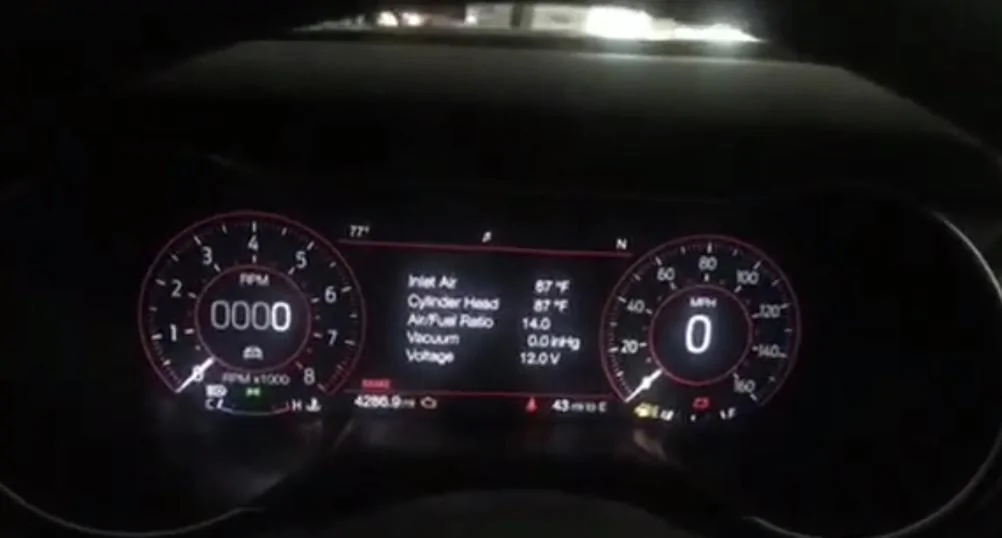

Welcome to the club. You don’t happen to have a picture of behind the cluster do you? I’m curious as to how it’s done on the 18s instead of having to cut out the plastic in the other years. I just got my GT350 steering wheel in today so I’m going to be diving back in. Also bought the needed trim piece off of CXMoney, so should have that next week for final completion.Got mine installed and finished up on my '18 today! Thank you [MENTION=29356]breeves002[/MENTION] so much for organizing this all and helping us all!
BTW with the '18s I did not have to trim any of the piece behind the cluster. Also for the As-Built data it ended up being easier for me to just find a similar VIN with the digital gauge cluster and use the https://www.motorcraftservice.com/AsBuilt website and just use all of that As-Built data. Everything is working perfectly and no error lights.
