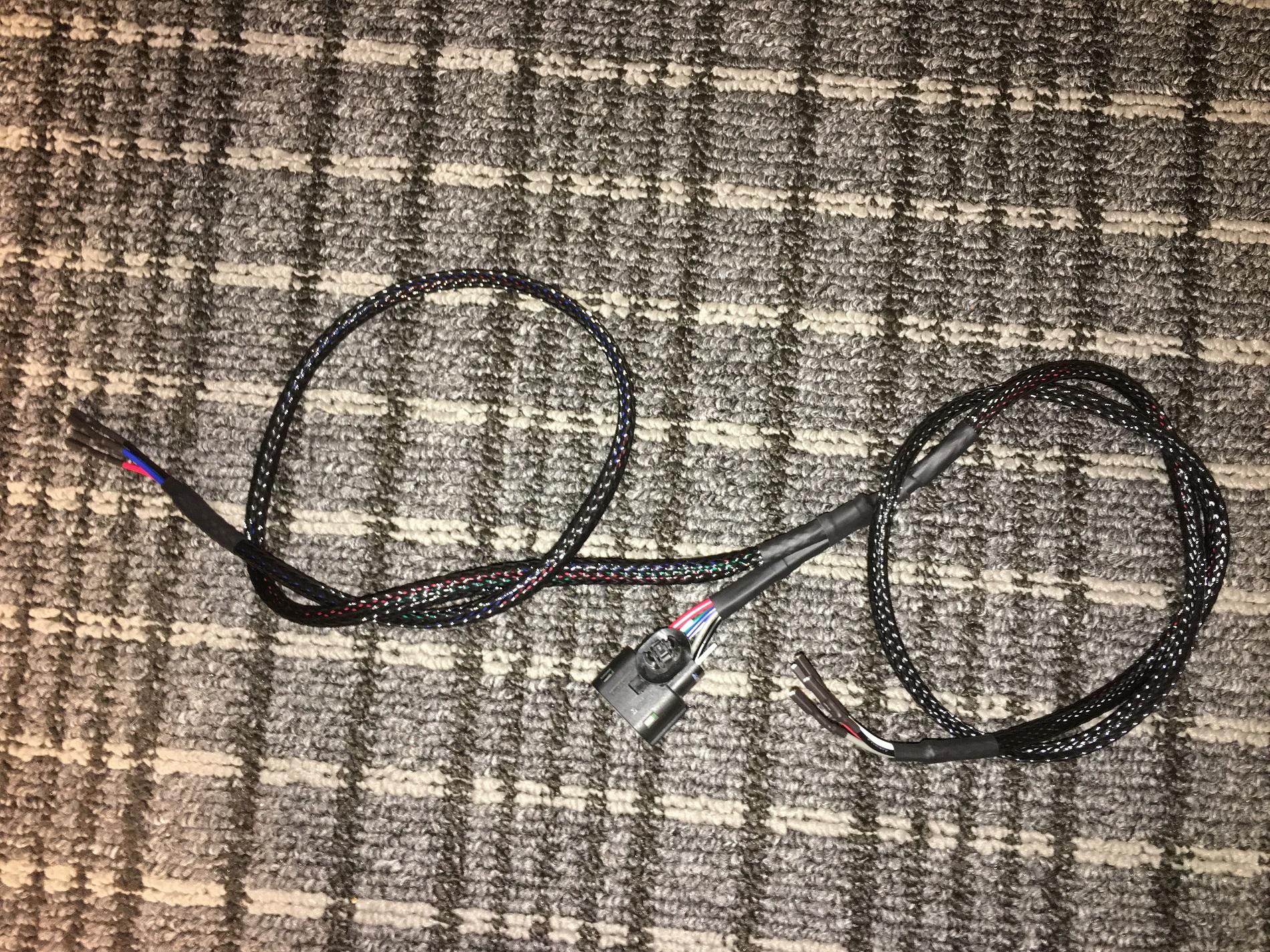

There is interest, I'd really like to do this mod, and I'd buy a harness from you if you are willing to make one. I have a base 2018 GT with 301A. Guess I should go ahead and order the mufflers. Pretty awesome that you got it to work.If there was interest, I can figure out how much it cost me to build the harness & make some up for others. With this harness, and some vary basic Forscan knowledge, it is a bolt in - plug & play modification.

Ford was not able to get me a part number for the harness from this 12-pin connector to the 2x 4-pin connectors on the exhaust valves. As my background is in electronics, and I wire race cars all the time, I sourced the connector parts, and built my own harness. The attached picture does not have the connectors for the valves yet.

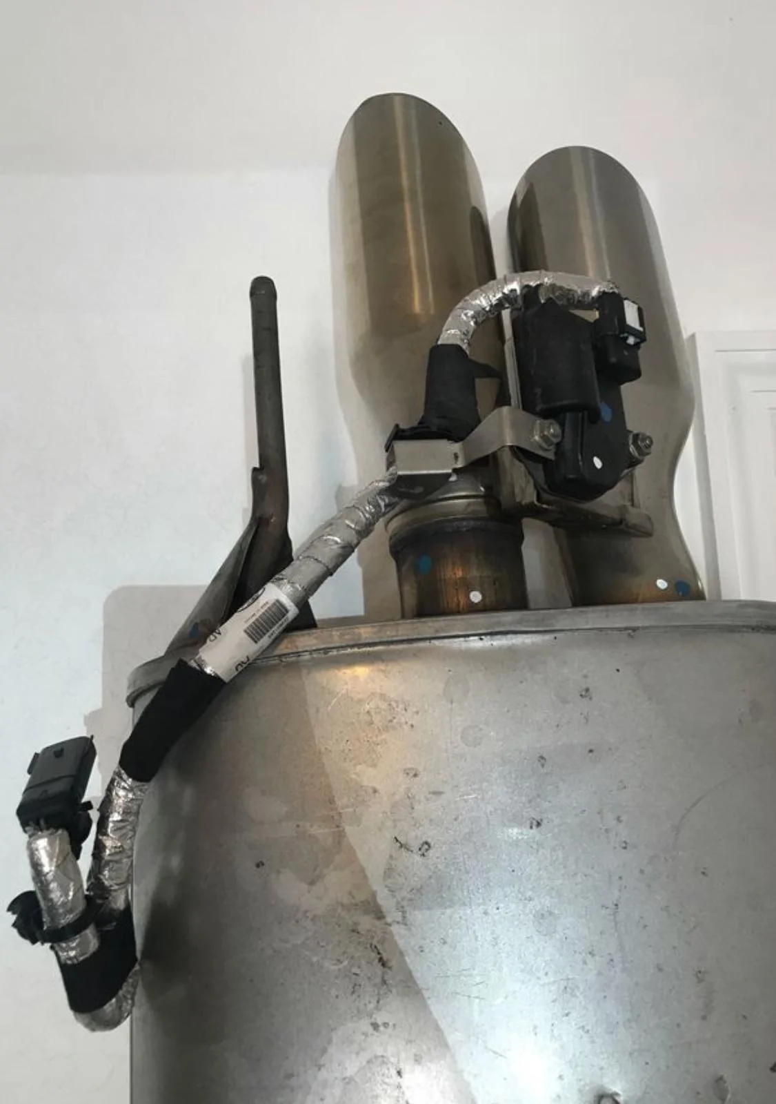

JR
That sure looks like it. What's the part number on that?Anyone know if this is the harness we need attached to the solenoid?
