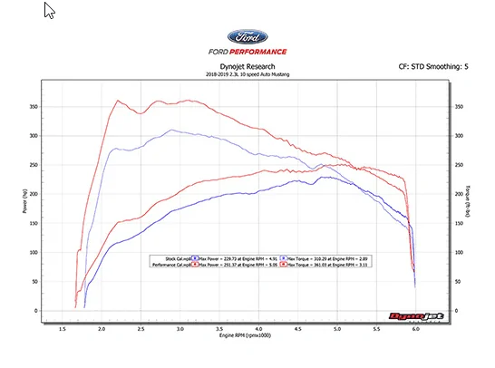

I checked with them, they said it uses the standard air box with a high flow filter. They told me the factory design is already efficient and doesn't need to be changed. I wonder if this is why people say not to waste money on the cold air intake as there are no gains present for the Ecoboost. I had read that when I was thinking of doing some mods.
They also mentioned the following since I couldn't read their dyno graph.
The stock tune made 229 peak HP, 310 peak TQ. Our calibration made 251 peak HP, 361 peak TQ.

That seems low.....VERY low. 250whp is what we should be getting stock. The site says this is on 93 octane, but this looks like 87.

I agree with you and had the exact same thoughts. The only way I am going to know is if I take it to a dyno after the tune which I am considering.
My thought is we are going to lose 10-15% from the crank to the wheels. If we start at 310 we should be at 260-265 stock. If we assume the tune gives an additional 10% we would be at 285-290 whp. I won’t know until I get numbers myself and if I do I will share with everyone. The only thing is I am likely not going to take it to a dyno pre tune so we will need someone else’s numbers.

Sounds good. I've seen enough baseline graphs to know that we're good for around 250-260whp. 290 sounds about right for a tune.

I wonder if this was using a Mustang dyno? I think the Mustangs have a reputation for dishing out low numbers.

I would hope so considering they are Ford Performance and all. That would be super embarrassing otherwise.

FRPP Dyno was DYNOJET, it says on the graph they posted. All that matters is what they achieved relative to the dyno results from the factory tune used as a baseline. Same car, same dyno, same day (atmospheric conditions), record baseline factory tune numbers, then record FRPP tune numbers. The plus or minus differences over stock, relative to that car, on that dyno, on that day, with all controllable variables controlled for as much as possible, is all that matters.
COBBs posted maps notes also use "avg.percentage of increase" over factory tune. They state % increase NOT hp/torque numbers.
As reference, here's a link to COBB map notes for 2018 Mustang, graphs are shown, but hp/torque numbers are not stated, only percentage of increase which can be expected. Take note of the factory tune baseline numbers shown on graphs, very similar to what FRPP shows for stock on their Dynojet graphs. But again, not important.
https://cobbtuning.atlassian.net/wiki/spaces/PRS/pages/728793097/Ford+Mustang+EcoBoost+18+Map+Notes

My thoughts exactly. That MUST be with 87 octane.
It would be an INSANE amount of loss. On 93 octane we should be making closer to 260 WHP.
That is why I WILL NEVER use regular gas on this car lol...

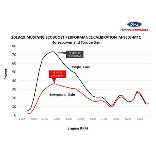

They changed the graph and data on the website. See below.
  • Horsepower and torque gains throughout the powerband
    • 35 HP peak gain at 2,900 RPM
    • 76 Lb.Ft. Torque peak gain at 2,600 RPM
