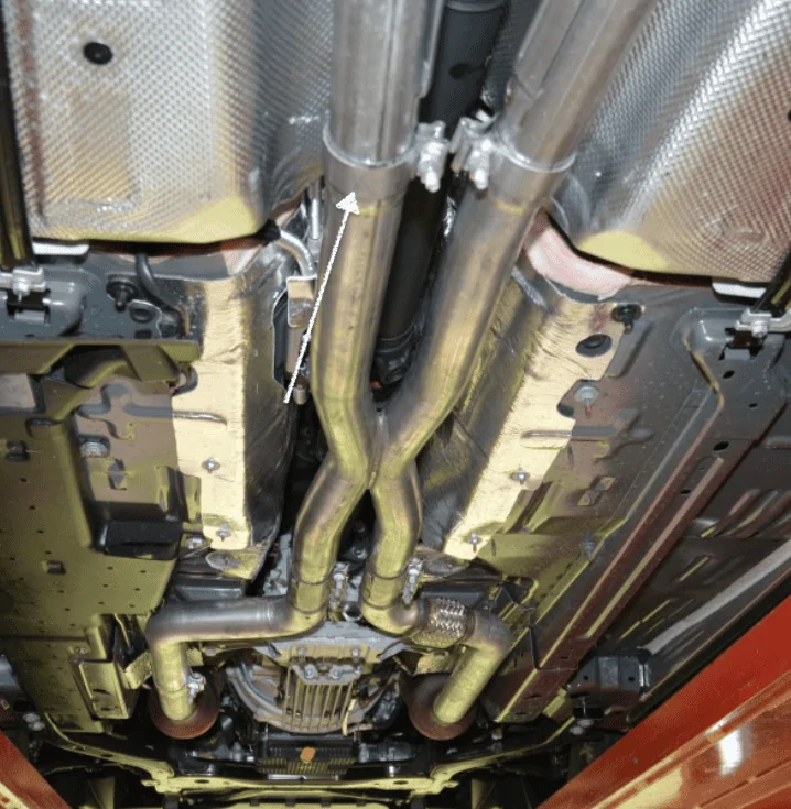

OK, tips look good and centered, these are the clamps. Loosen it some and rotate the muffler, use it cause you have more leverage .
Don't worry about the hanger, it will go along for the ride.
Be mindful of the plug on the AE, pass side is a little close to the body. Onlt mention this, to be aware, I do not see a problem because the muffle is just rotating some.

Thanks for the picture that does help to see what your talking about. When I bought the car, it already came with the H pipe.
I assume to loosen the clamp and adjust muffler that way the muffler can look level correct? Then loosen other side and address that muffler?
Would you say I need to disconnect AE motor to do this adjustment?

Ok Salty,
I like the handle either way.
*1 yes
*2 not necessary, you will be working right there. Keep the clamp loose enough to drag. Meaning hold its position, as it is being rotated, and checked
Removing the plug NO. The plug most times gets damaged with the H pipe install, and that is the pass side.
You are not removing the pipe from the H pipe, just rotating it.
That help ?

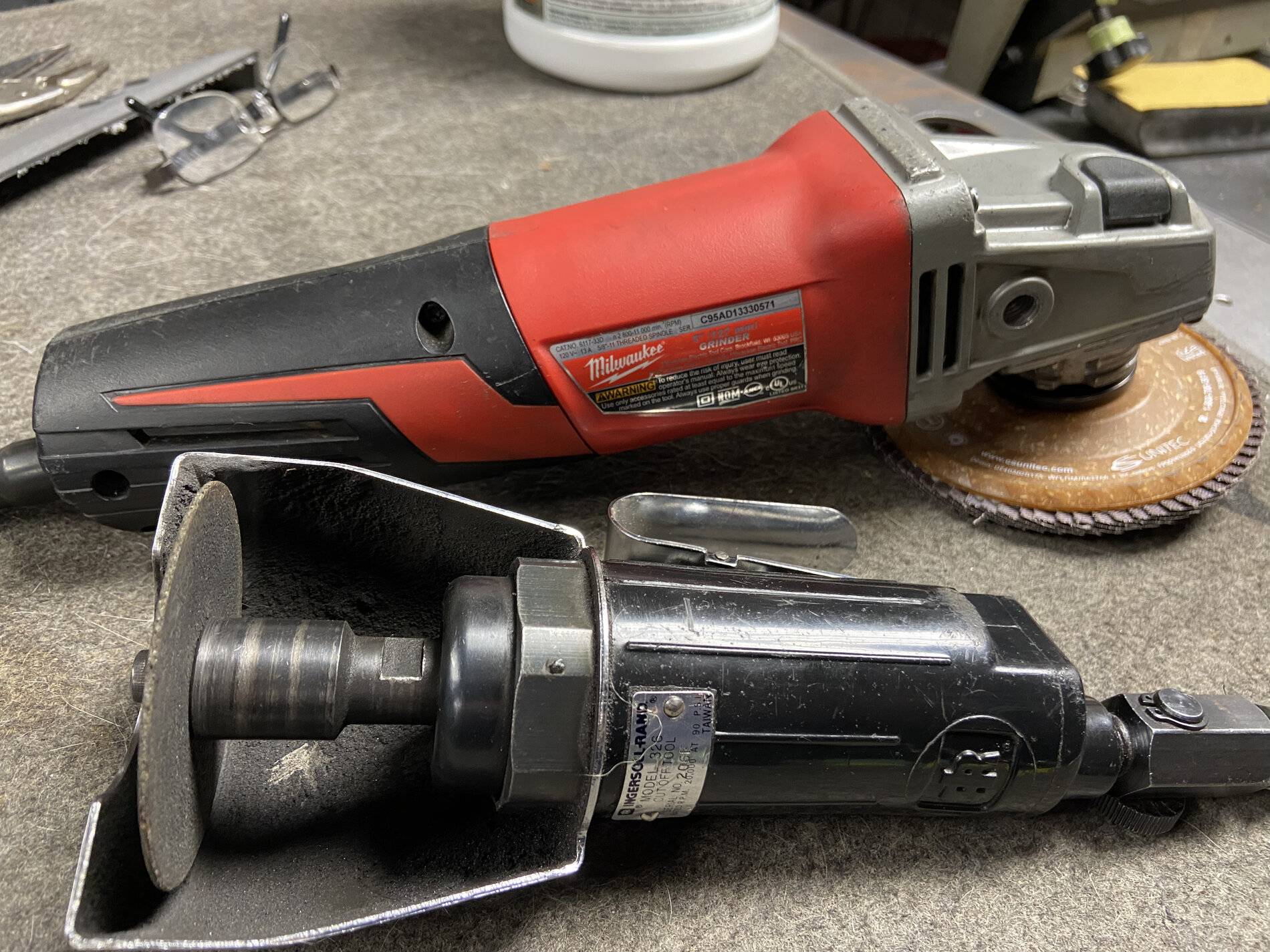

"gonna loose a tip"
There is a gap in the tip that runs fore & aft of the tip. Between, middle of the ears for the screw.
This is common and a common problem also.
First, when tight, the gap is closed and tip loose?
The gap needs to be wider, so when the screw is tight some gap remains. Clamping the two.
Secondary, if there is a gap when screw is tight and the tip is loose.
The slot is to short, not allowing the screw to draw in the tip end, clamping the tip to the OEM tip.
Cut it longer, it could need to be widen some also.
Work one tip, get it figured out then do the other 3,
I would suggest the usage of the Dremel tool here.
But if you have one of these, grinder with a cutoff disk, will speed things up. Making lite passes, when cutting, ease into it. Do not want the tool to grab the tip and launch it across the room.

"gonna loose a tip"
