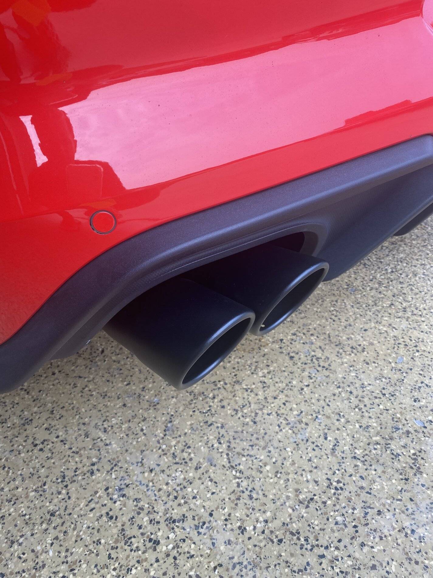

Had it welded last night by a buddy. Looks great, so much better than the thin stock tips. I painted the weld marks that came through the inside of the exhaust, just gave it a touch of satin black. Im sure the carbon will cover it soon anyways. All in I spent $68 on 4 tips, $20 on new saw zaw blades & $50 for the welding. Total $138

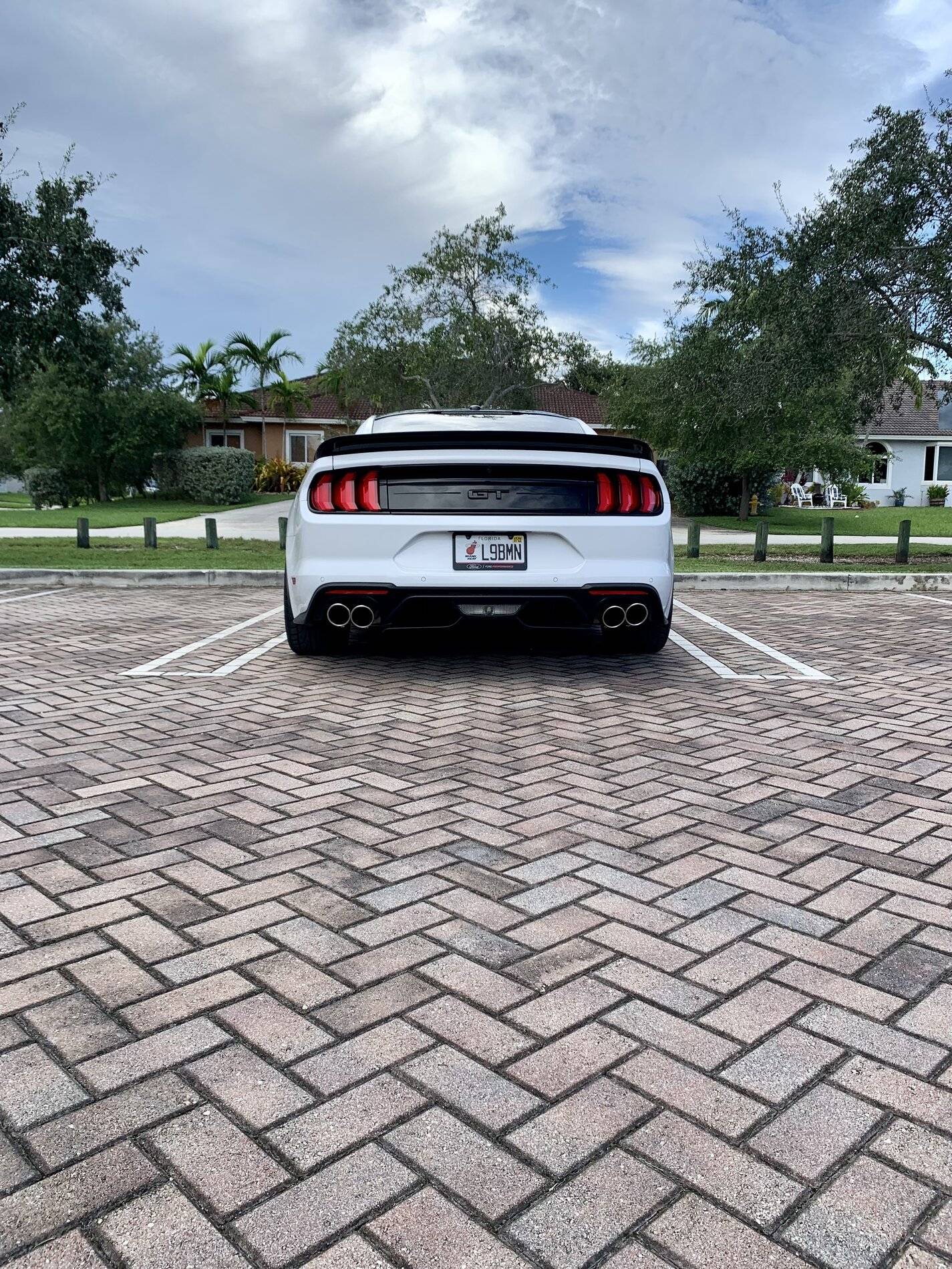

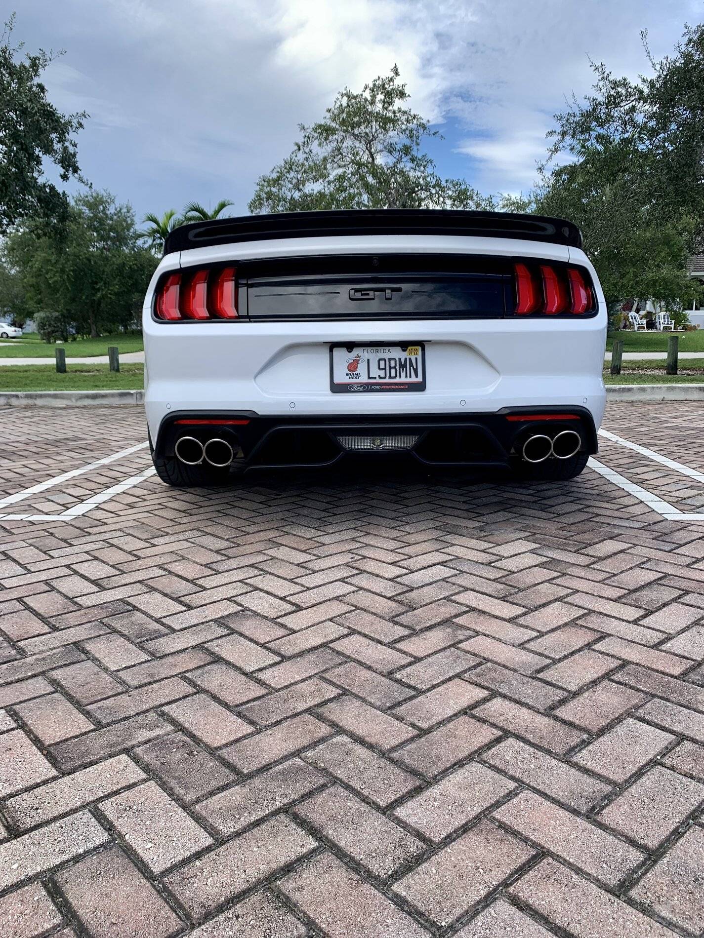

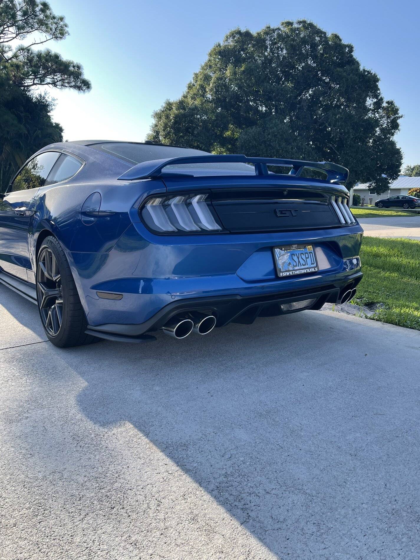

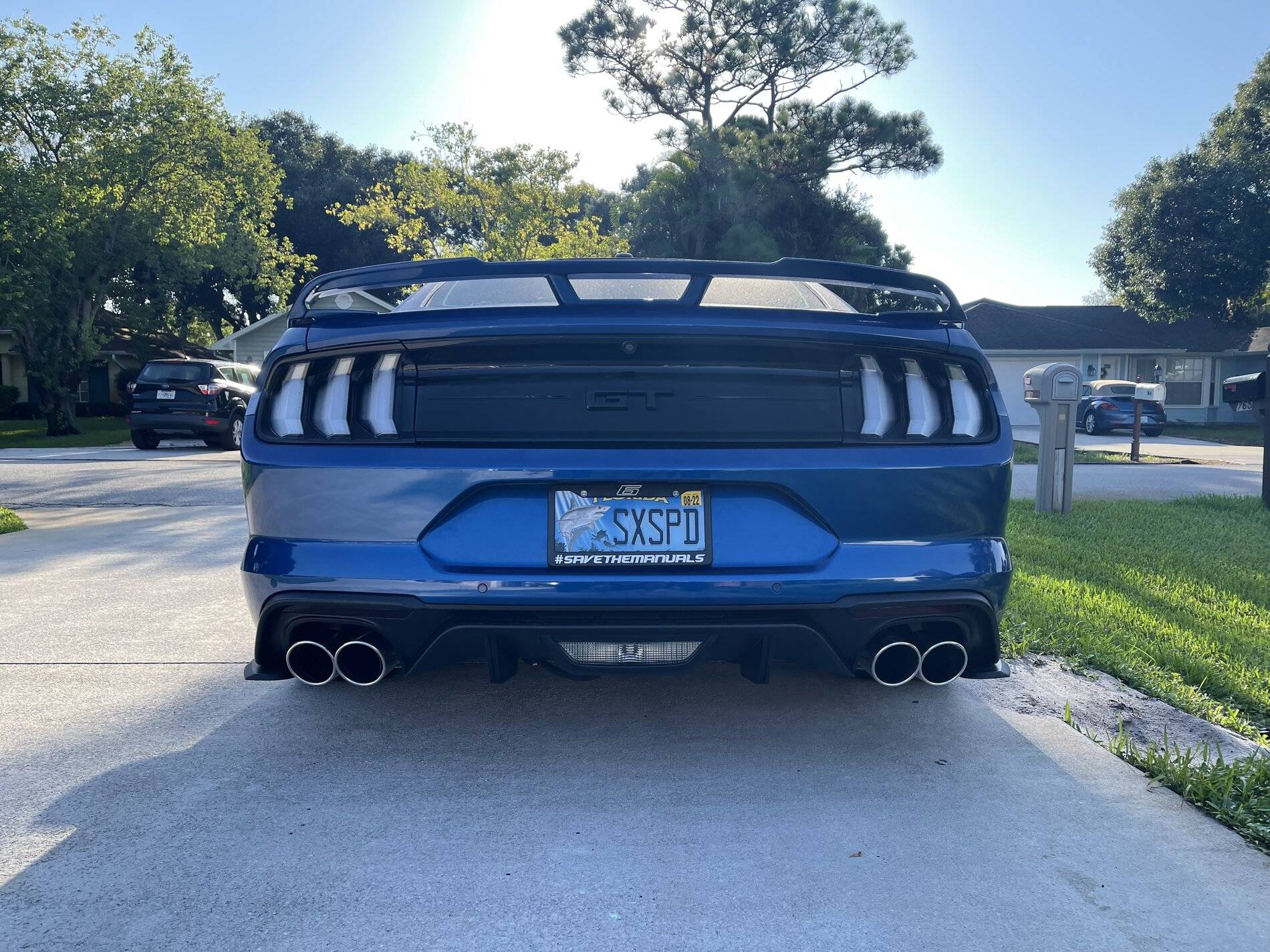

Just installed mine. Don’t know how I feel about fitment. It doesn’t seem like that bolt holds on too well. Other than the diameter being slightly bigger, I feel that’s what is really holding it. Seems like driver side sticks out a bit more. I guess it’s just my OCD. Maybe I’ll just weld them on. Either way here are some pics

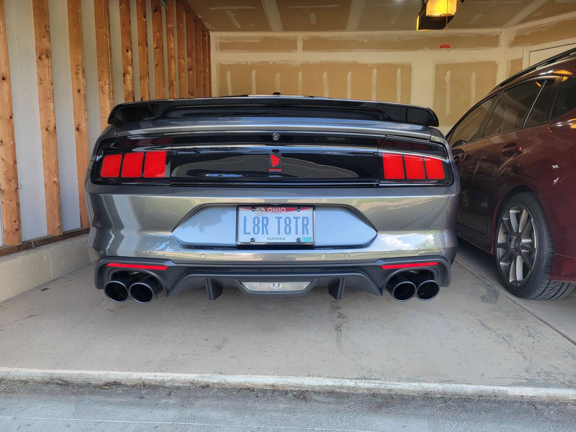

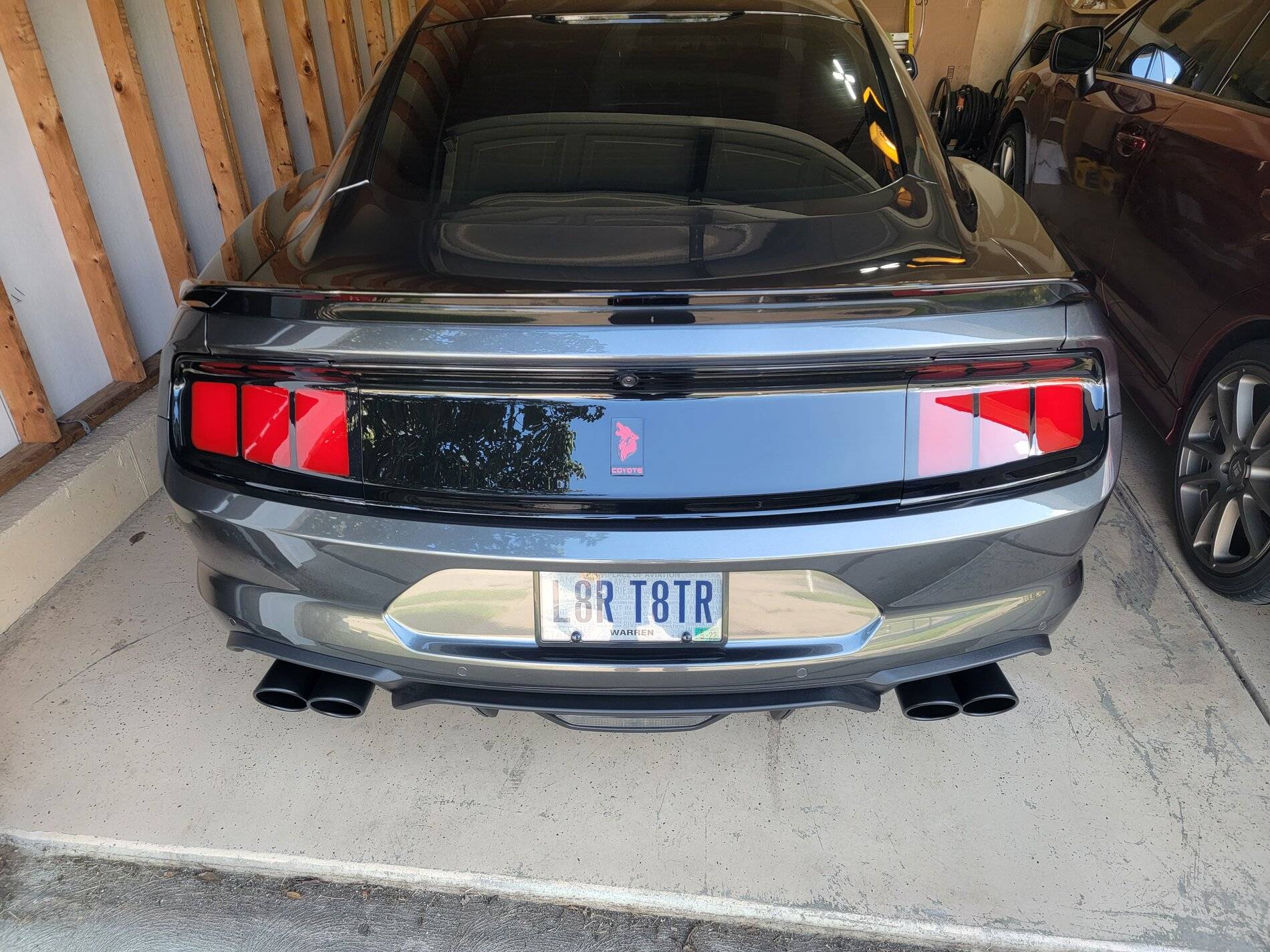

I've noticed a few OE muffs with the same issue. Mine do the same thing but it is now much less noticeable with the larger tips.

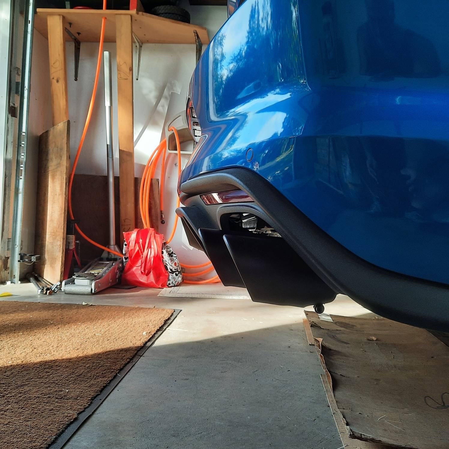

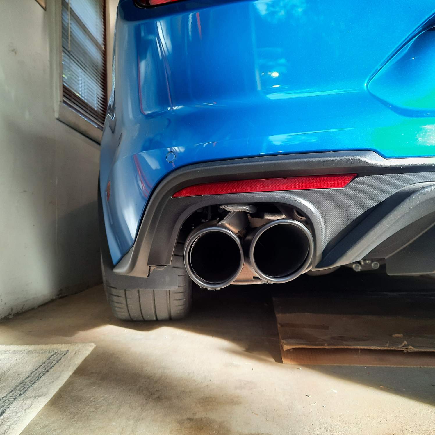

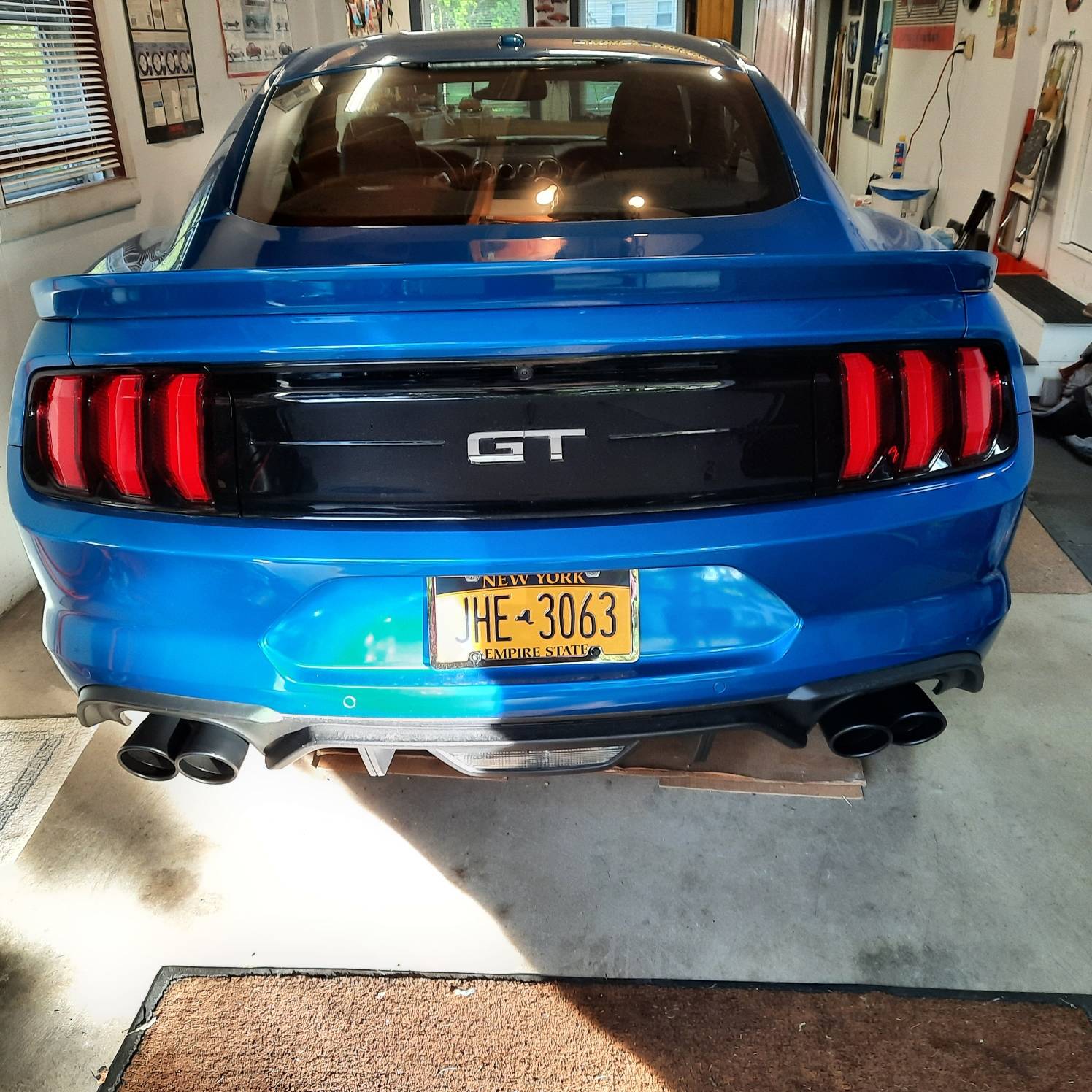

As the 2 tips on either muffler are welded to a single muffler there's no adjusting. Unless your going to cut/weld one tip, and one tip only. Look at my middle picture. The inner tip is higher than the outer.

Would not suggest welding yet, post a picture of the tip, the advertised photo.
Question for both, has the resonator been deleted ?
These tips are slid on over the stock tips ?
What I can see.
White mustang they look even, just cocked ? If the resonator has been deleted.
Go to the clamp connection aft side of X/H pipe, loosen some, not sloppy. You want to be able to rotate the muffler and it hold the position .
3 ways to get is trued, eyeball, torpedo level or tape measure from ground to underside of the tip.
Blue mustang LH, are the tips slash cut.
The center of the slash must be perpendicular to the ground. Will look sort of egg shape, the inboard tip appears that way.
Think your's are slipped over the stock tip, and a standard hose clamp holding things on. Getting the tips trued will take some trial & error. The clamp will have a tendency to shift the alignment as it is torqued .
Would like to see a shot of the tip as purchased ?

White mustang here. Resonator was replaced with a Roush H pipe. The tips are slip on and are tighten by a bolt. See the listing here https://www.ebay.com/itm/Car-exhaus...2349624.m46890.l49286&mkrid=711-127632-2357-0
I will avoid the welding route now that I think about it. Let’s see how it holds up during driving this week. I’m not too crazy about how these tips are mounted on. I’ll try to get a close up picture tomorrow.
