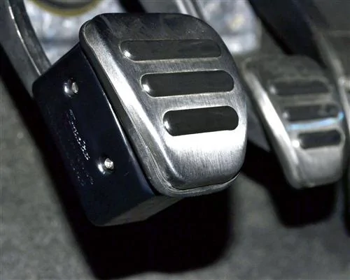

Hey maybe it's us short guys that aren't seeing it :). I'm with you Elp-jc with having my seat slightly more forward than I would normally like......and I will never use one of those pedal extenders.

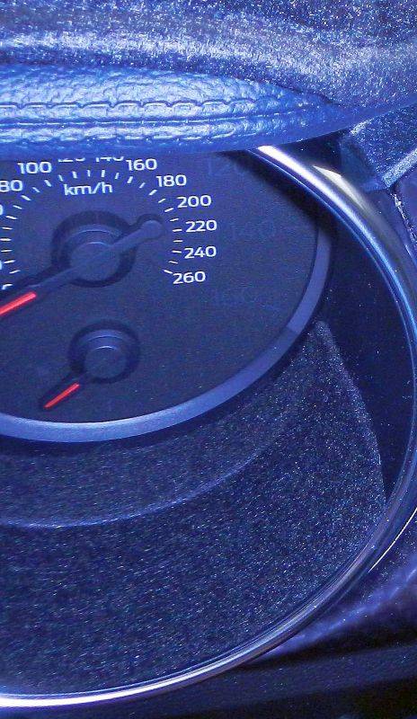

The informative elements of the dashboard just flat hide during certain sun angles, even with the top up. Eliminated the problem with (you could look it up) "Sticky felt", black in color, as shown in the attached photo. Cut it to fit before removing the non-stick backing. I learned that this stuff wants to stay stuck, seriously, so next time I'll not use the whole Sticky back to keep the pieces in place, just cut a few apertures in the backing, so it will sit still but be removable if desired.
1)

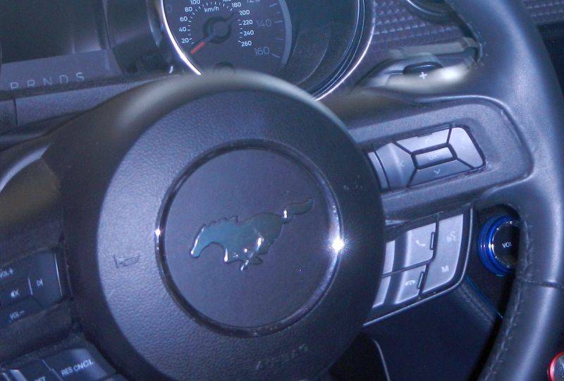

I don't often see mentioned the Extremely Bright flash I get from the aluminum steering-wheel spokes, which I have successfully mitigated with "Blackboard" satin black Contac®-type vinyl shelf-ish paper. See photo 2.
2)
