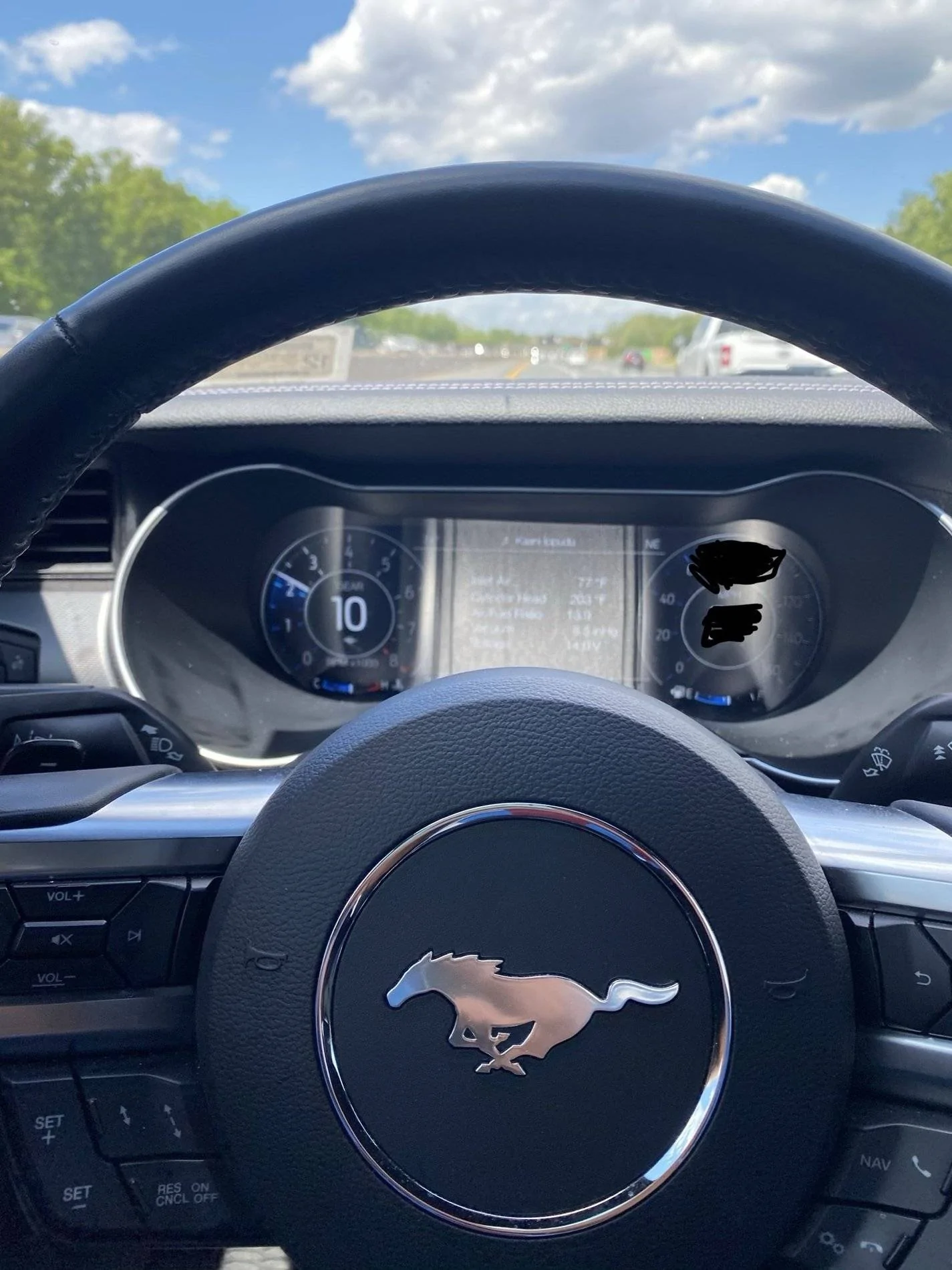

Im not sure if this was an issue a lot of people so or if its just due to the seat set up, but my digital dash catches a lot of glare from the plastic piece under it when i drive during the day with the sun above the car. If anyone has had this and was able to solve it, can you pass on some recommendations?
Thank you.

*picture for reference.

Hey, 2250 rpm in 10th gear is like 90 mph, no? Hope no Arlington MA cops here. Ha ha. J/K. Back to your issue. I haven't noticed that yet, but now that you posted it, will check it out. I use the sport and track modes only, with the 3 middle gauges. And have both primary and secondary as white, so brighter than other colors.
Hahaha thank you for reminding me to update my location to mexico
also, its honestly a little better than the picture where you can still read whats behind it and i like the normal better coz i can see what i want and can go without the gauge info.
