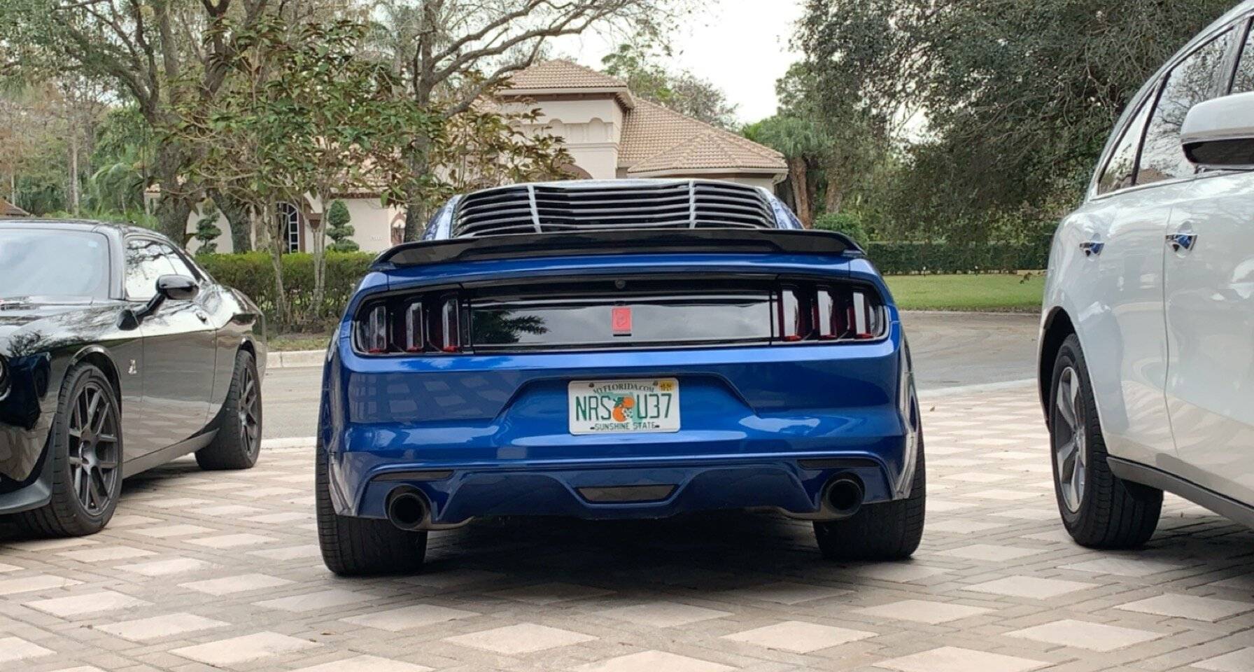

What wheels are those? I couldn’t make out the center cap.
