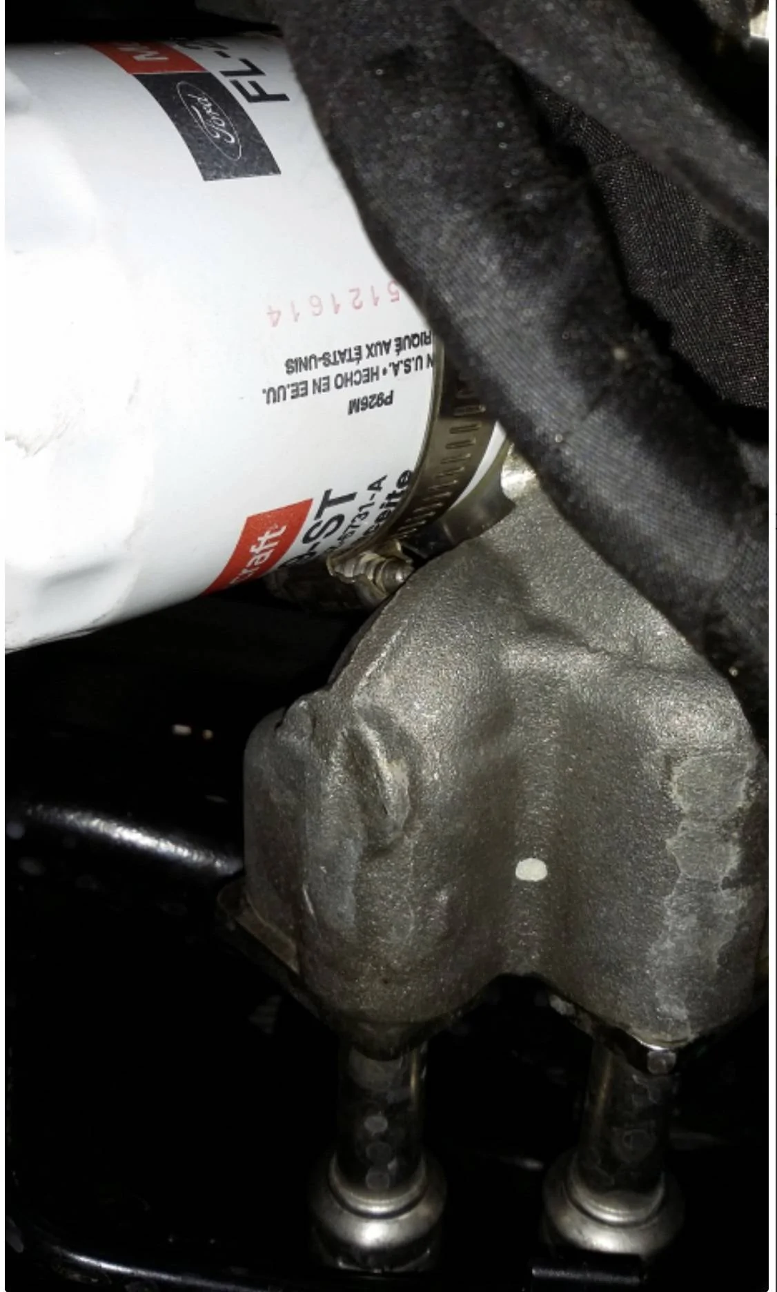

For those who successfully -for years- tightened a spin-on oil filter hand tight- then an additional 1/2 turn, now to learn that 18 FT LB's was required for the 2016 GT350 came as somewhat of a surprise, but understanding WHY was the interesting part for me, and hopefully for others who want to know.
Due to the inherent "Secondary Vibration" of the Voodoo's 5.2 Flat Plane Crank, this additional torque was necessary or the filter would definitely loosen on it's own after time.
A detailed -in-depth- explanation of the vibration is explained in this article for those interested:
https://trackmustangsonline.com/threads/interesting-article-on-the-gt350-flat-plane-crank.10306/
When I got my 2016 GT350 this oil filter issue had caught my attention, as many of the new owners who took their cars in for the oil changes had the filters loosen and leak oil.
For an added security measure, I purchased a 3" hose clamp from the parts store and performed this trick, -which I still do today- to prevent the filter from loosening.

For an added security measure, I went to the auto-parts store and purchased a 3" hose clamp and performed this trick, -which I still do today- to keep the filter from loosening.
I do this same thing on my 2017 with spin on filter......

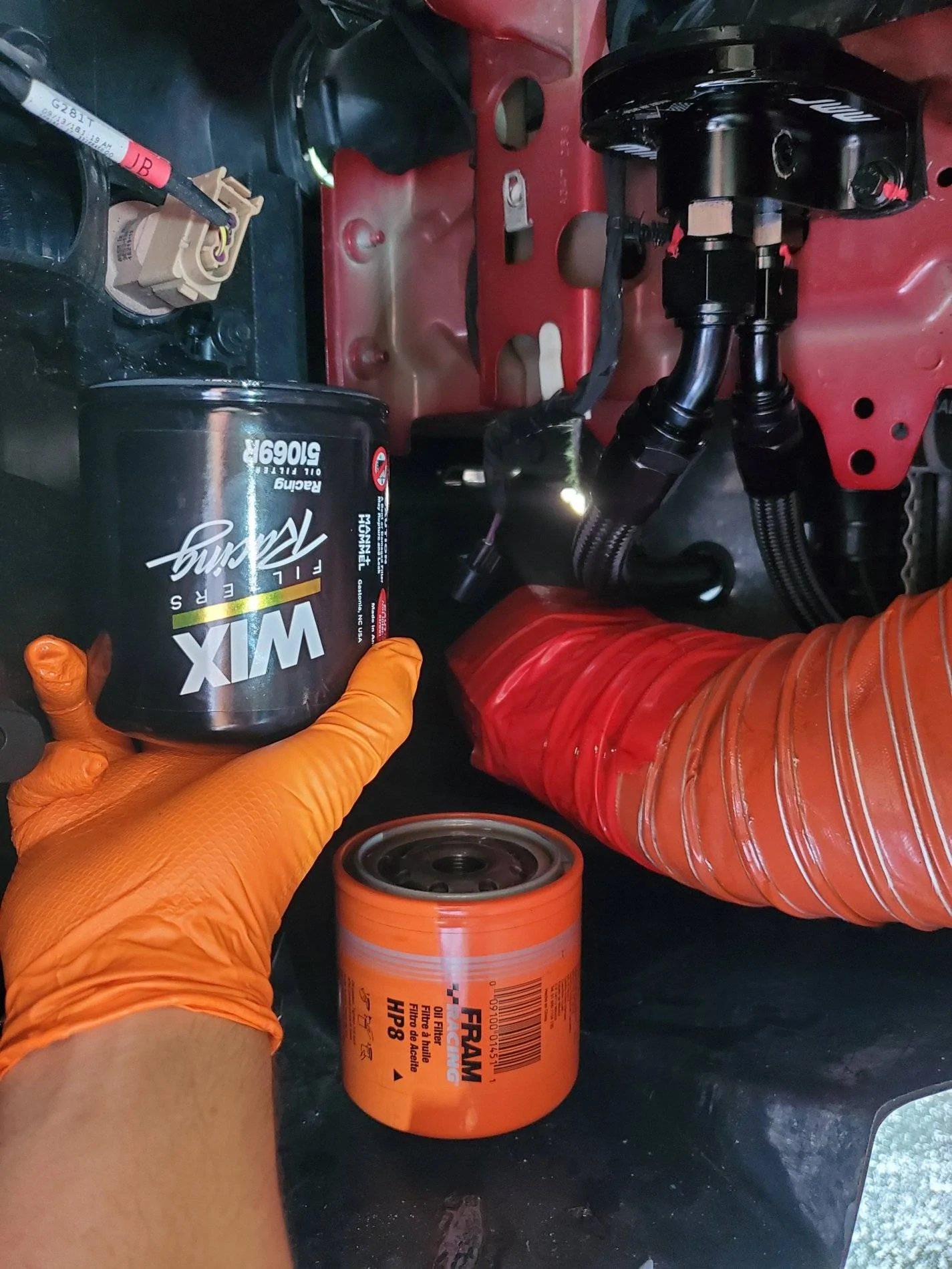

FWIW, I did a remote mount kit on my car during the refresh and have been very happy. So much less stress.
