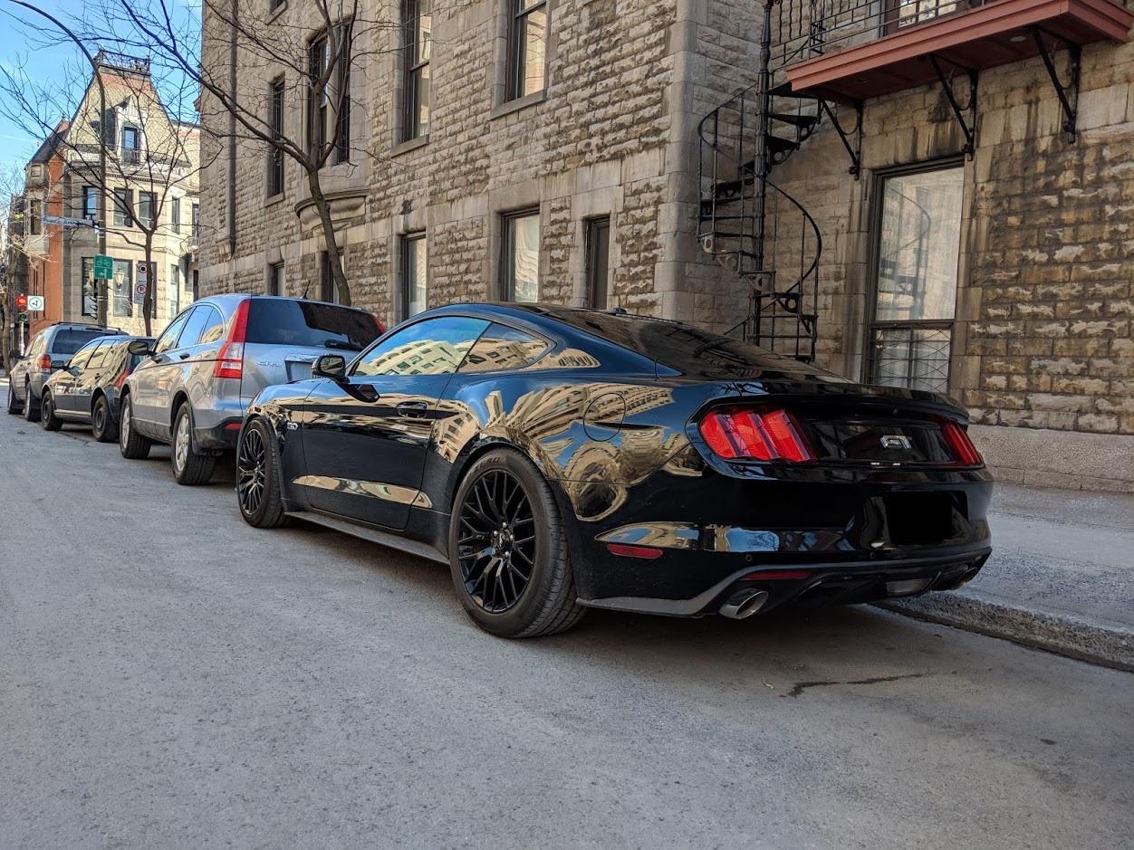

Looking for information about lowering a performance pack GT 2016.
Derf
Feb 18, 2019
Montreal
Fred
Mustang GT Premium 2016 Performance pack
Keep in mind that im looking for mostly looks.
Do i already have top quality suspension and it would be not wise to change it?
What are the good options?
Would it be good to pair it with 3/4 spacers?
