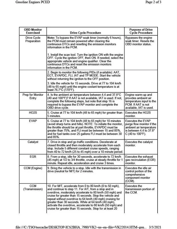

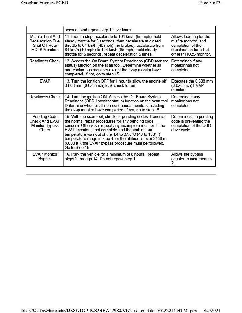

A few things to try. Have IMRC plugged in. Install stock cold air intake and reload your stock tune. Reset your battery. You will need to perform a full drive cycle to get the monitors to clear and in he ready state. Typically driving like 50 miles in certain conditions you can look up online. You can also use an OBD wifi/bluetooth adapter and something like OBDFusion on your phone to see if all the monitors clear before you go back to try again.

Resetting all the alerts for emissions is a pain.. After my engine rebuild and tune I had the same issue.. I tried all the recommended routines - start, hard accelerate drive at 40mph etc. Couldn't get I'M readiness Cats, O2S and HRT.. so would fail the North Carolina emissions test.. Only one "not ready" is allowed.
After driving it for about 10 days it also did not reset :frown:
The key to the reset is NOT to drive in 6th gear (manual) keep the car in 5th for the CAT and O2S reset.. Eventually mine all reset and passed no problem..

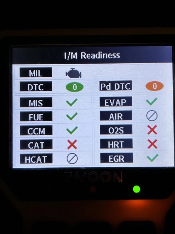

Basically what this boils down to is you need to connect a code reader and use the "IM readiness" check to look at the status of all the monitors. This car should have the following monitors:
  • misfire
  • evap
  • fuel system
  • Catalyst
  • O2 Sensor
  • O2 Sensor heater
  • EGR
  • Comprehensive monitor
If any of these items are "not ready" or "not equipped" or "not available" you will fail a plug in emissions test. I would bet that one of them is stuck not ready because of that IMRC delete. So hook up a code reader and look at the monitors. See which one is causing you issues.
"tuned to pass emissions" is a load of bs most of the time, they just disable the code but its not possible to force the monitor into a "ready" state. The reason you can pass sometimes is that many states (including mine) allow you to have at least one monitor "not ready" and still pass the test, but there are weird stipulations about that. Some places only allow you to have one monitor be NR but never the same one twice, some places allow one or two NR but all need to be ready on the first time the car is tested. It varies wildly.
Always watch these monitors, if any are ever "not ready" you have an issue.

Just the O2 Heater, O2 Senor and Catalyst will not ready. Ohio allows the one monitor to not be ready as well so, they simply do an OBD-II plug in and that's all the inspection entails. It's hard, don't really have cash on hand to do a whole stock manifold swap.. Unless I somehow was able to trade in my GT350 Manifold for it and let some of that extra money be used to cover the labor?

The headers are absolutely causing you to fail, I bet your tune disables the rear O2 sensors entirely, which IMO is a foolish method to "tune out" cats. Buy some J-style non foulers and put them on the rear o2 sensors. Drive for a while and see if that works. If that doesn't work then you need to go back to the stock tune, which will require you to put that IMRC back together or else you'll fail for that.
This is why i think disabling the rear O2 sensors is foolish, it makes it impossible to pass a plug in test. All it does is prevent the CEL, which would have been enough to pass emissions 30 years ago but hasn't been in a while.

Another option instead of going back to the stock tune, would be to get your tune updated so that it doesn't mess with the rear o2 sensors at all, then when you put the spacers on he rear o2 sensors everything will work.
