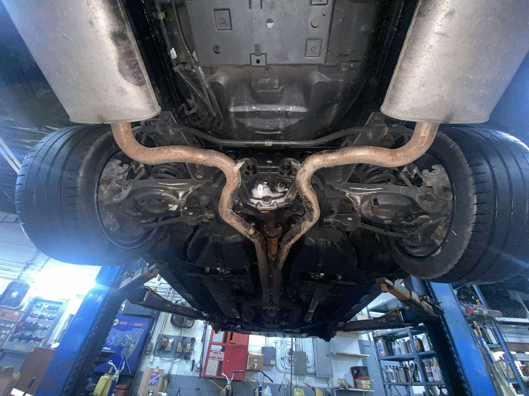

I don't believe I have long tube headers on the car?
You should check, that cat code combined with the o2 sensor codes is almost always caused by them being shut off for LTH.
it could be stock cats with the code shut off as well

The headers are absolutely causing you to fail, I bet your tune disables the rear O2 sensors entirely, which IMO is a foolish method to "tune out" cats. Buy some J-style non foulers and put them on the rear o2 sensors. Drive for a while and see if that works. If that doesn't work then you need to go back to the stock tune, which will require you to put that IMRC back together or else you'll fail for that.
This is why i think disabling the rear O2 sensors is foolish, it makes it impossible to pass a plug in test. All it does is prevent the CEL, which would have been enough to pass emissions 30 years ago but hasn't been in a while.

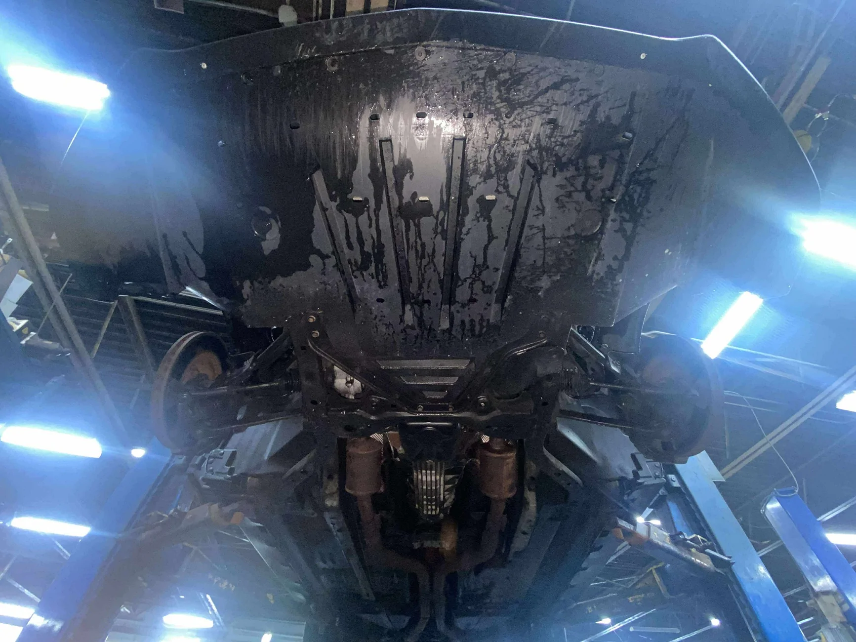

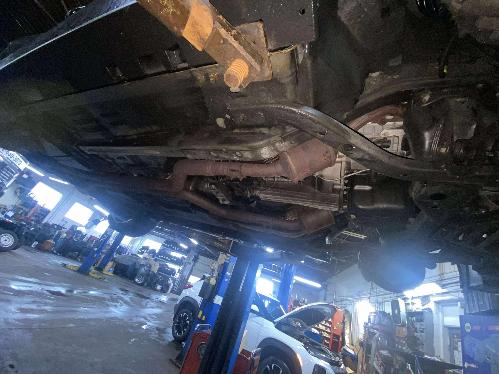

Post a picture of your car from underneath to first determine if you have headers. That way you can eliminate that as one reason for the failure.

I don't have LTH on the car, stock underneath. I contacted a performance shop and they said it sounds like the Rear O2s are disabled and that they would verify they are off before turning them on. I told them everything I said here and them seem to understand. I'm curious if it is my tune, or the Rear O2s are really off and that's been the problem for MONTHS. You can look underneath the car here on the forums. Please provide your thoughts, you have been so helpful.
