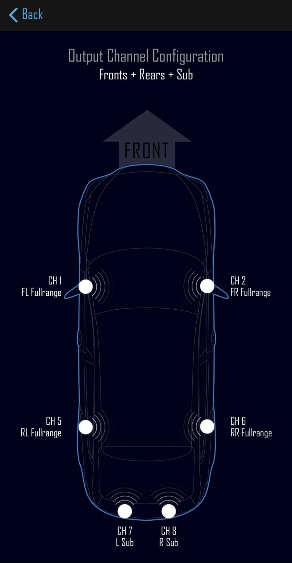

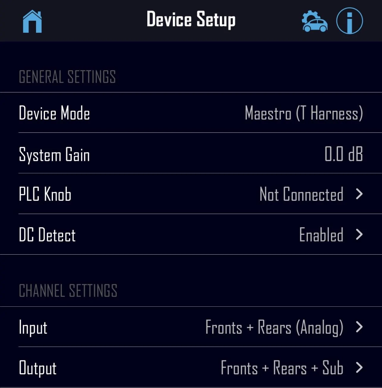

Stock radio to dFO2/DSR1 to Alpine. Connect the Alpine system like page 10 of the Alpine system’s owners manual (the aftermarket headunit flow diagram).
The DSR1 should be set up like this:
