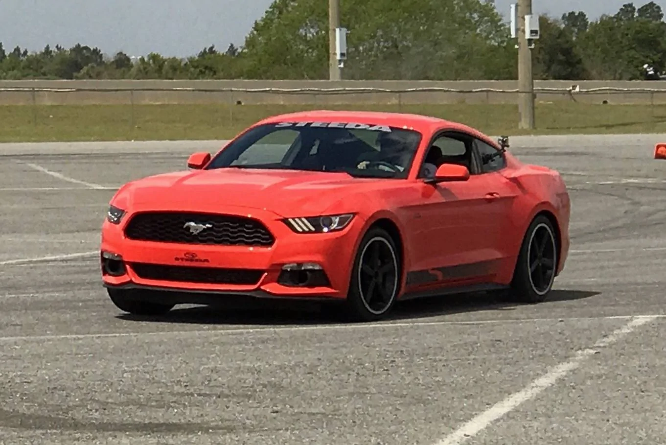

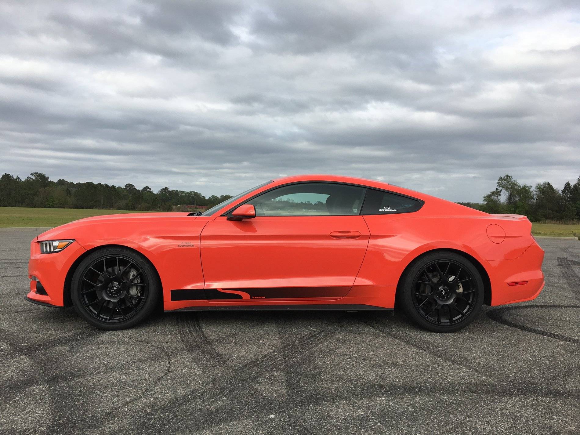

Hi Ryan, You can contact Jamie Bell our auto cross SCCA champion for suggestions, he is in charge of our Ecoboost program. He can be reached at 954-960-0774
The car turned a 1.18.at the Firm in North Florida.
