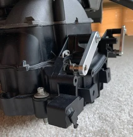

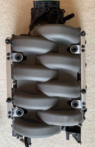

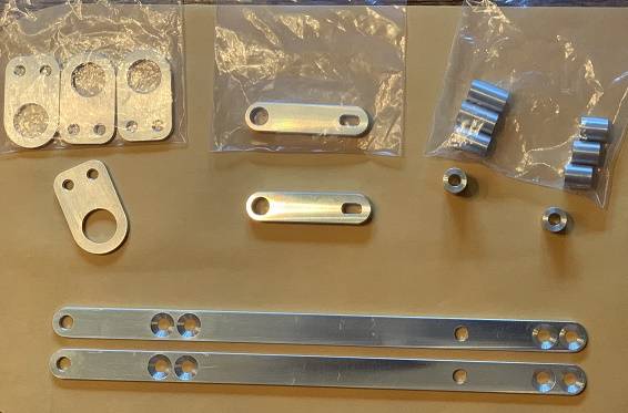

I just had a complete bracket and lockout set made out of aluminum from a forum member's drawings.

I found the drawings I sent into the machine shop are off slightly. I will be sending them an updated revision for the rails this will make the fit and finish spot on.

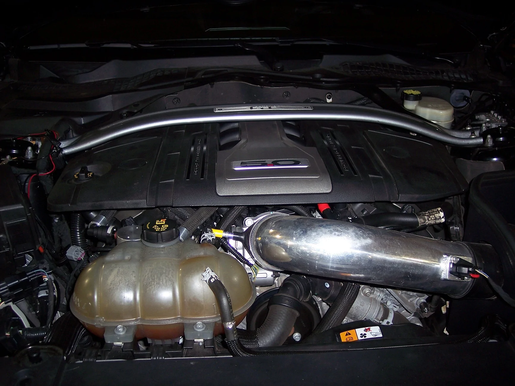

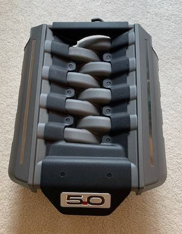

this is my 2015 with 2018 manifold with a 2018 engine cover and extension filler tube modified.
Journey GT 435
Apr 3, 2025
436
299
MN
Craig
2015 5.0 GT Mustang premium pp / 2011 3.7 Mustang / 2010 Harley edition F150

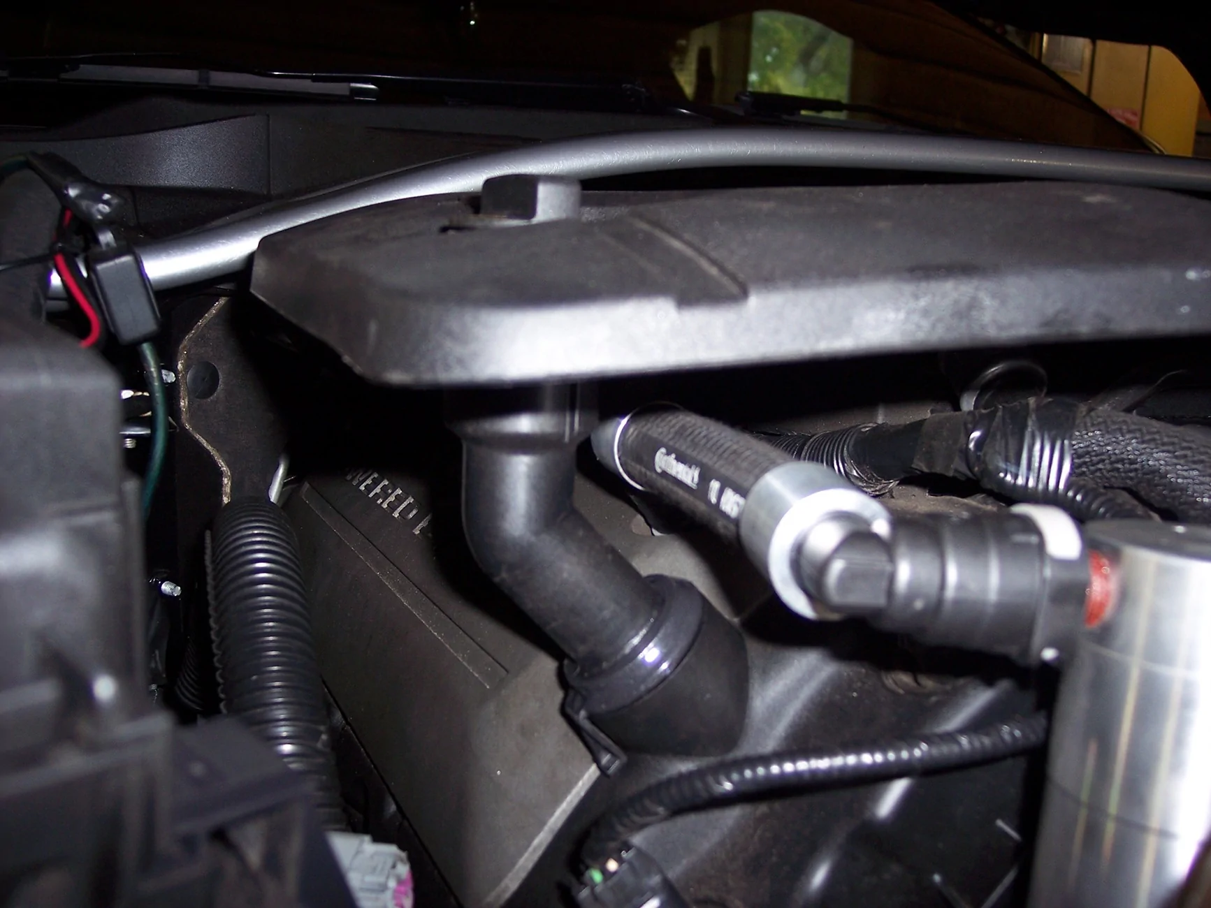

I just ordered the 2018 engine cover from e-bay and it fits right on. It does have one issue though, there is an oil extension filler tube that goes on in place of the filler cap and in 2018 Ford changed the thread style on the valve cover, so the 2018 filler tube won't fit in the 2015 valve cover. I bought a 2015 filler tube and cut off the threaded end and bored it out to 1.128" and I bought the 2018 tube and cut off the end that would have gone into the valve cover below the O-ring and pressed it into the 2015 threaded part and JB welded the two parts together.
