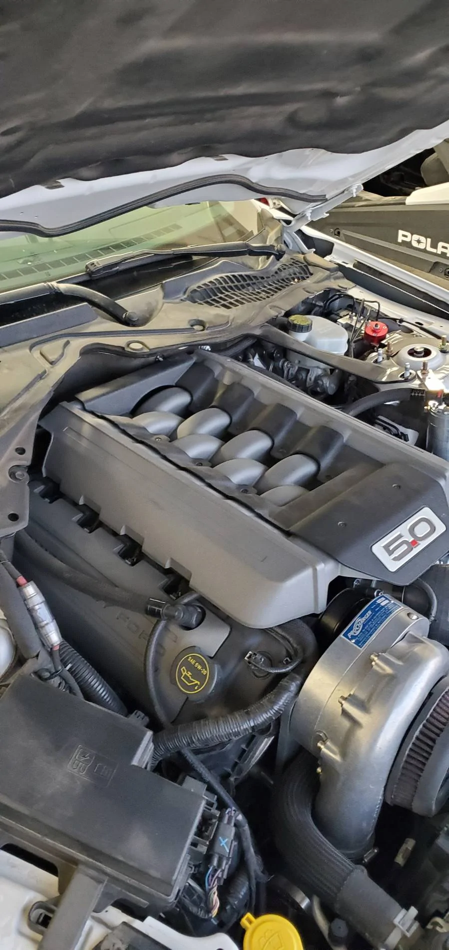

I did it on mine. No IMRC. The shop just cut a few tabs/pieces of plastic away. Was about 20 mins work.

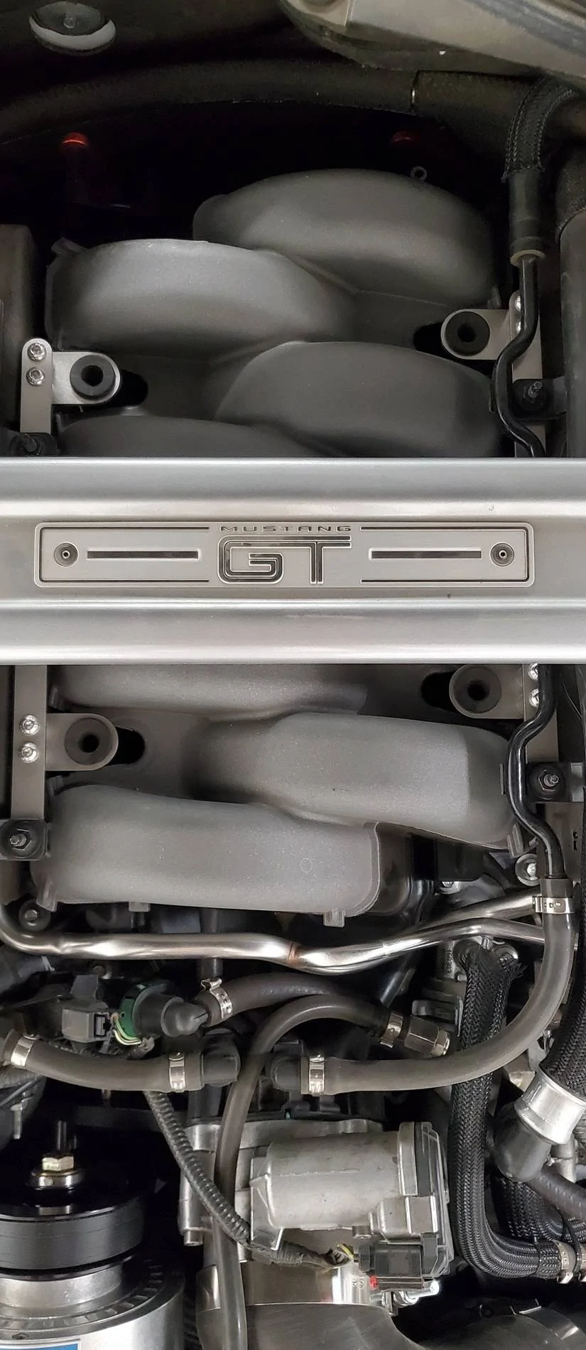

Am I in the minority that thinks the exposed 18/gt350 mani looks way better than that cheap plastic cover?

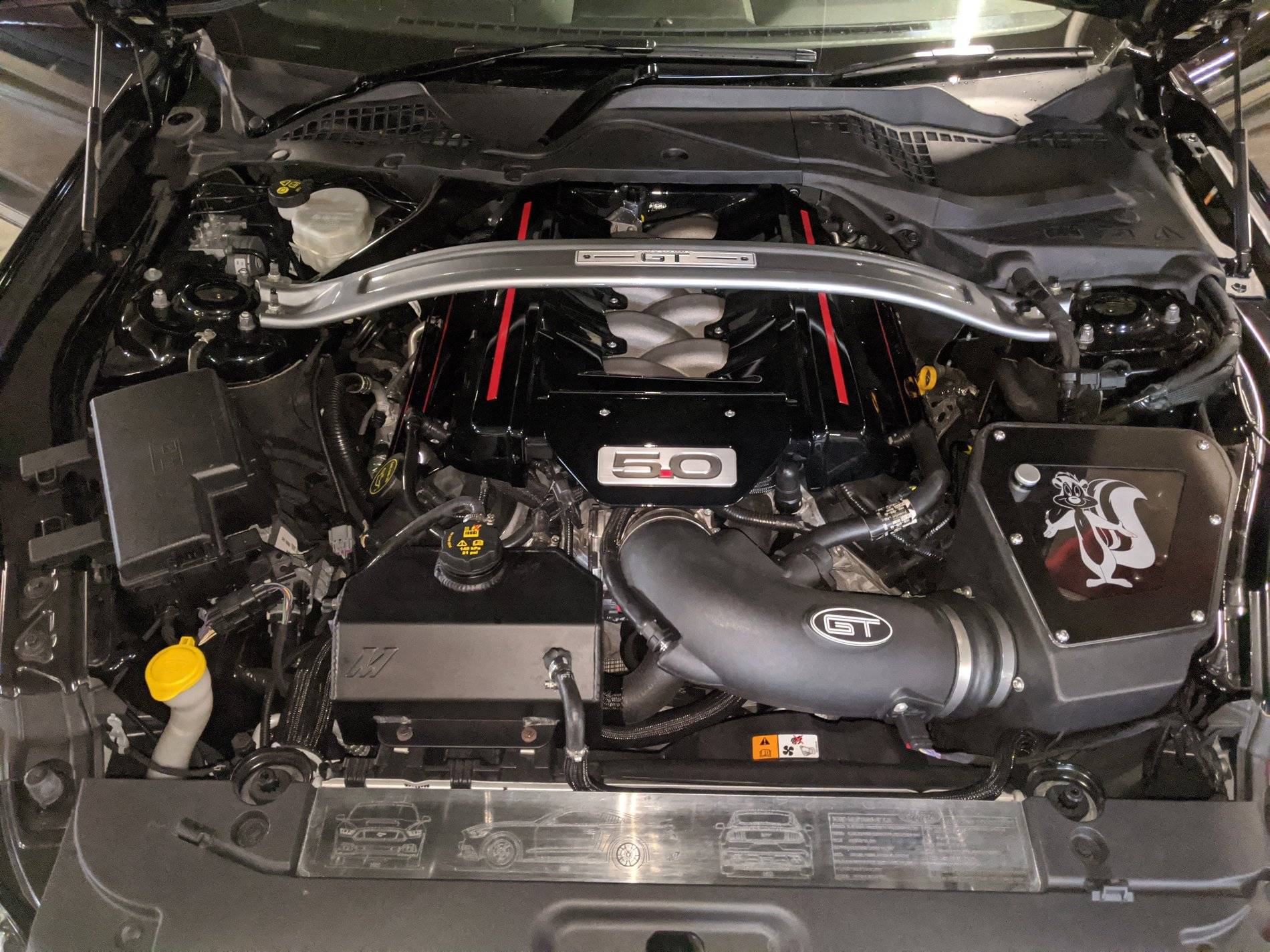

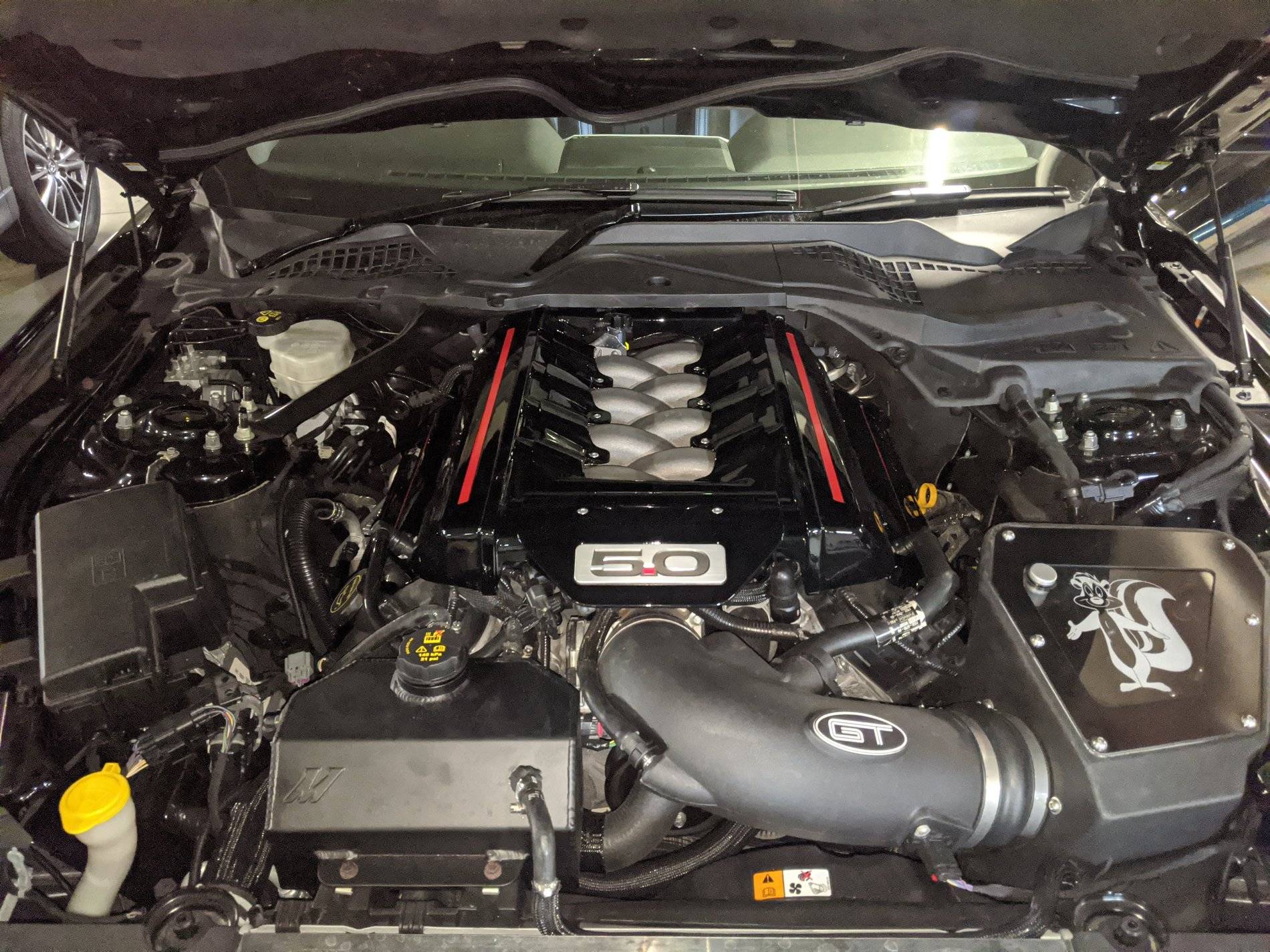

Had my local body shop remodel the engine cover to fit to my recent 2018 Mani swap... Think they have done a great job. It sits a little higher than stock but I think it looks great.
TeamDenno
Jul 12, 2016
469
423
Sydney
S550 GT V8 Manual
And finally with the strut tower brace.
