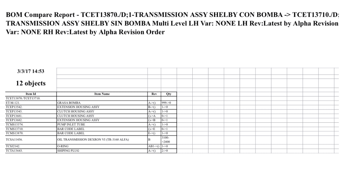

In case anyone wants the parts list difference between the two flavors of transmissions, here it is. This is the list of parts from Tremec that is needed to make the non-pump transmission into the pumped transmission.
I was bored.

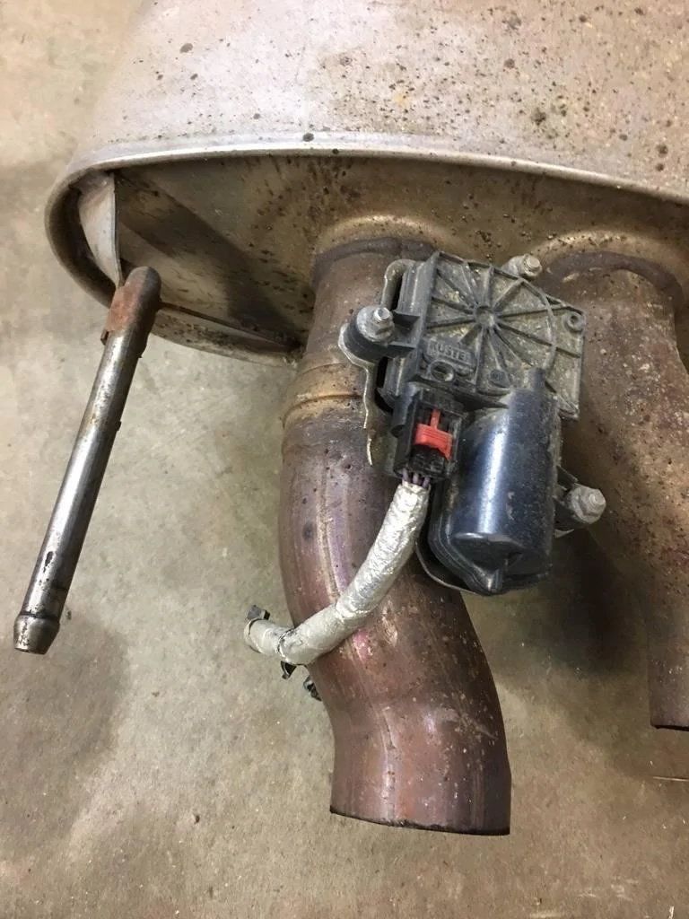

One - the connectors on the exhaust switches have red tabs on the top. Those tabs need to be pushed toward the back of the car in order to disconnect the fasteners. I had a mirror but still couldn't see the tabs well enough to tell what needed to be done. Here are some photos. First one is the red tab in locked position.

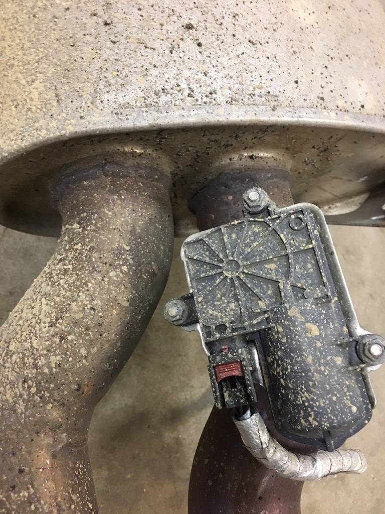

This one shows the tab unlocked.

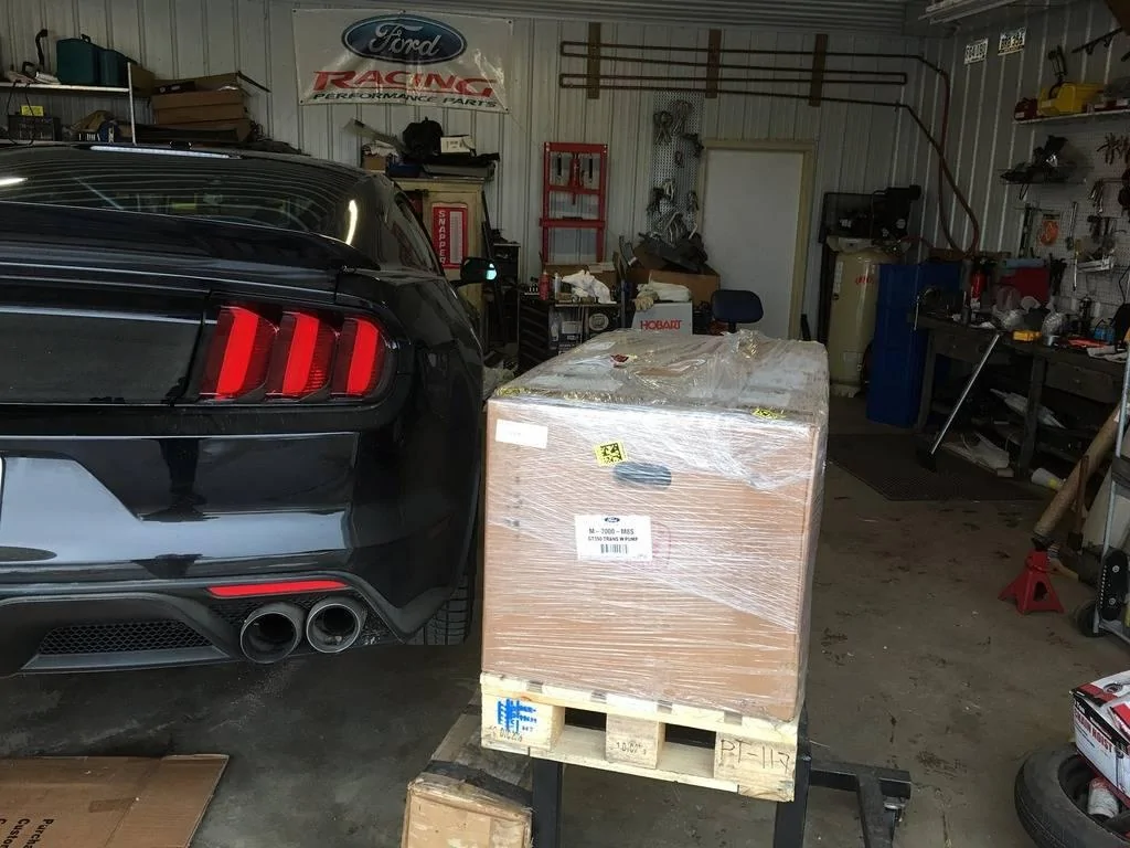

Just a photo of the box.

Just to clarify. Is This the list of parts to convert tech/base trans to the track pack which would add internal pump????
Yes sir, it is. I haven't ripped mine apart yet but there is obviously some minor machining/ tapping of holes to be done.

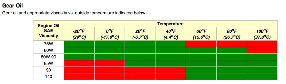

40 Celsius is 104 degrees, 100 is 212, My car frequently sits at 260 degrees, which is 126 C. Limp kicks in at 137. The fluid is extremely thin at those temperatures.
The Mercon name is deceptive since ATF is about 7W - to about 5W in viscosity when hot. Failures happen because when trans overheat they can go to 3W and even 0W loosing lubricity and the ability to wick away heat from surface tension. I see Amsoil Signature series ATF and Readline D6 ATF is able to offer LV spec and I have seen Dextron-Mercon specs in 10-20-30W. The Amsoil is 15W from what I have read however there are different spec charts to show viscosity ( motor oil vs gear oil).
The LV stands for low viscosity...
quote" This uni-viscosity full synthetic fluid is a universal Automatic Transmission Fluid that combines the benefits of a low and high viscosity formula."
Mercon LV is not fully synthetic according to the MSDS (http://fcsdchemicalsandlubricants.co...us179895us.pdf) as petroleum distillates are indicated in heavy and light grades. It a synthetic blend though since the range is open enough to provide for non-mineral stocks too. According to ford "Manufactured with high-viscosity index, premium-quality, hydroprocessed base oils and specially designed performance additives".
Per the information above viscosity at 100c is 6.0 thats equal to between a 75W and 80W viscosity gear oil according to J306 Viscosity Classification for Automotive Gear Oils. If you were using the motor oil chart it would be equal to 15W motor oil in viscosity. 80W gear would stop providing protection when outside air temp reaches 100F and 75W at 60F. I don't see how this is adequate without an oil cooler. Spirited driving would drive the temps up and lead to oil digression combined with the gears sheering the oil would lead to trans failure like I experienced in a hot climate like Dallas. Last summer we saw 114deg combined with open highways I am uncertain that the trans is not being harmed. I suspect Ford is gathering data for a business case as miles and warranty claim begin to to fill in delta's. The Mercon LV has a service life of 150K miles per spec if trans fail and oil analysis shows early degradation thats could be a class action problem against the motorcraft oil itself (Ford's lubricants seem to be supplied by Conoco-Philips) and Ford for specifying this in pretty much all the newer trans. Other cars probably don't hit the same temps but it could be a publicity nightmare like Firestone tires exploding..
At 137c in limp home mode the viscosity would be 3.3 which is about a 65W gear oil
At 126c your typical temp the viscosity would be 3.8 which is just under a 70W gear oil
