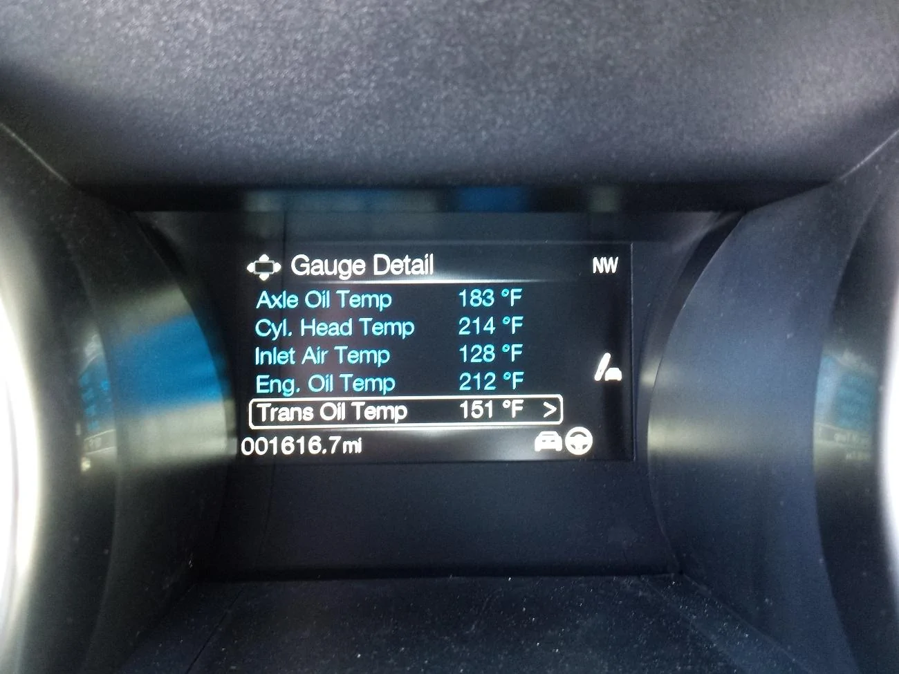

If it helps any of you folks, below is a photo of the temps after a 30 minute session standing on it at every opportunity. Track pack of course

Reduced power here at my last track event. Car limits around 5k as you said and the power goes soft. Not a dangerous reduced power level unlike what others have reported. The Forscan mod that allows you to see the tranny temp was a BIG help as I knew when to expect it.
