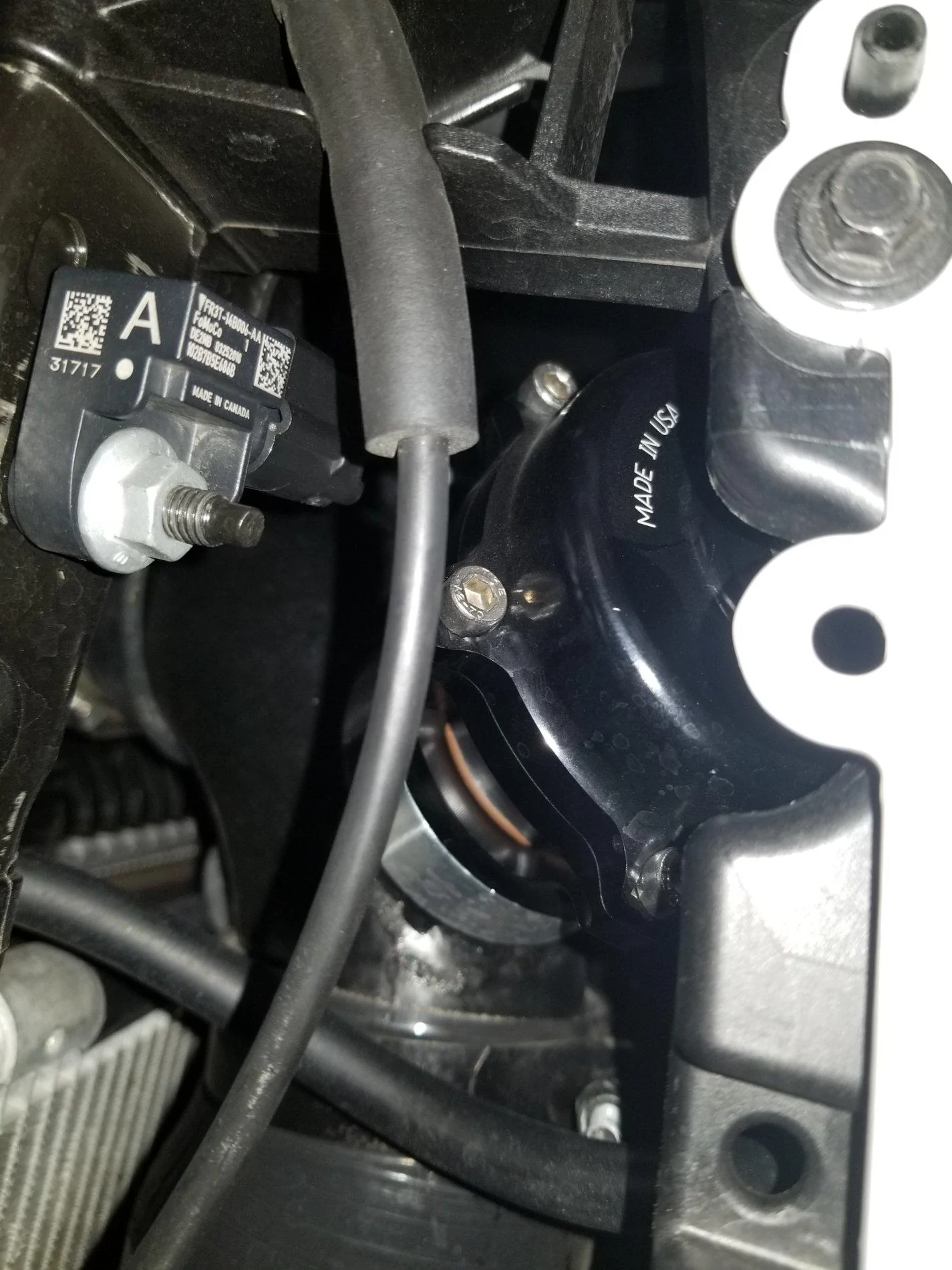

HOLY f***ing blow off valve. Why? lol
I've seen those they developed them right around the time the F1x was having its issues. He doesnt need it for the D1x but not he wont have to do anything if he steps up to the F1A-94 or F1x....its literally a double size one....I bet it sounds nasty. I run 2 tials on my -94 with supercharger springs and use one with a 3 way valve for boost by gear...when they both blow off on the leg out its massive air haha

The stock Proflow that comes with the PC kits is good to around 800-850ish max.....the D1X will do 1000.
Personally I hate the stock one period I like the sound of the red race valve it's what I always used...that is the newer DUAL red race valve if I recall. He could have gotten away with the single red race but this probably sounds wicked and gives a lot of head room for a head unit upgrade...I run single red race on F2 and F1A-94 just fine. I'm not arguing against it at all to me it probably sounds viscous AND keeps him from tearing to bumper off again or changing fit to put it in there. I'd probably do that too now that they are around, fit it for the biggest you will ever need then you never have to do any fab again on it.

So...just to be correct. In the pictures below....the top one is what I have....the bottom one is what I should have.
They are the same valve..no double valve. The one I have is made to have a hose on it so you can direct the dump back into the system or where ever depending on you set-up. The other just opens up and vents to atmosphere making it a bit smaller and easier to work with.
I got a deal on the one I have and just used it. I took the snout off so it would fit where I have it....but it is the same as the other.
Oh I had awesome it's like a race valve version of the proflo!!!! I retrofit usually and havent ever seen this one awesome!!! Thanks for clarification!!
Just one is the common open version, and the other is closed, ie route a hose somewhere as said. They do offer a bigger pro race valve now too, but it's yuuge. We replaced 2 open standard big red race valves with one of the pro race. F3-121 lots of cfm needs dumped off. LOL!
