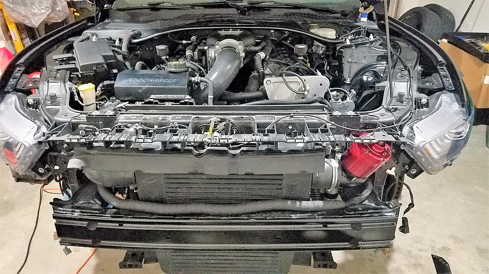

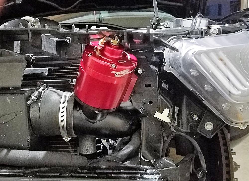

Just switched to D1X from P1SC-1 and did red race valve. Here are pics of my location.
Oh man perfect that's a lot for those pics absolutely perfect do you find it over heats at cruise ect with that captain insano huge intercooler Haha its sweet as hell though!!!!
No over heating at any speed. Thats the stock Stage 2 intercooler.

See you went with the double race valve too!!!
