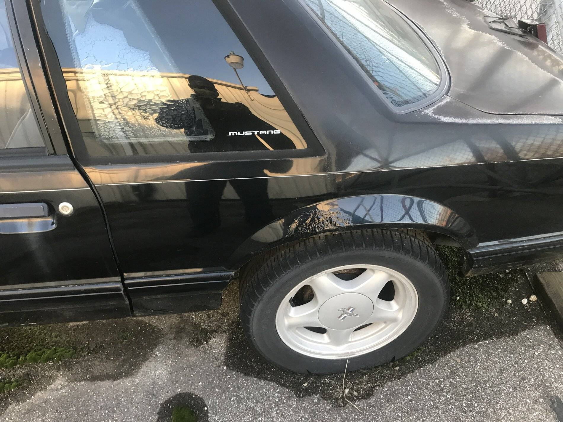

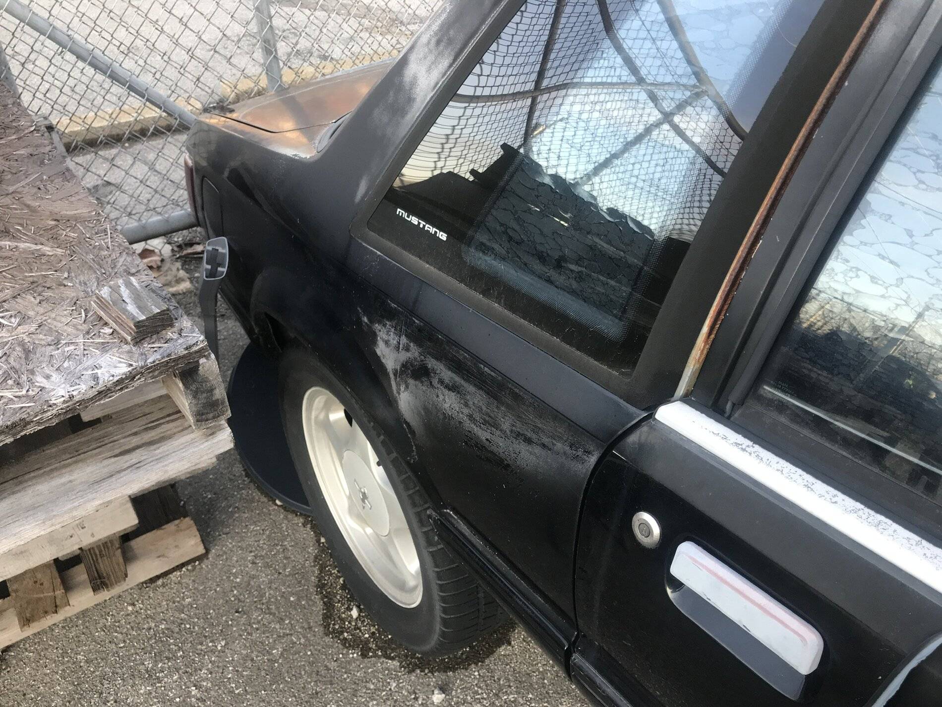

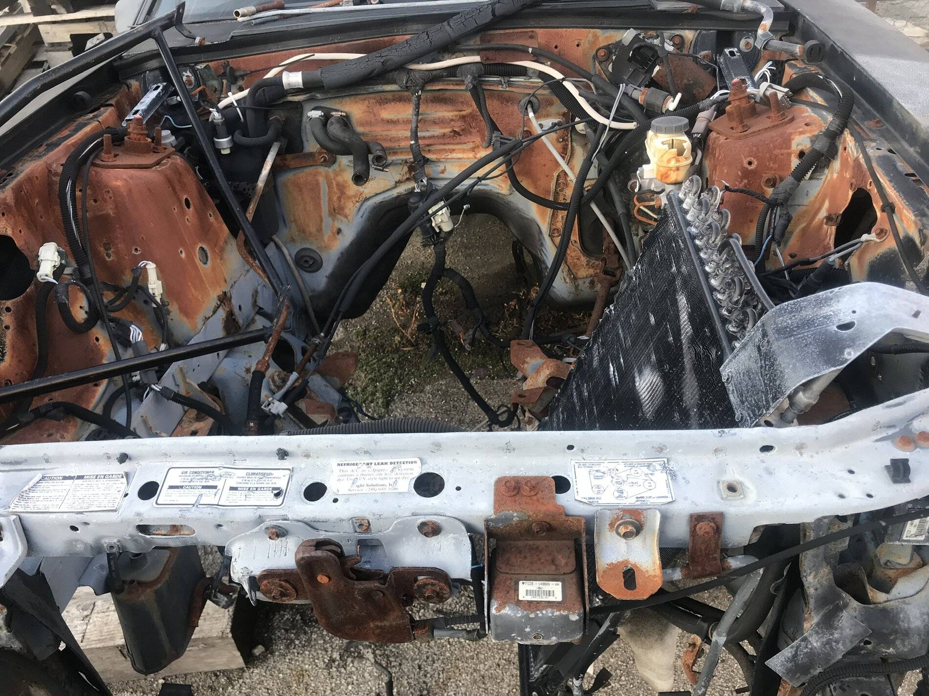

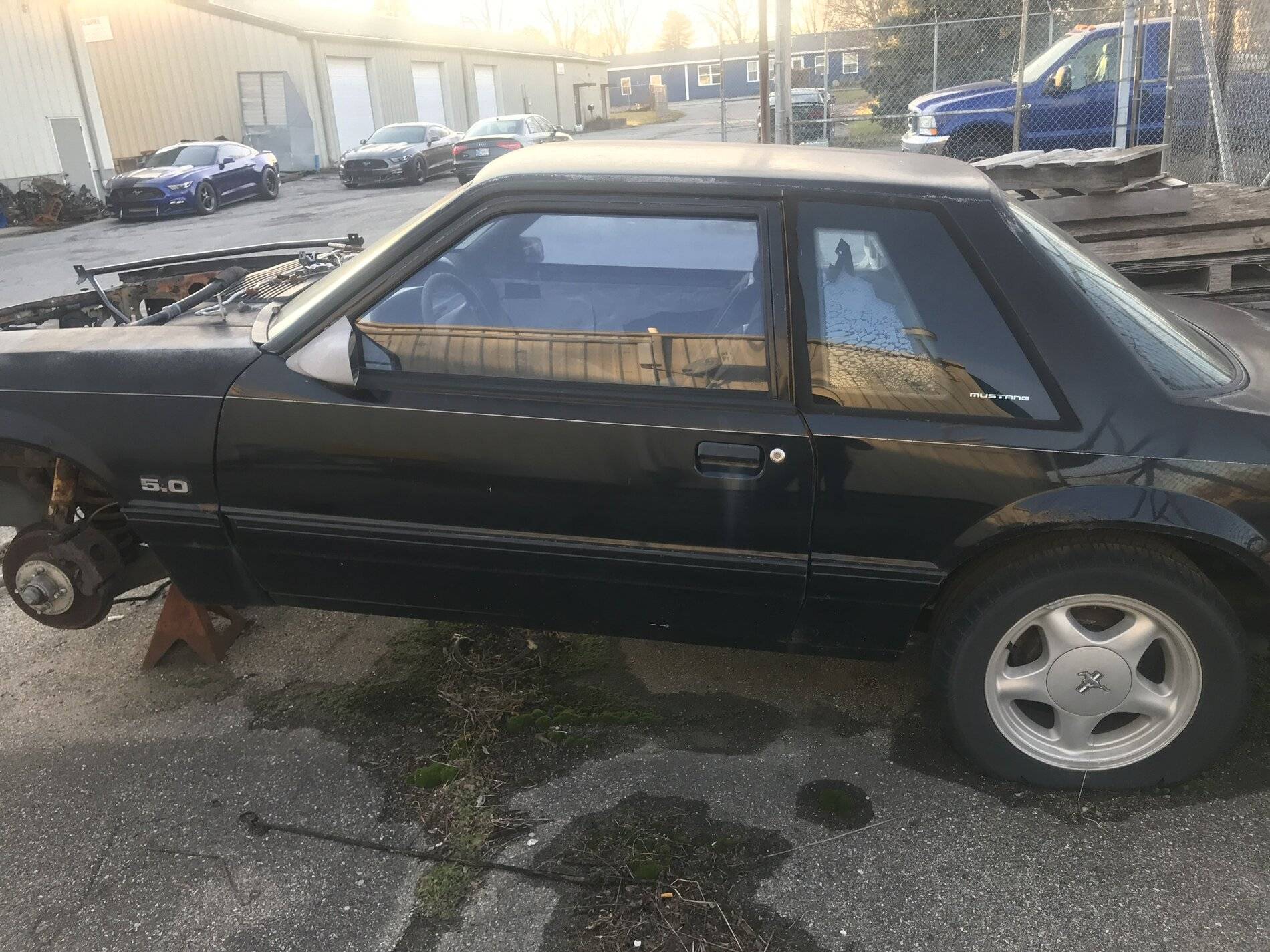

I picked up a fox body roller locally . It’s roughy and going to be a ton of work and I expect $$ .
it will be going to great chassis shop that builds race cars and I will probably have do it in stages as $ permits . It may take while but I think it would be with it in the end .
At least I already have the motor and transmission- coming out of my 18 GT when I swap in the built 5.2 long block/LPF transmission in spring .
