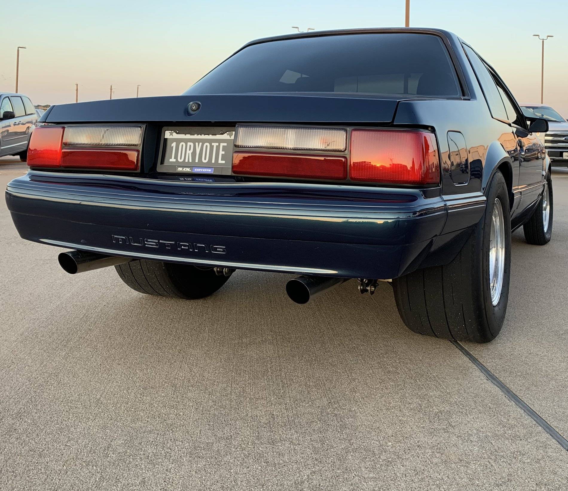

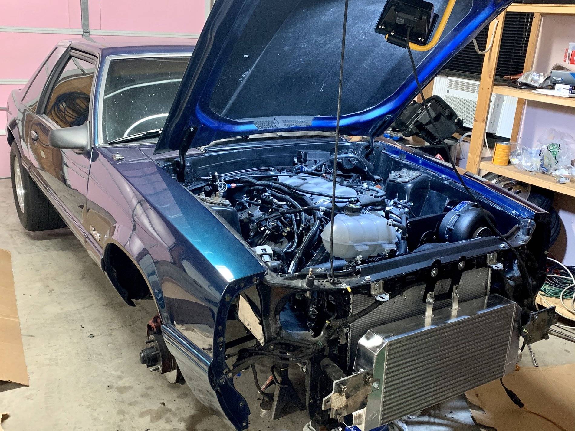

Hey guys I’ve lurked for awhile and am doing a P1X install on my 89 Fox Gen 3/10R80 swap.
My question is, how much boost are you seeing and what kind of power? List your pulley size, power, and fuel if you don’t mind! I am starting with a 4.38 and want to know what I should expect.
*Pic attached of the install

I’m on a 4.25 pulley and seeing 13 psi at 7500. I haven’t dyno’d on this pulley but when I was on a 4.5 pulley I put down 820 at 8000 rpm. I’m on a d1x though

Awesome. So I’d imagine at 7500 I would probably see 750rw on a 4.38. Perfect for what I’m wanting. N/A it’s already a rocket. Been 10.90’s at 128 with no burnout on the street via a Dragy.

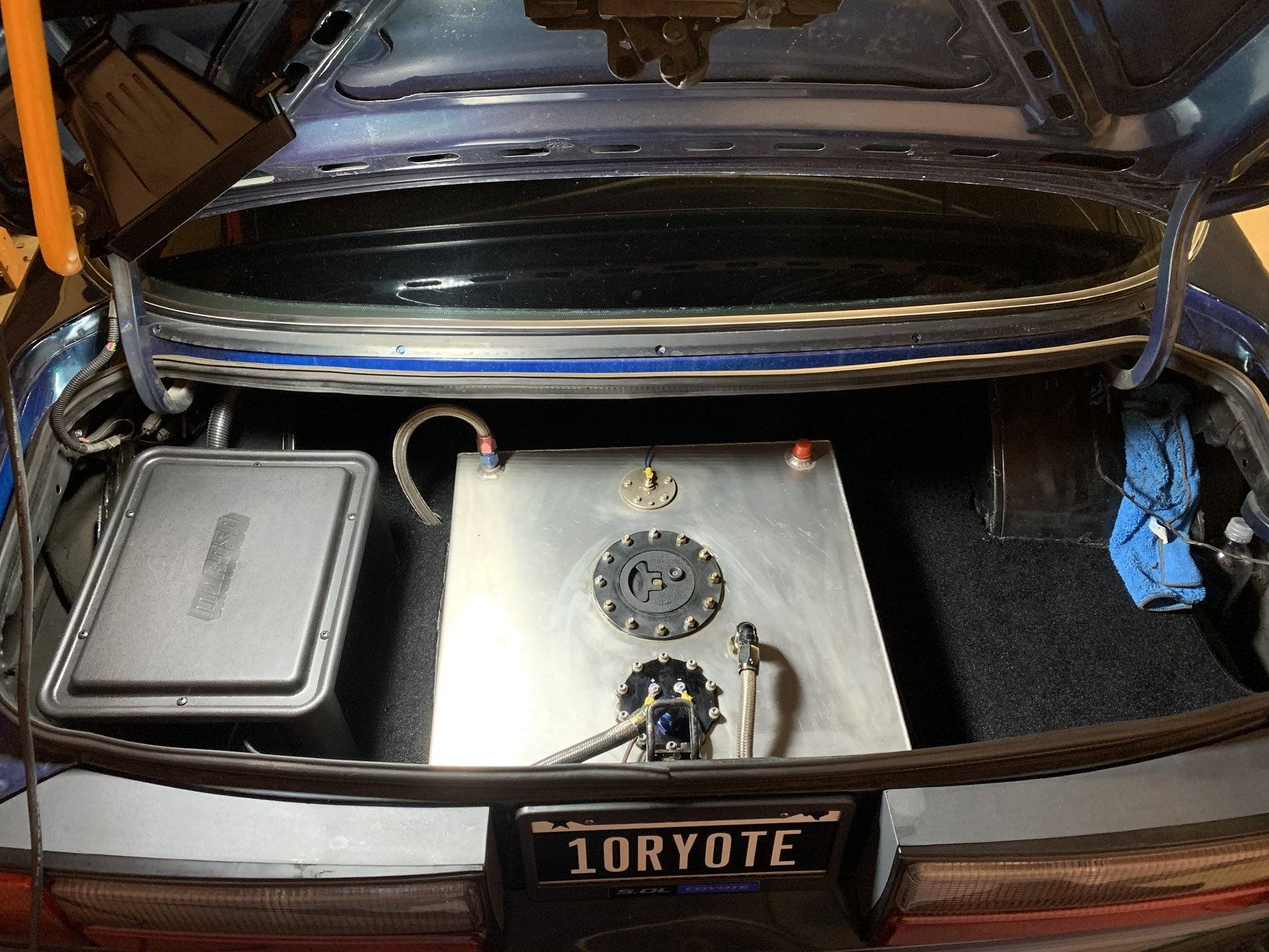

Feed it the E.
It is, have a barrel of E98 when the E sucks. Has a full return system, ID 1050x and a MagnaFuel 750. She good to go till 1,000rw
