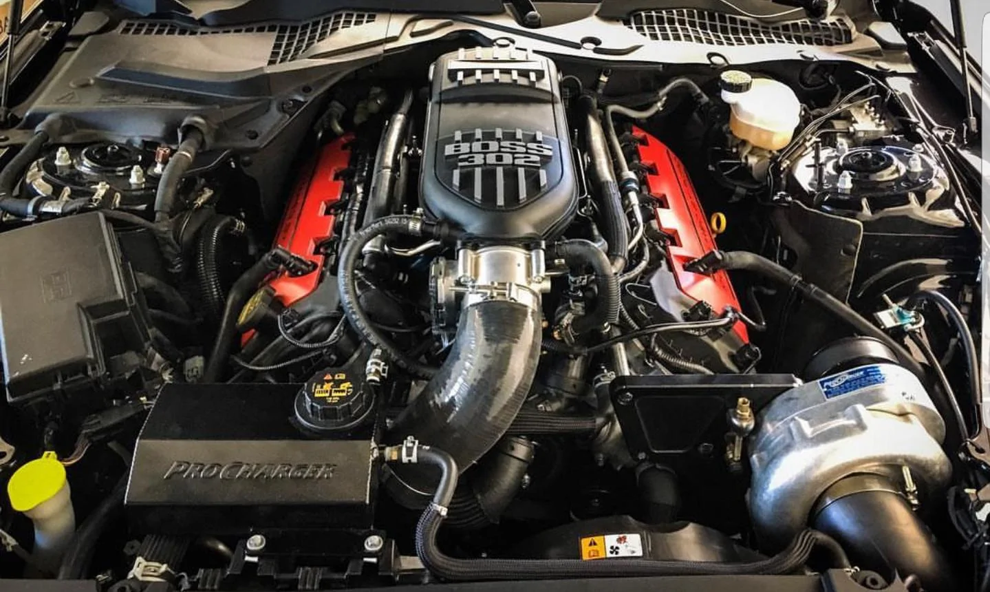

I would try to stay impartial, but then when I open my hood I see this....
