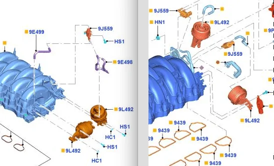

Here's a diagram comparison. 18 manifold is on the left, 16 manifold on the right. Part 9J559 is the imrc control module, 9L492 is the actuators. Purple and blue hoses are the vacuum lines.
Looks like the 18 uses one control module feeding three lines whereas the 16 uses 2 modules feeding 4 lines total (three from one and two from another)? Am I completely off base here in my non-caffeinated/weekend state?

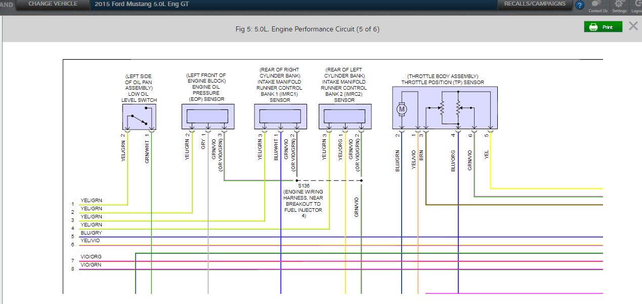

Here is some information.. This is the wiring diagram for the 2015 buddy pulled at work.
I only show 2 electrical connections on the diagram, and each being a 3 pin wire.. can anyone confirm?
edit: and google tells me the connector part number is WPT1261 pictured here
