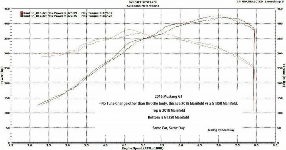

Can't see squat on that dyno graph.

Can someone post the results of tbe comparison at least..

Here. To small for me to read the graph.

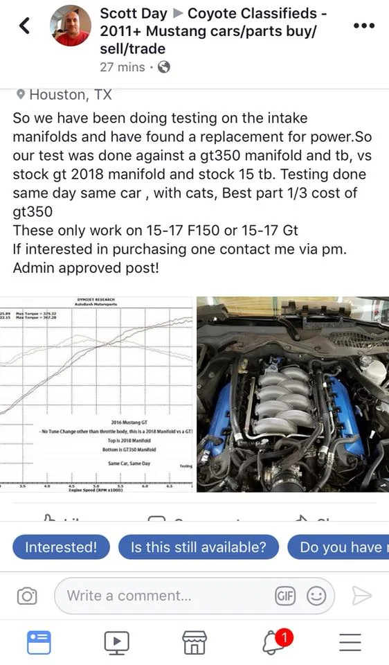

Just ordered mine. install is Feb 17th by Scott Day.
