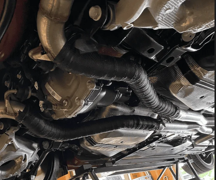

Nice job Tom. This alone has proved to make a difference for you, and I am hopeful that after the upgraded axles are installed, this will be the one-two punch toward preventing another axle failure.
AngelDeath
May 5, 2016
58
1,528
1,272
CH, New Jersey
'20 Shelby GT500 Rapid Red / '01 Metallic Red C5 / '17 White Overland
Not that this will ever apply to me, but how much could it cost to add a heatshield in that area to prevent this? I think its far more cost effective then claiming its a track car bound for failure at the track.

Thanks Tom. I am surprised they have heat shields all the way from the engine to the end of the driveshaft, protecting the trans and fuel tanks, etc. But nothing protecting the diff or the inboard CV joints…
We run flat out at COTA, but it’s mostly on the flat straights, and we only hit about 160. So I don’t know of anyone experiencing your problem.
However, makes sense to implement your fix to help diff longevity.
- How long are those pieces of wrap?
- It appears you placed 3 zip ties on each end?

I like the idea of wrap and have used it successfully on a number of different applications. It does tend to break down though with moisture from rain, etc, and continual heat cycles. No matter how tight or how well clamped, it eventually breaks down. It definitely helps though when used in the proper application.

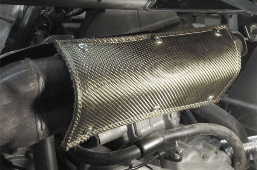

Lately I've been using heat shielding, ala the way the OEM's favor, with much success.
With respect to the area of concern in Tom's case, the exhaust tubing is low and in the undercar airstream. At speed, the flow of air is constant, which helps to keep things cool - generally speaking. When stopped or at very low speeds, that is temps can rise rapidly. Of importance, the CV joints are not seeing heat via conduction (the transfer of heat/energy from direct contact). Nor is it from convection (heat transfer within a fluid - the differential may see this though from hot gear lubricant). The idea is to protect them from radiant heat, where no physical contact is necessary. That said, I like the idea of heat shielding in this spot. It can be used with or without wrap.
I'm a huge fan of DEI's stuff which is what you see in the shot above. Without direct contact it uses air as an insulator and as DEI puts it the "outer layer is made from pulverized and stranded lava rock into a proprietary tightly woven weave for durability and strength. The inside material is made of a special high temperature resistant fabric (89% silica) designed to withstand 350 degrees more heat than glass fiber. This proprietary fiber technology combined with DEI's unique shield standoff bracket design provides an air gap between the shield and pipe that together provides the maximum potential for cooling and heat dissipation." It can provide heat protection up to 1350°F.

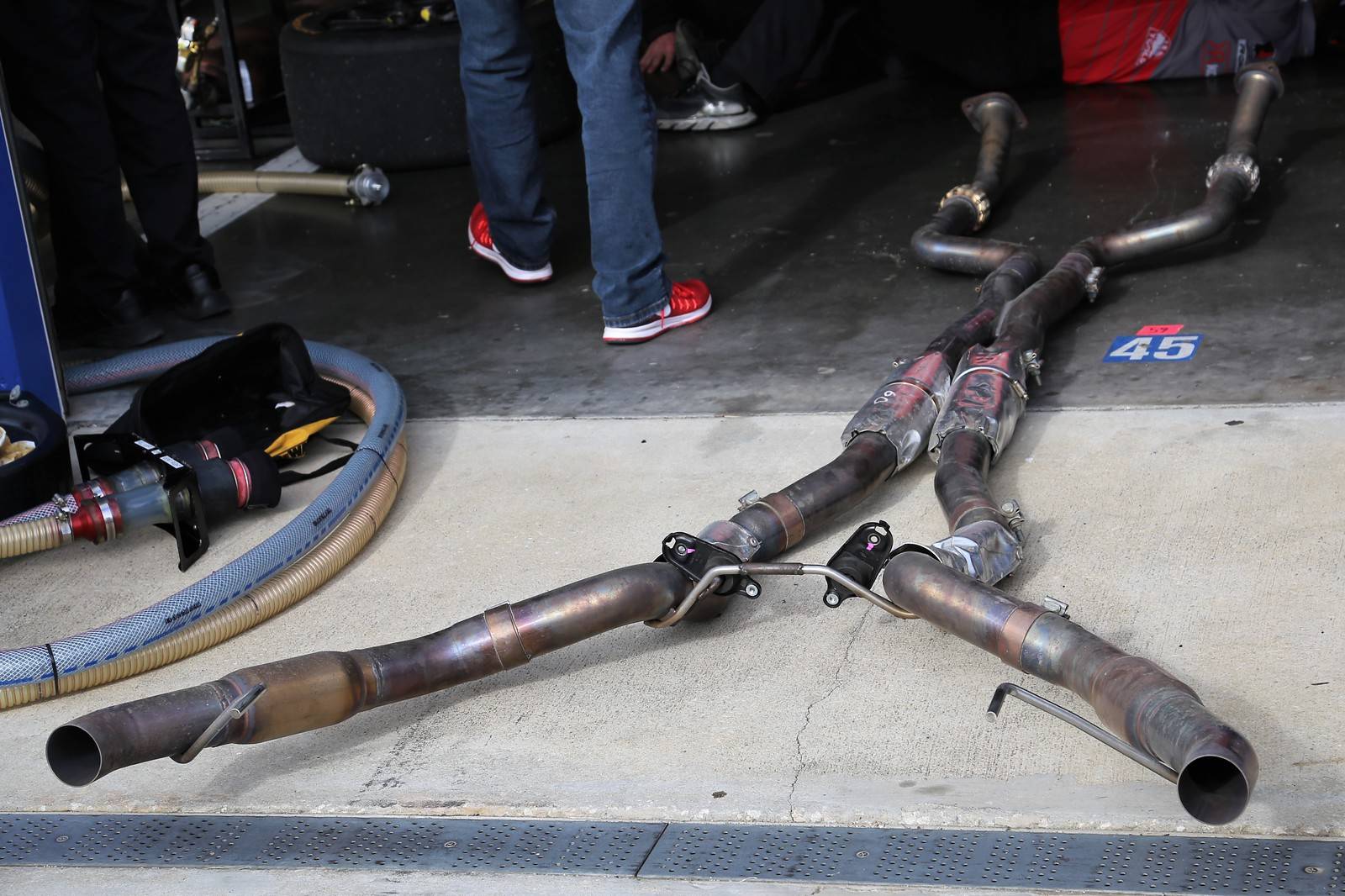

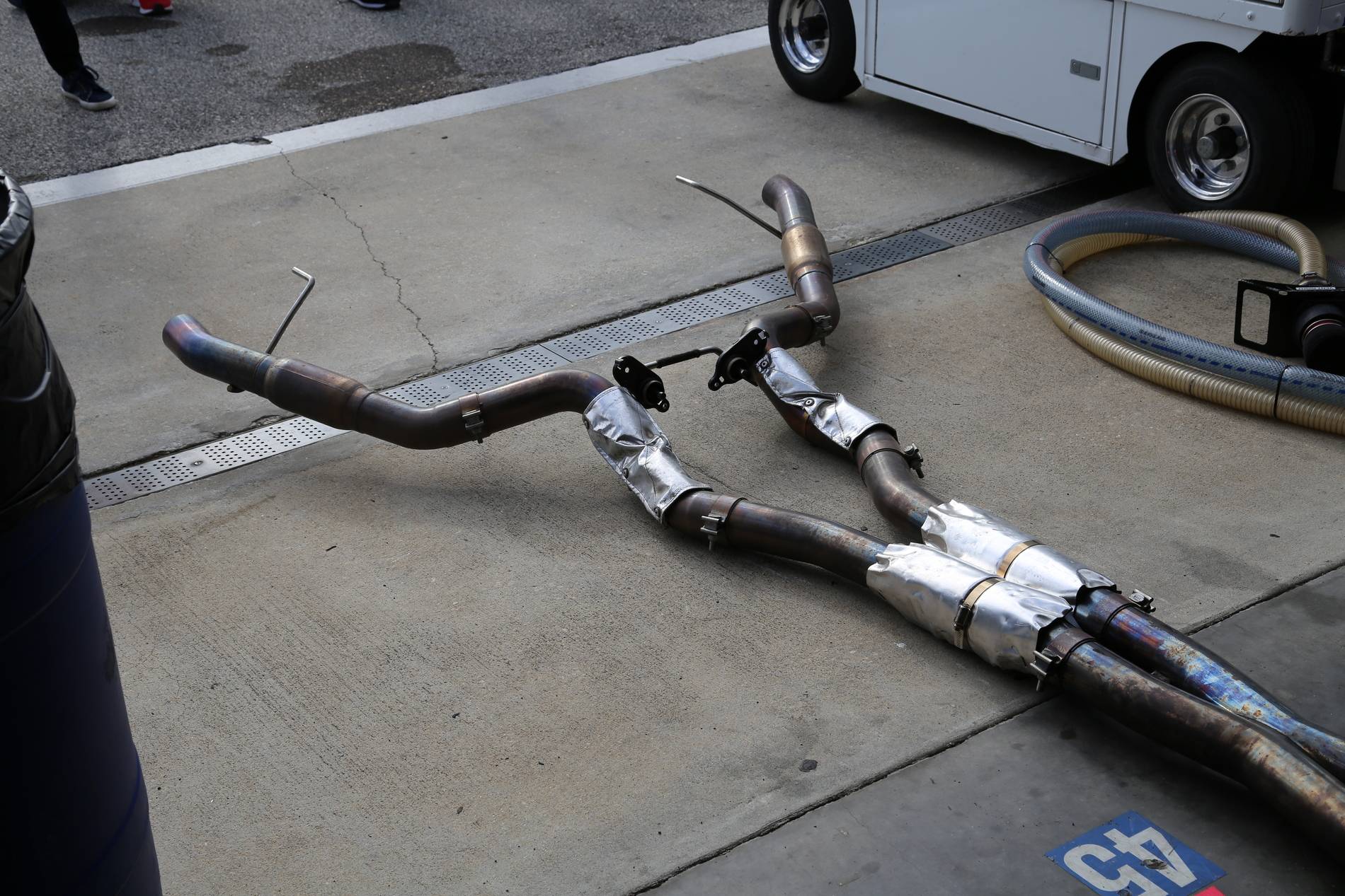

I was at Daytona with Kohr and they needed to swap driveshafts just prior to the race. I took a few shots of the exhaust system. You can see a foil based material clamped towards the middle of the exhaust but relevant to my point, look further aft and you can see shields clamped in place in the area that falls beneath the CV joints that we are discussing here.

You have to use stainless steel zip ties. Those look plastic.
Also, they make a silicon based high temp paint to go over the wrap to protect it.
Not, bought the kit & tool. Seems logical one should not consider plastic zip ties. For such an application & environment .
Did not know about silicon high temp paint, interesting .... tks
