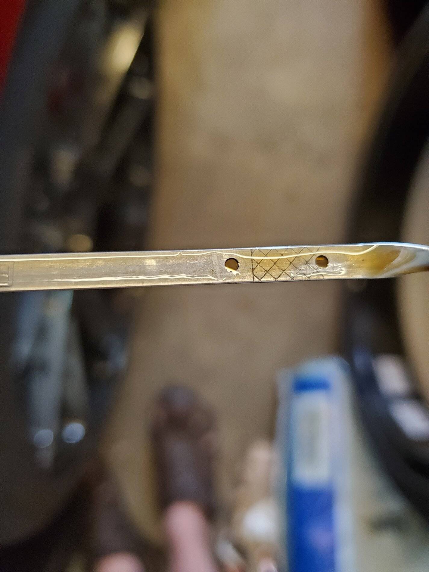

here is a photo of what 12 qts looks like after a track day. Oil is cold, so rule that out..... the oil level is hard to see, but it is above the hole. Before the track day, it was below the top hash mark line.
