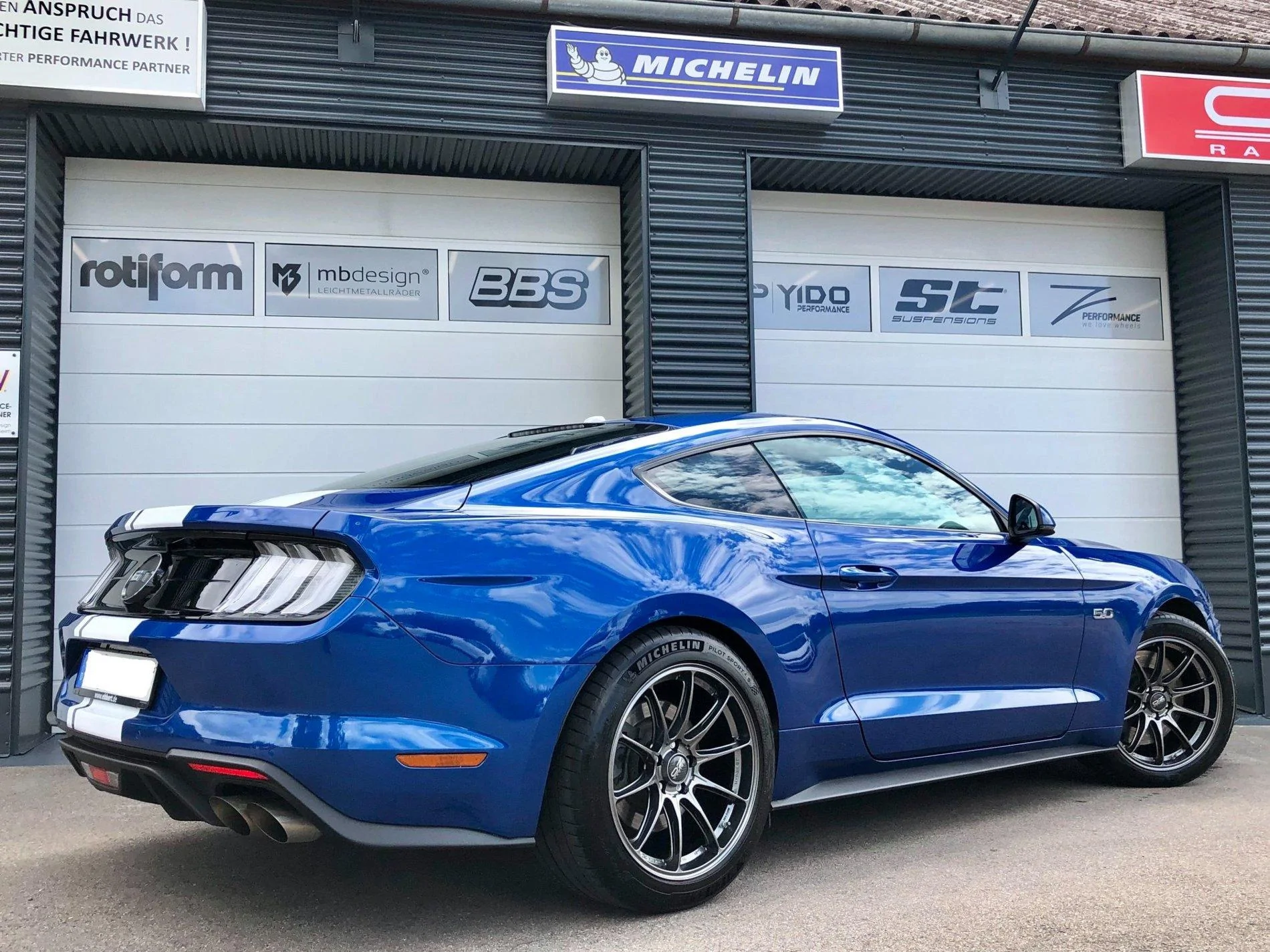

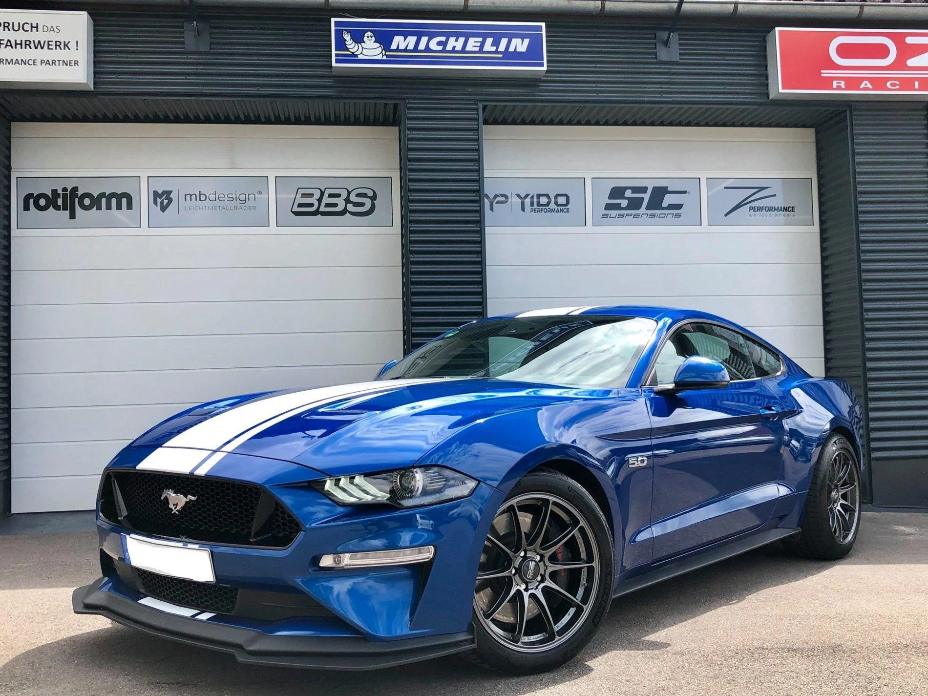

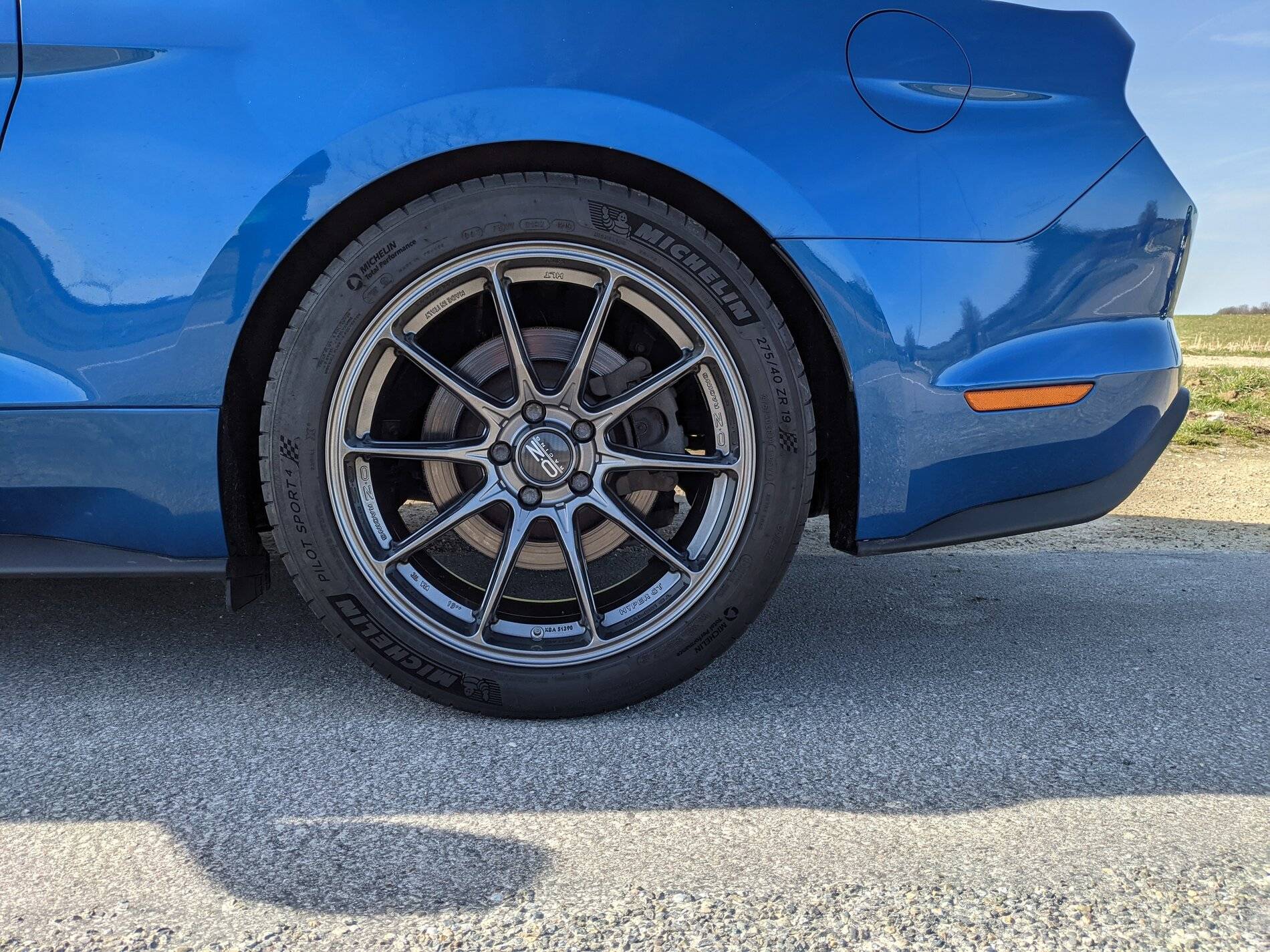

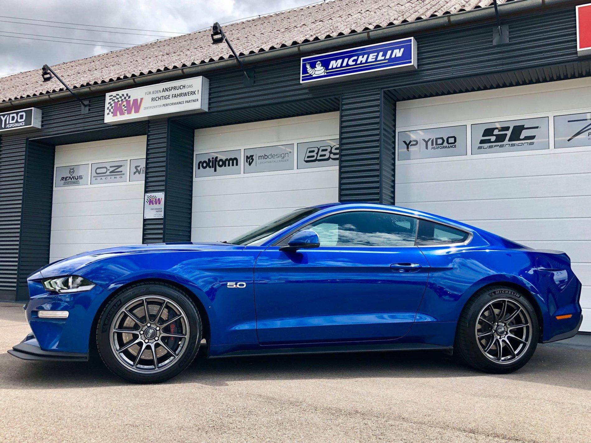

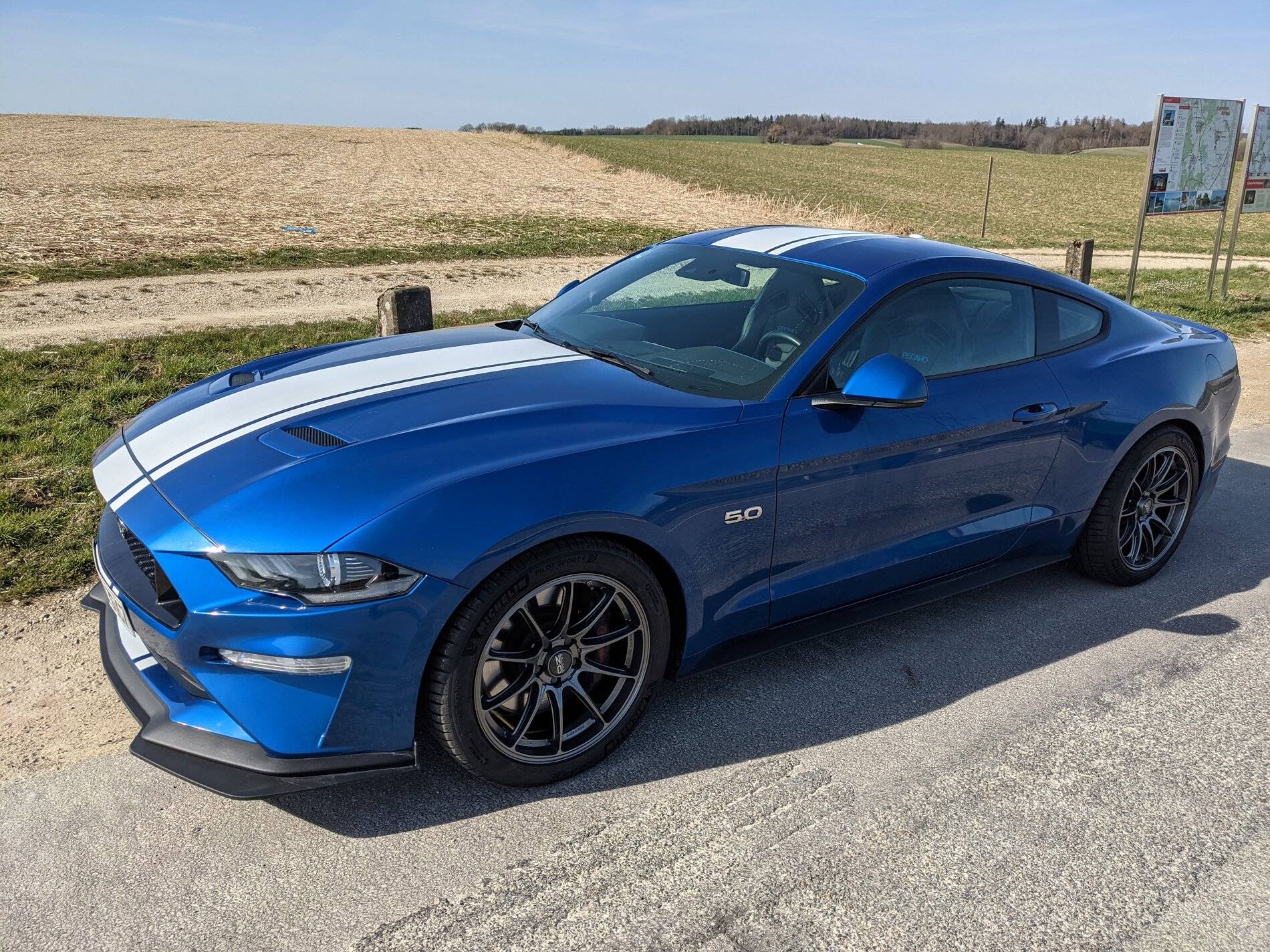

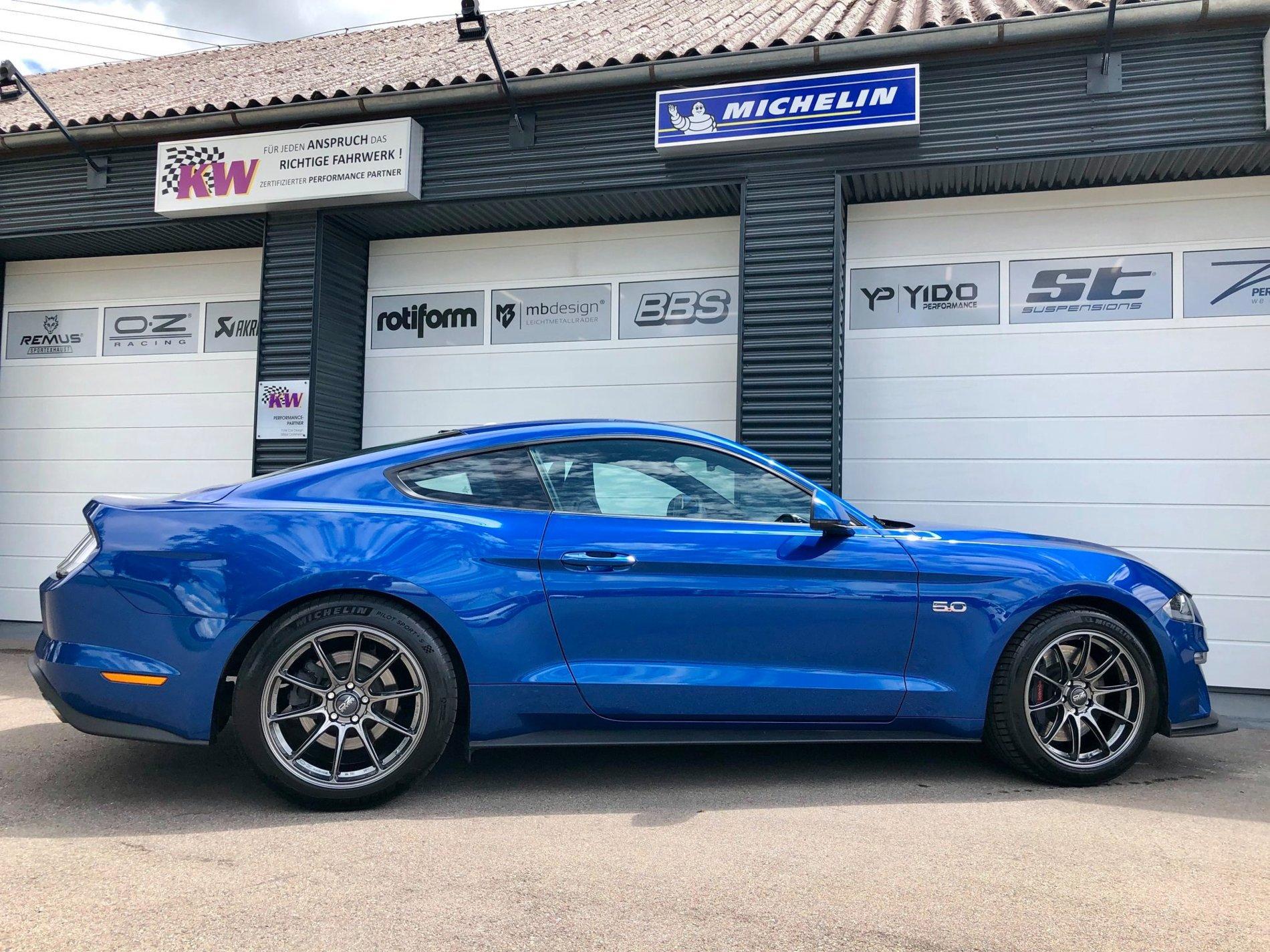

Hello from germany fellow ponyriders!
Wanted to show you my new squared setup on my 2018 GT with MR.
Wheels are OZ Hyper GT in 10x19 Offset 35 and come in at 10,1kg (22,3pounds)
Tires are new Michelin Pilot Sport 4 in 275/40R19 on the front, and for now the old stock Pilot 4S in the back.
I will switch to new 4 as soon as the back tires are worn out.
Camber is -1,6° Front and -1,8° Back
