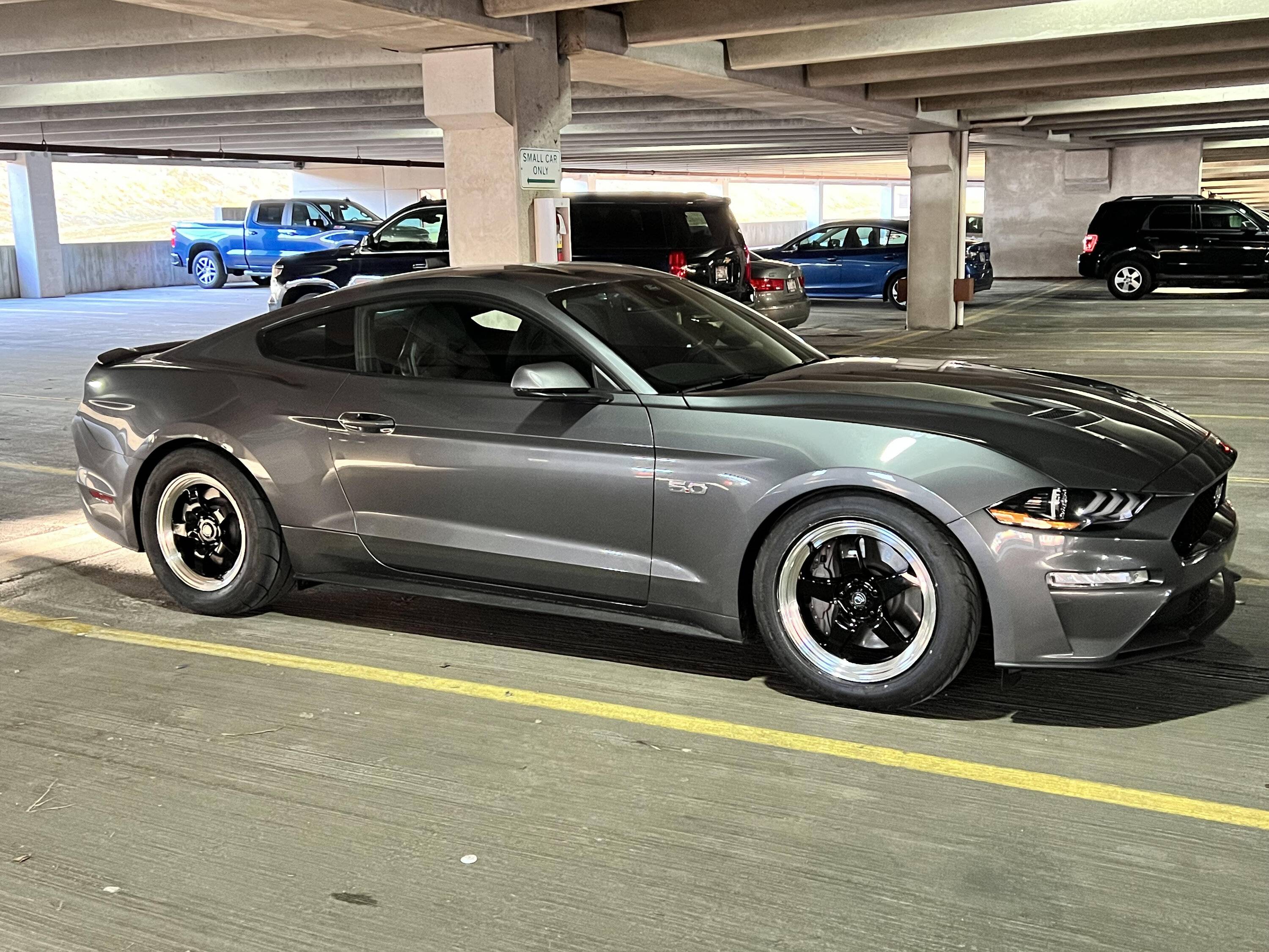

I'm planning ahead and need to make some choices about the 10R80 and how to either make it reliable or swap it out. My car recently went 9.3@153 so with that power level the stock one is not going to last long. I have a few questions:
1. I've been looking at rebuilds (Suncoast category 2) that add clutches and add the thermal bypass. Is this something that would make the trans reliable for a few seasons at ~900whp? I don't want to have to pull the trans every season..
2. I would like to add a transbrake to the car to help with the 60 foot (Centri car problems). Using something like the 10RStager, how hard on the trans is a transbrake? Will it shorten the life a little? A lot?
3. For the cost of a rebuild (Midnight performance quoted $5500) and a converter ($2000 through Circle D) I can be done with the 10R80 and swap to a TH400 ($7000 through JPC). Is this the better choice?
Looking for any input from some of you guys that have gone fast (touching 8s would be nice). What do you recommend or what did you do that you liked/disliked.

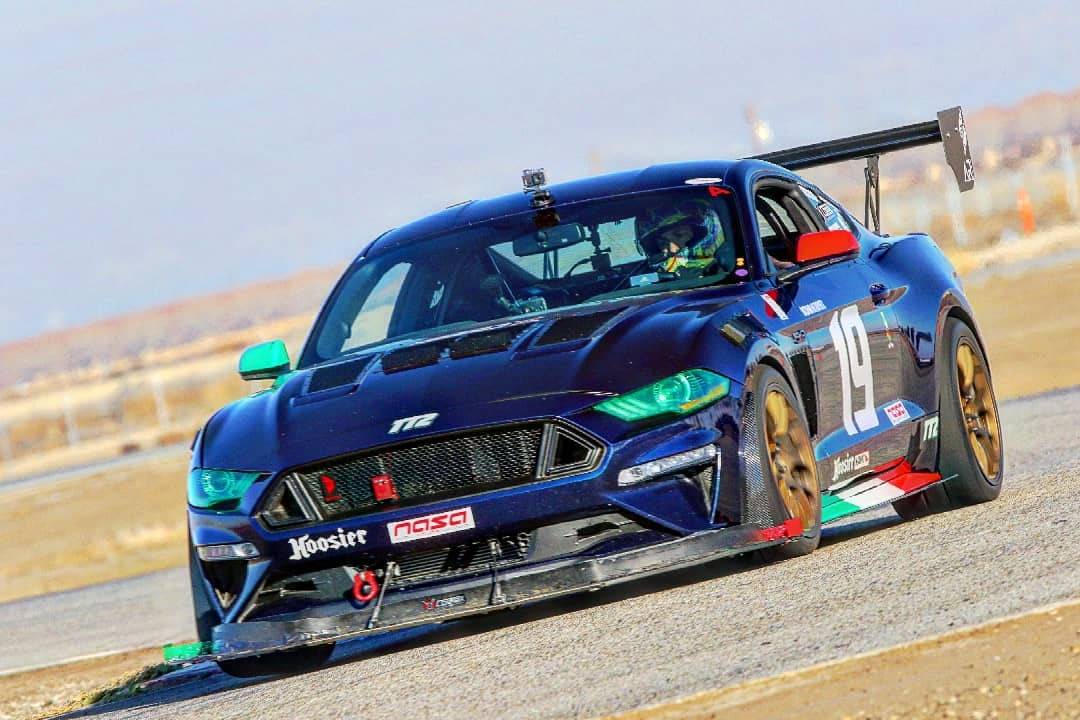

In my roadcourse racecar i have a setrab 934 cooler thermal bypass and base aftermarket clutches (not bigger capacity)
I lost 2 trans already (im at 17k miles) because too hot and after i fix the issue of overheating... I ran too low fluid damaging the output shaft (no lubrication)
So It is smart to be proactive...but..the more you are the more you pay. Although 10 speed is definetely a great trans for your application.
One last thing..more a side note
Many of you drag racers are not considering the Aero elements you could add to reduce drag.. and at those speeds every detail counts.
I'd like to know if u have any aero elements in yours :)

Thanks for the reply. I was looking at the suncoast category 2 or 3 depending on if I wanted to use their new valve body. sounds like that might be a good choice.
I have no aero updates to my car. The exterior is factory stock.
