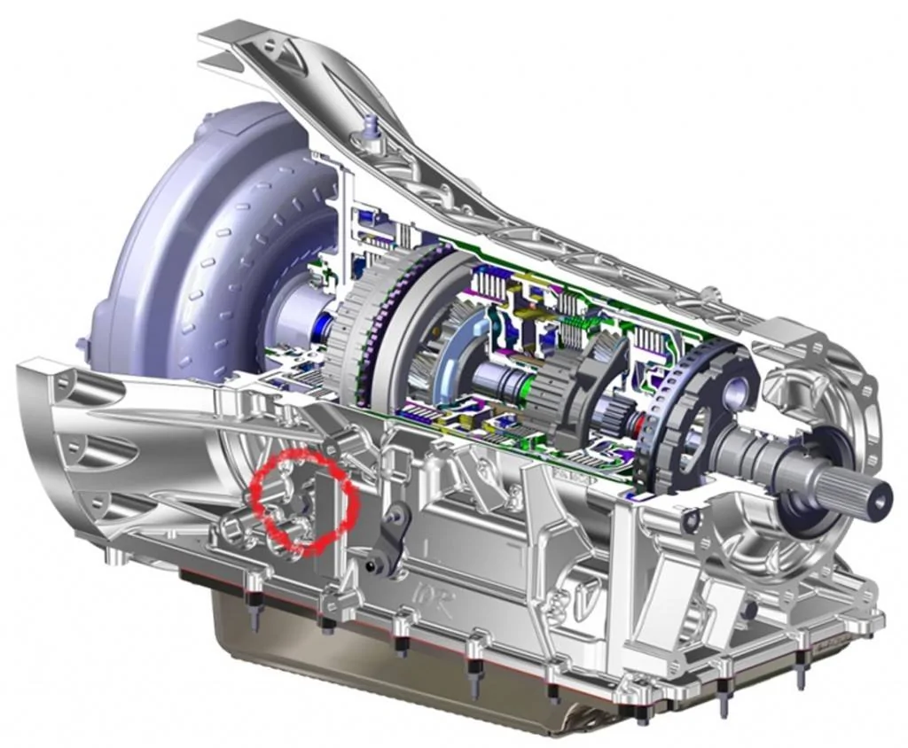

Does anyone know if this hex head reveals an open port to the inside of the transmission case? I want to add an external cooler and put the cold atf back into this hole.

In my main huge 10R80 Facts thread, there is a video of a complete tear down/rebuild of a 10R80. I’m not sure if what you’re seeking is in that vid, but possibly. Go to Page 1, Post 1 of the thread and scroll to the bottom for the vid.

Yes me too! There is a port on the back of the A10 up and left of the prop shaft. I do not know if I can dump cold fluid back there. I found the one I inquired about is a pressure testing port so I can't use that.
Even with bypass open the A10 gets too hot. Too big oil cooler and trans cooler up front dump hot air on the radiator = Car No likey!
So trying to add yet another trans cooler at the rear draining hot from pan and putting cold back at dipstick hole as last resort.
