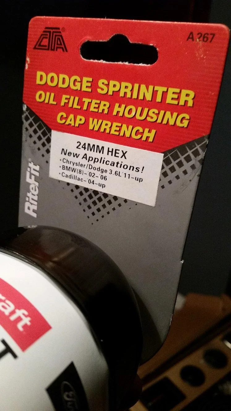

There isn't much room to room to remove the oil filter so I recommend a 76mm oil filter cap that you can attach a small socket wrench to.
Hmmm, I bought a different oil filter cap wrench that fits perfect.
74.5mm, 14 flute
CTA A267 from Pep Boys
