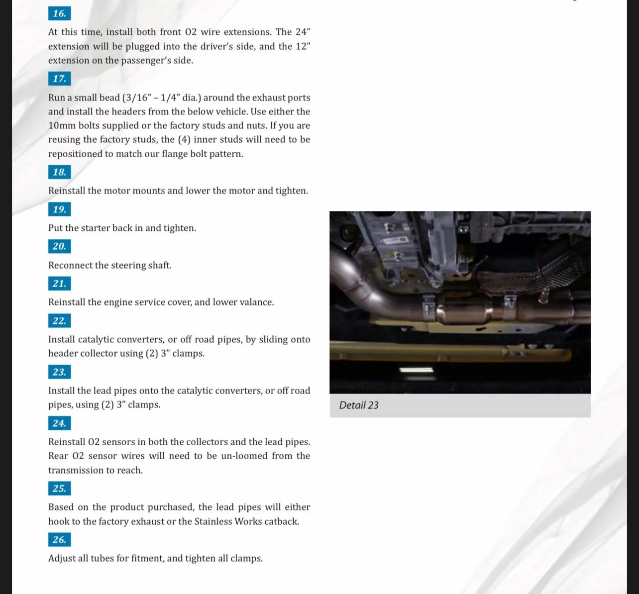

So I bought a pair of stainless work long tube headers and it seems that it needs some 02 sensor extensions to properly fit but I cannot seem to find them absolutely anywhere online and no one has seemed to mention it do regular gt sensor extensions fit or Is there something I’m missing

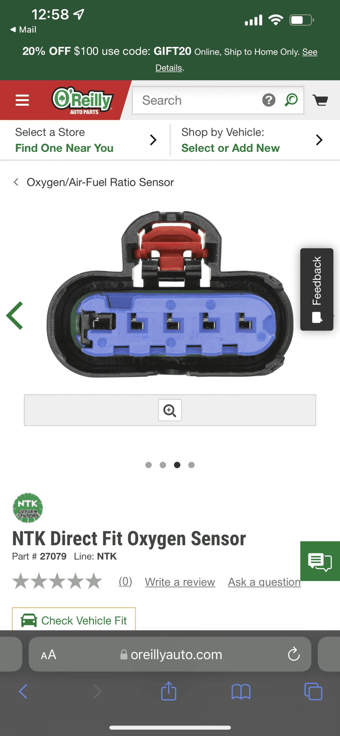

Skip extenders and use NTK 27063 sensors. They have longer leads eliminating extensions. Search the NTK 27063 to learn more, also search F-150 O2.

Skip extenders and use NTK 27079 sensors. They have longer leads eliminating extensions. Search the NTK 27079 to learn more, also search F-150 O2.

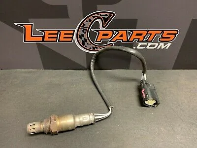

Those do not look like they have the correct connector the gt350 has this connector the Ntk has the blue connector

It’s the precat sensors I tried to look on the forum and it doesn’t seem like anyone has looked up 02 sensor extensions for the gt350 on stainless works pdf it’s says I need two step number 16

The 2018 mustangs have the blue connectors and the 2015-2017 have the white connector my thought is that it uses the 2015-2017 mustang connector instead of the 2018 connectors
