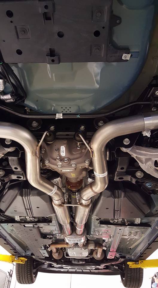

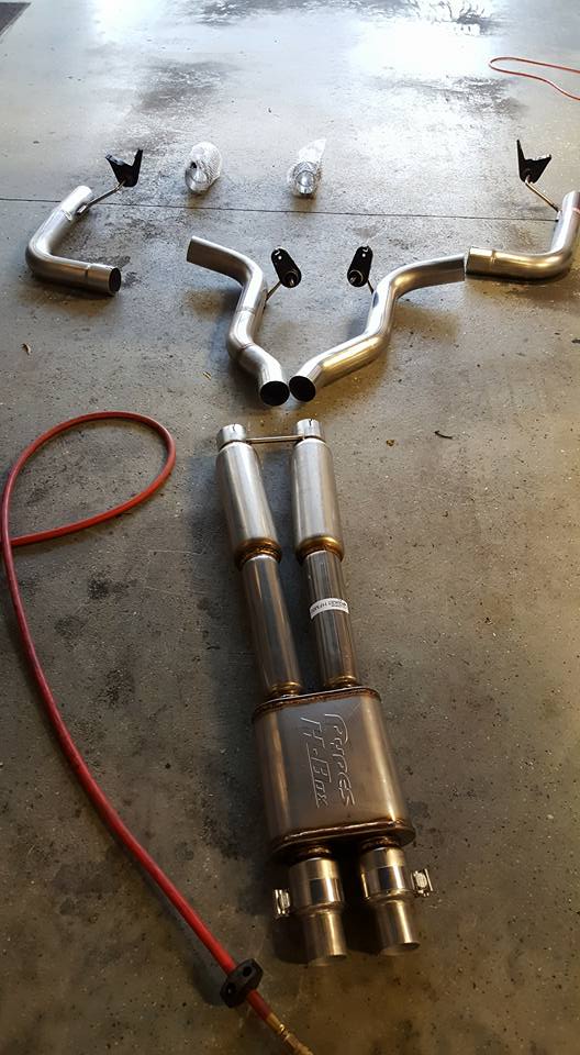

Started off with some suspension items and of course exhaust... Looking for 830-850whp on stock block and e85 with only an OPG- sprocket upgrade and hopefully 9.30-9.50's in the 1/4

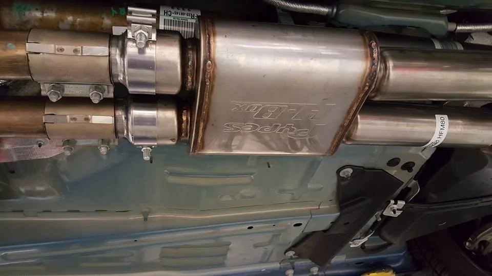

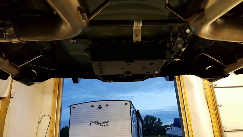

some from the exhaust install, I like the deeper tone so went with an H over the X

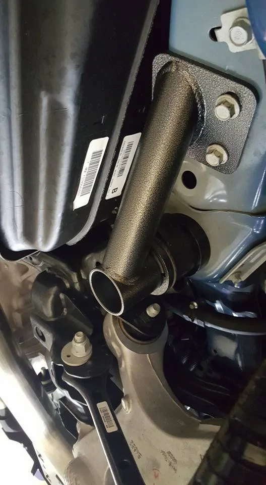

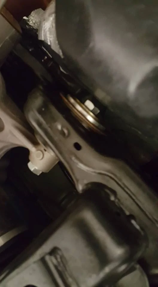

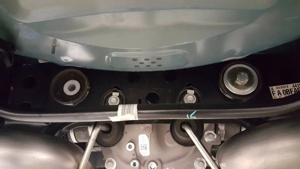

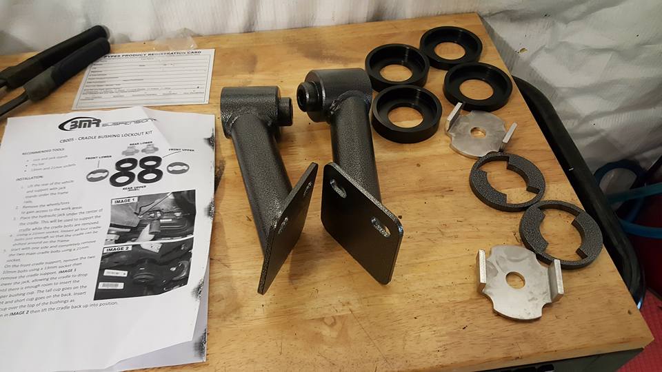

some from the bushing lockout kit both cradle and diff.. front diff lockouts were a PITA, def had to put some leverage on the cradle.. they say the steeda solid lockout kit adds alot of NVH... I don't think so, all I noticed is a tiny bit of audible gear whine now and a little more noise when going into gear, thats it!

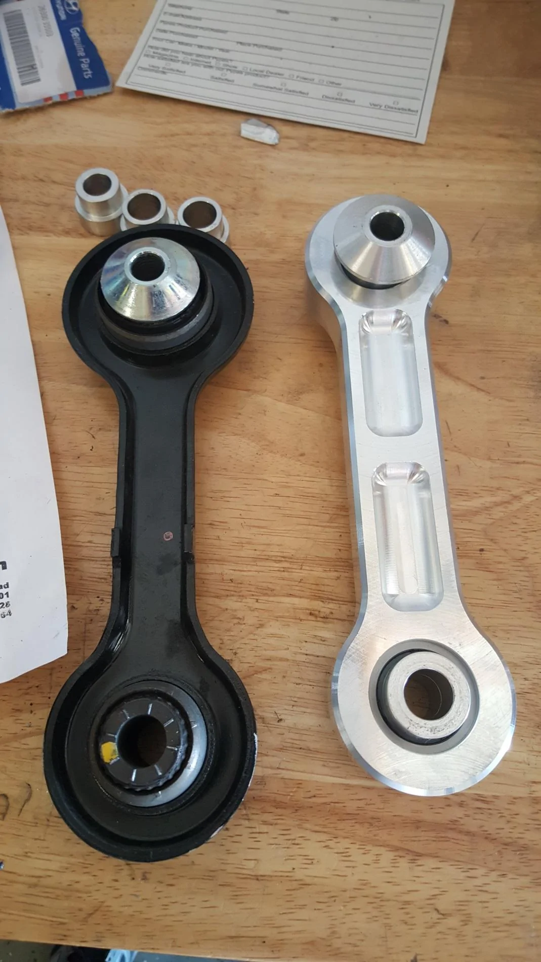

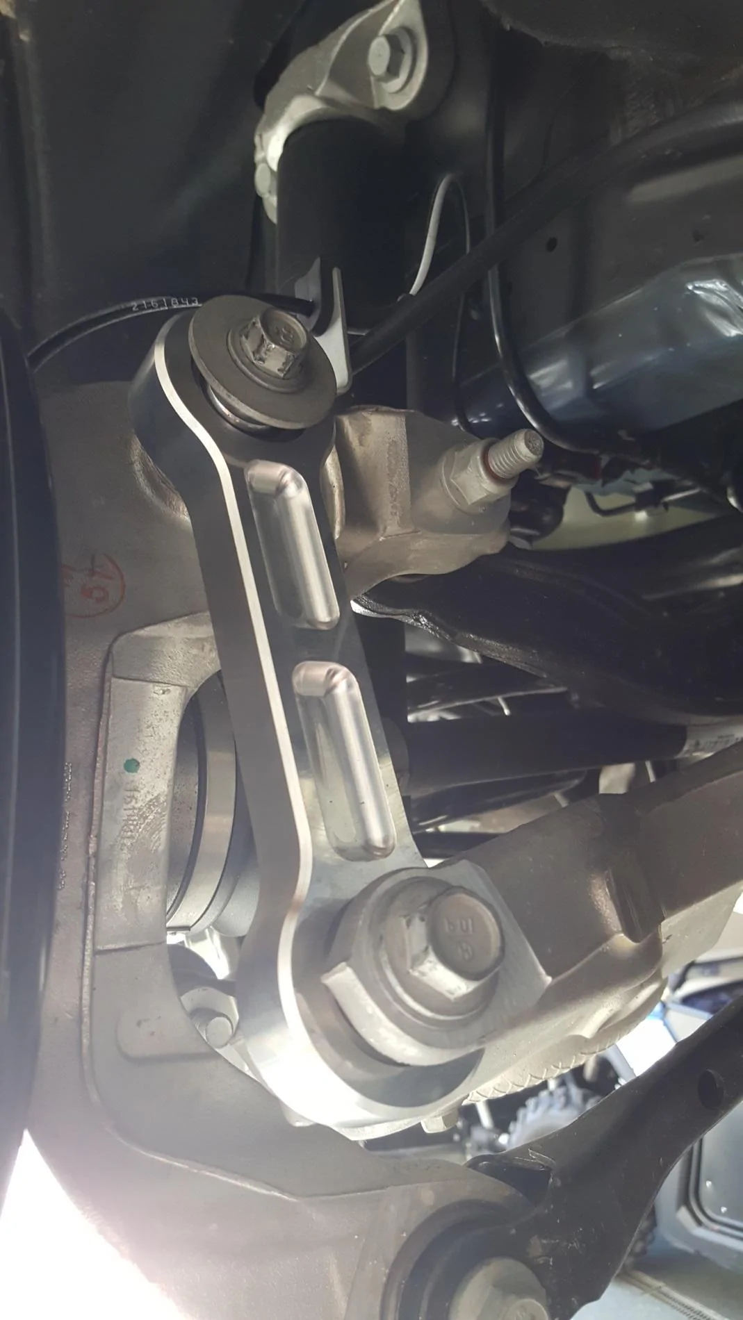

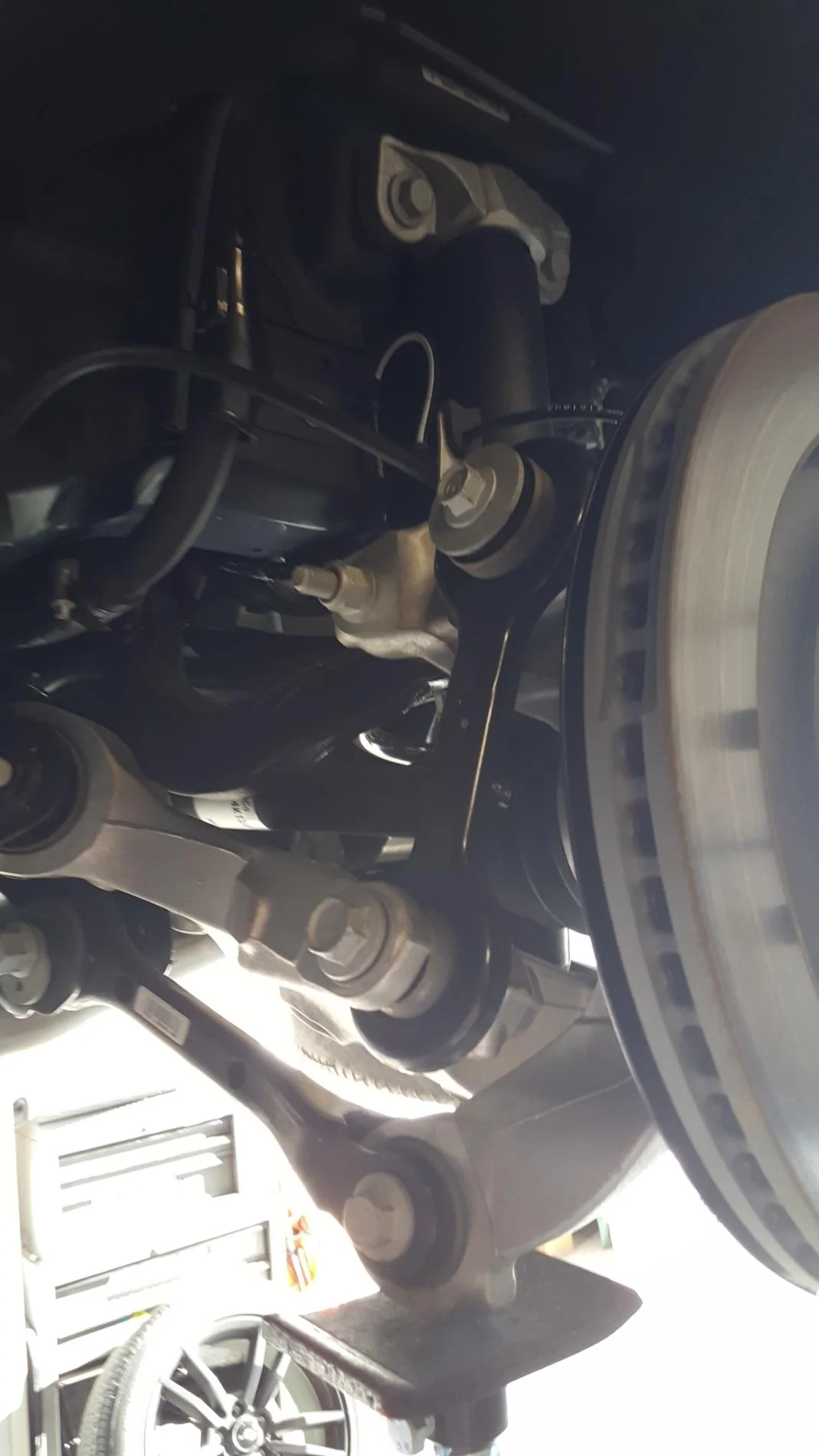

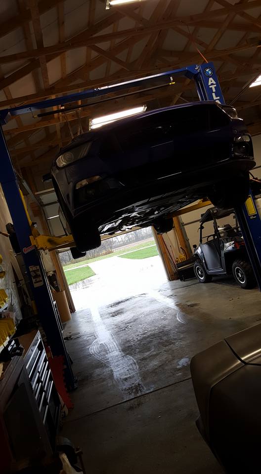

Just installed the J&M vertical links today, super easy like 30 mins for both, the wheel hop is pretty much gone, just spins the crap Pirellis a little bit

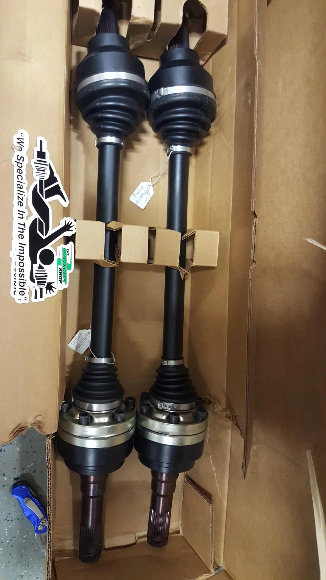

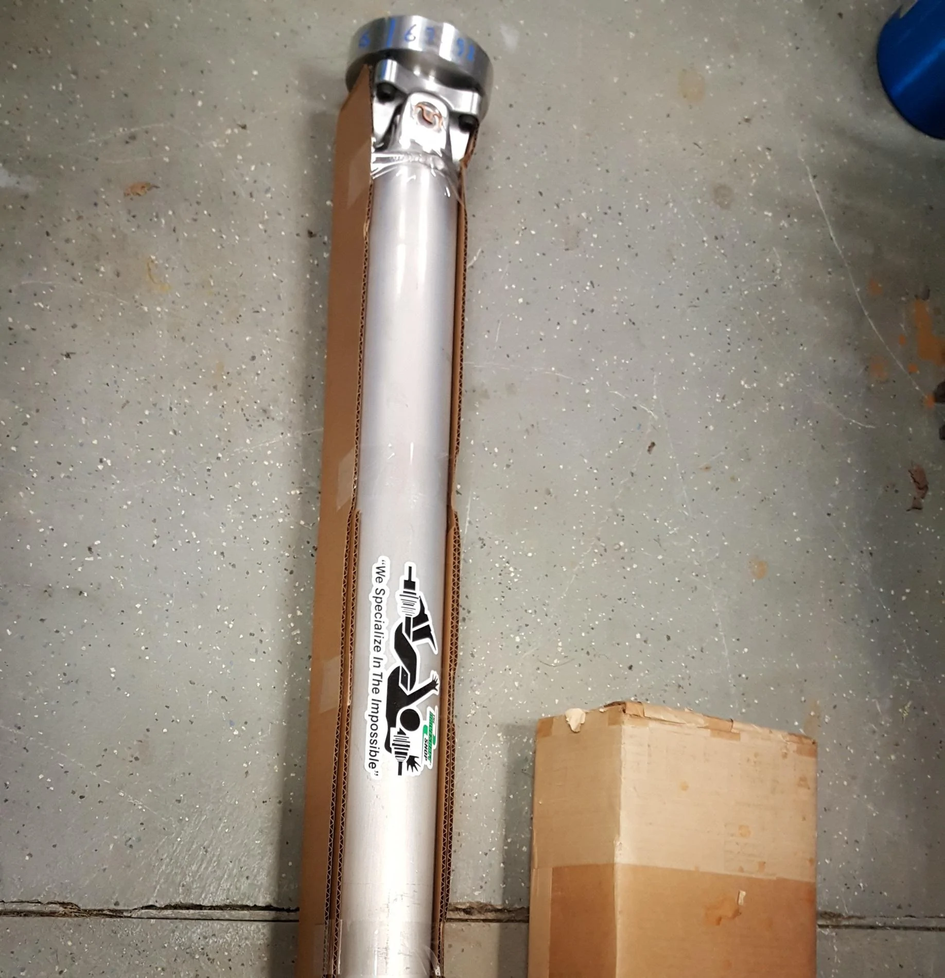

DSS aluminum driveshaft and 2khp axles

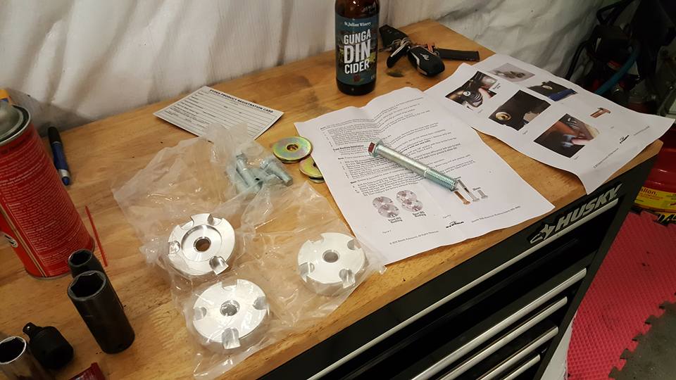

Steeda cradle alignment kit along with BMR drag springs and viking Warrior rear shocks

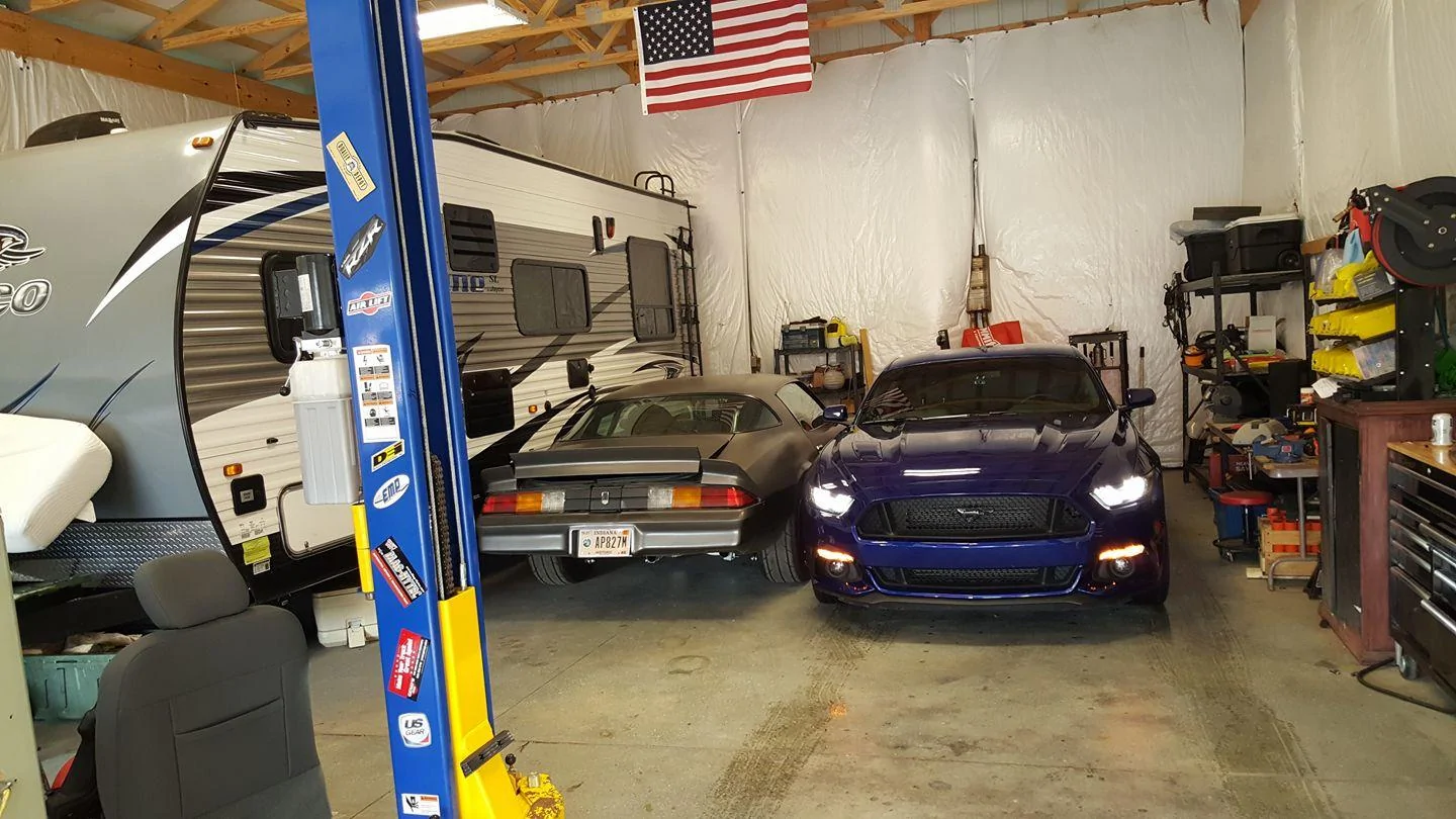

Bunch more stuff showed up, unfortunately stuck in a lake effect band today so have all of the vehicles in the barn with not much room to work.
Think I will start off with the Axles, rear drag springs and cradle alignment kit first since those can pretty much be done in one shot.[/ATTACH]

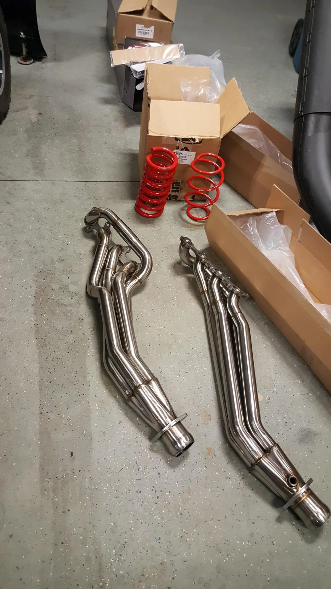

Team Beefcake had a killer price on these pypes headers and should mate up to the Hbox catback I have on already with full 3" to the back and no neckdown

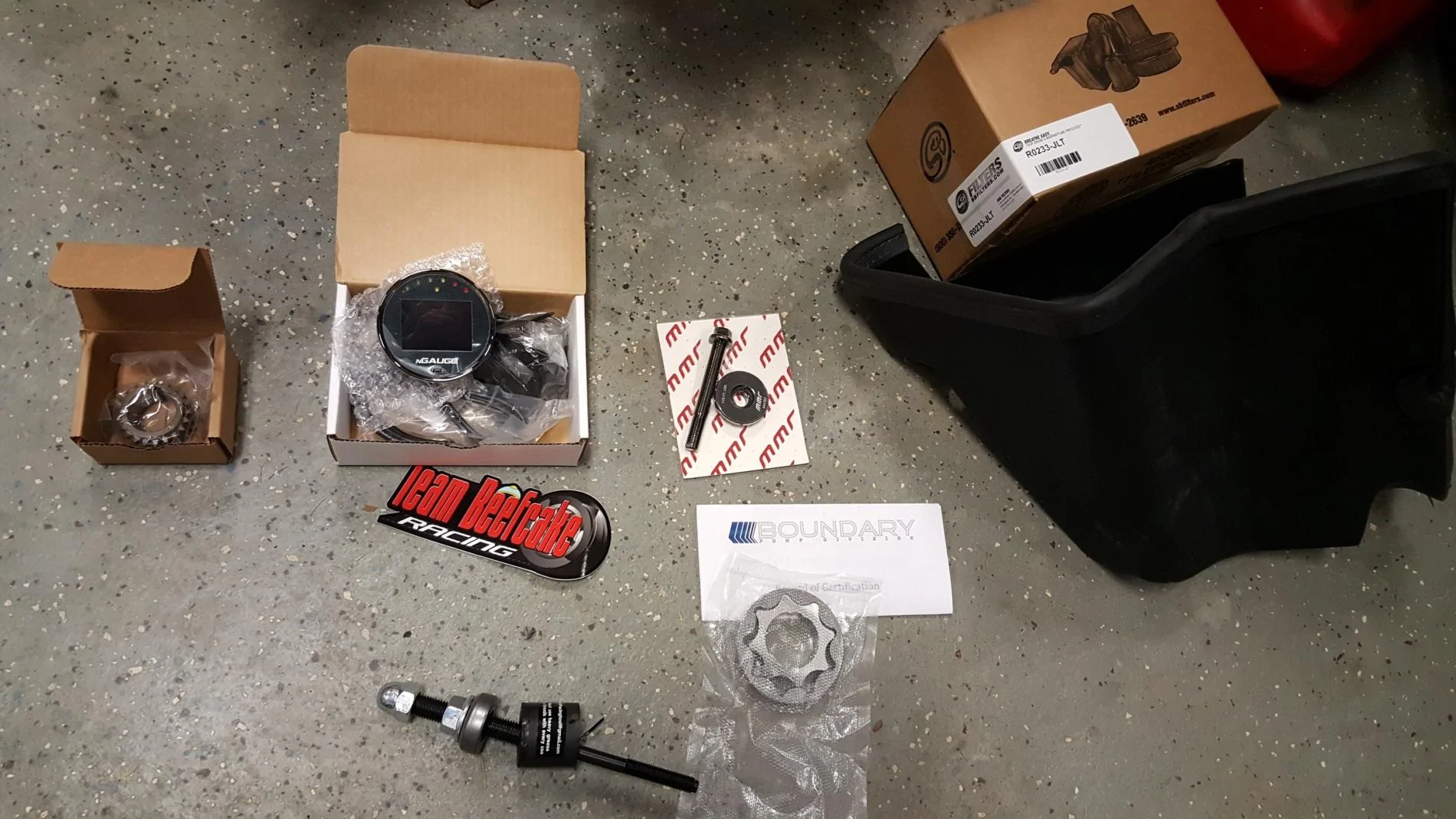

JLT intake, Boundary OPG, MMR crank sprocket, Ngauge, balancer tool

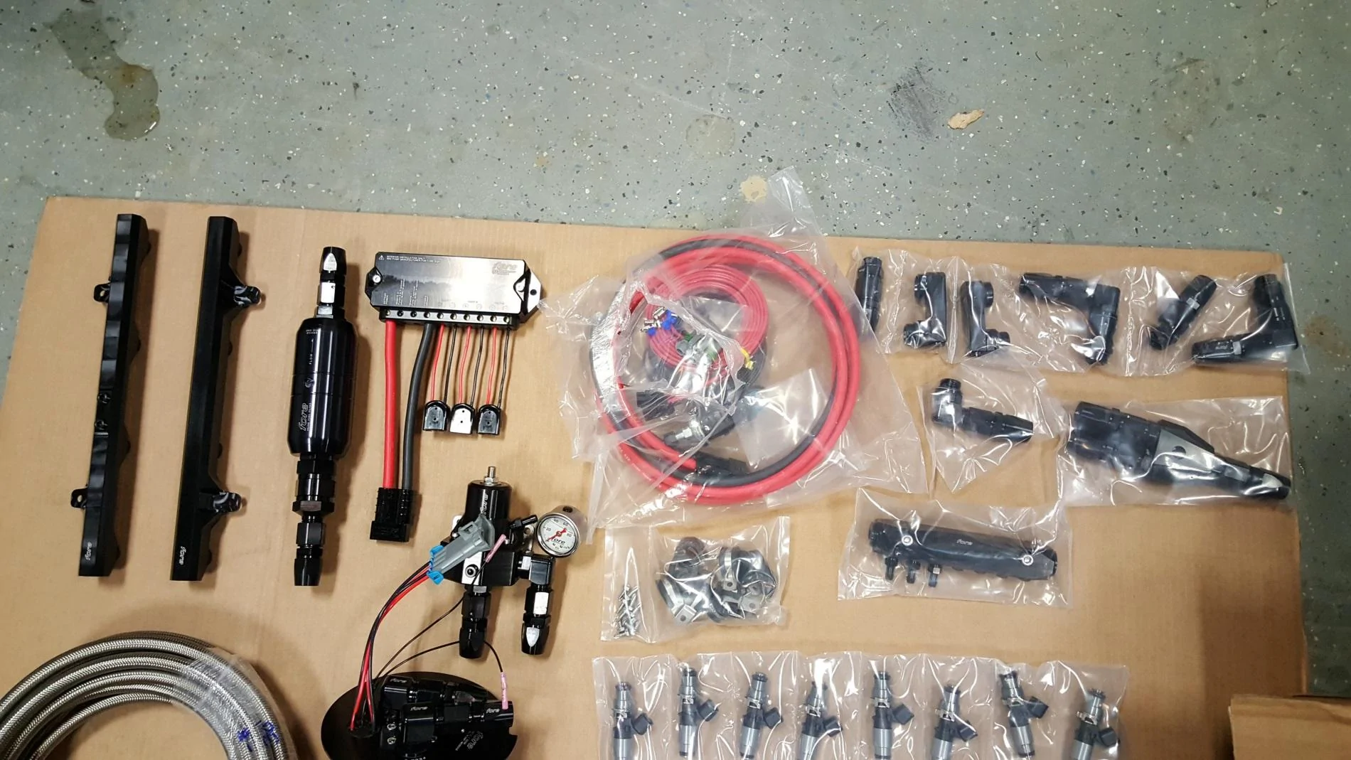

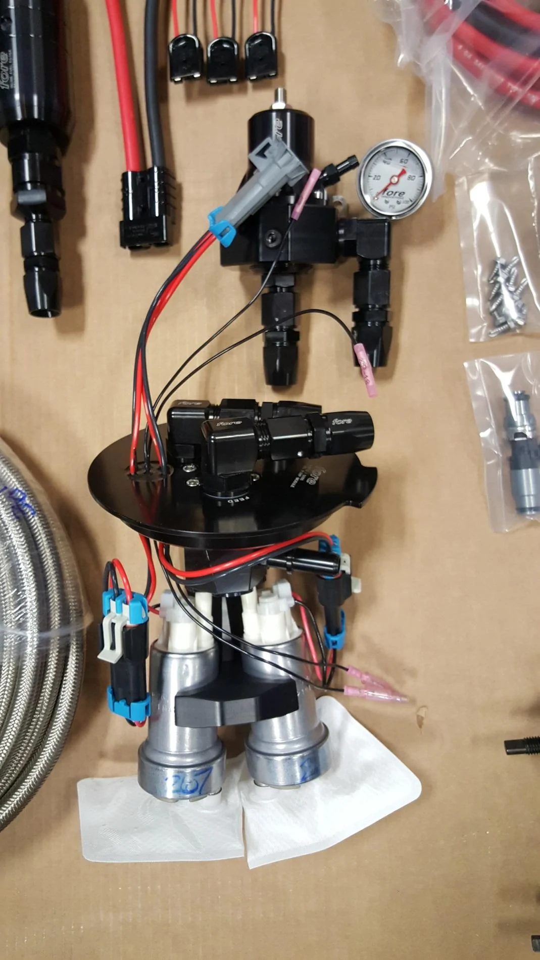

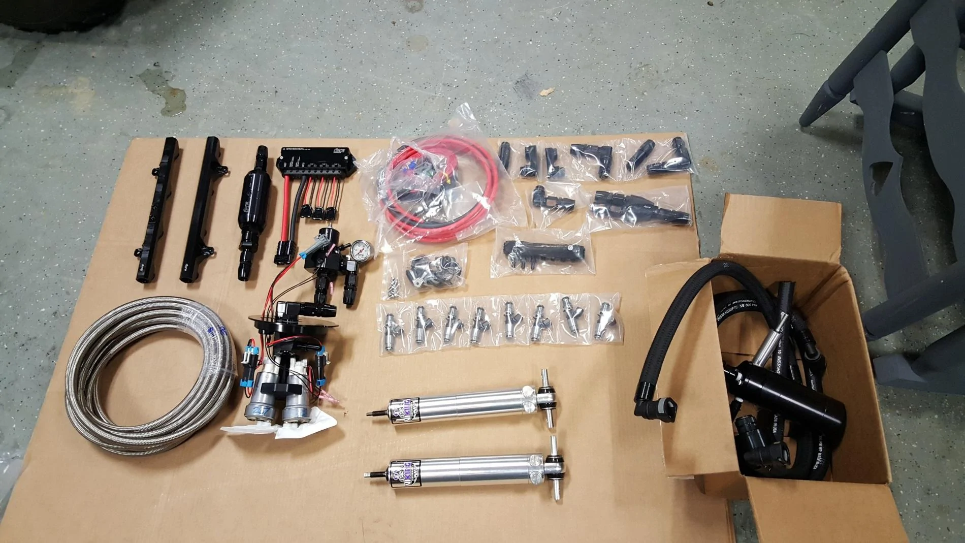

Fore level 4 return fuel system, dual TI pumps, FC3 controller, rails, etc etc.
Some pricey stuff but the quality is definitely there, did not want to skimp on the fuel system.. UPR plug and play catch can and Viking warrior double adj shocks. I like how Fore is constantly making changes for the better on these kits.

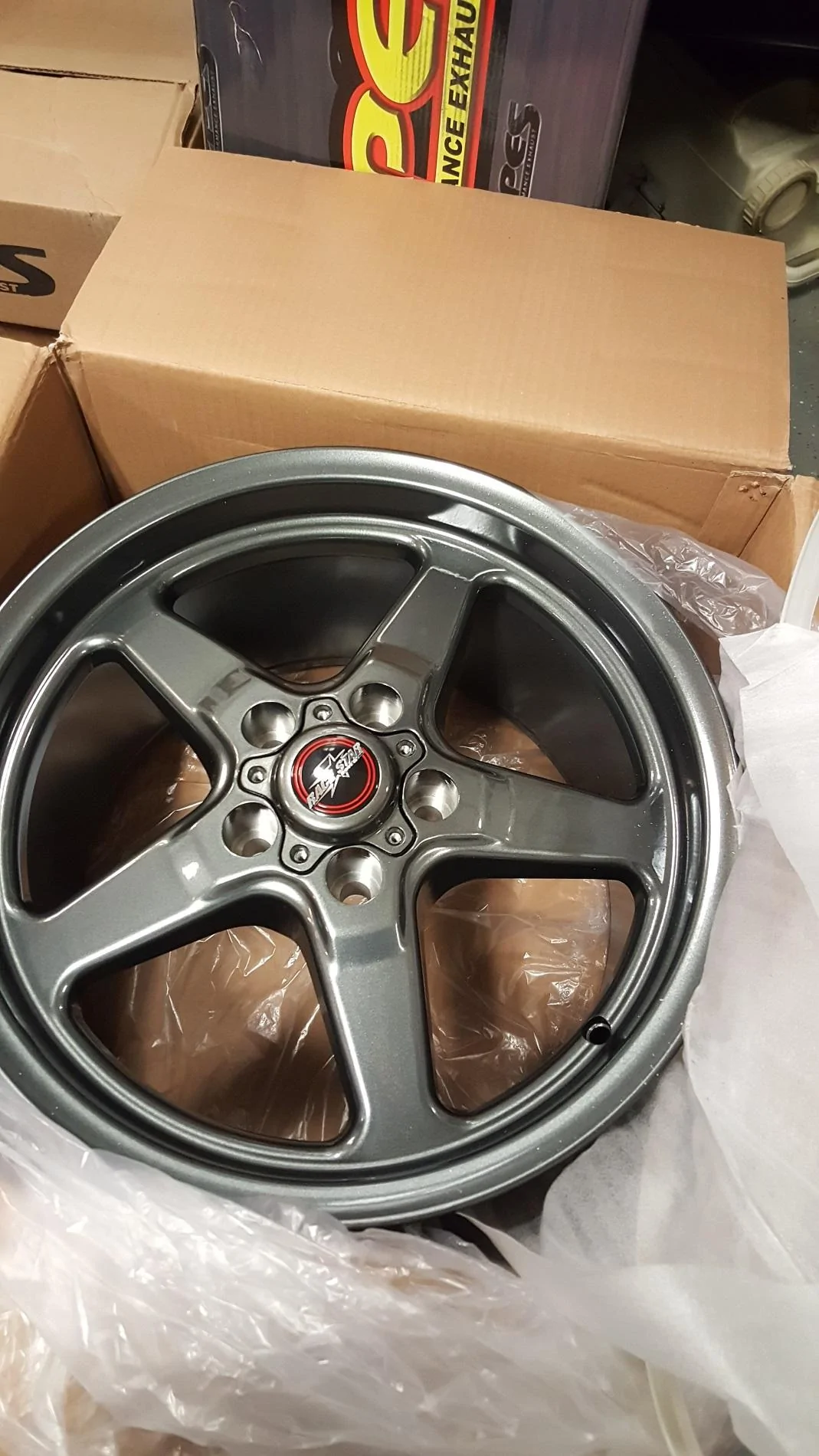

Also picked up the Race Star Bracket Racers 17x10.5 and 17x7 , Beefcake had a good price but Summit was the same and had a bunch of Summit bucks I had to redeem before they expired. I like the black as I have them on the Camaro, but these saved a bit and still look good
