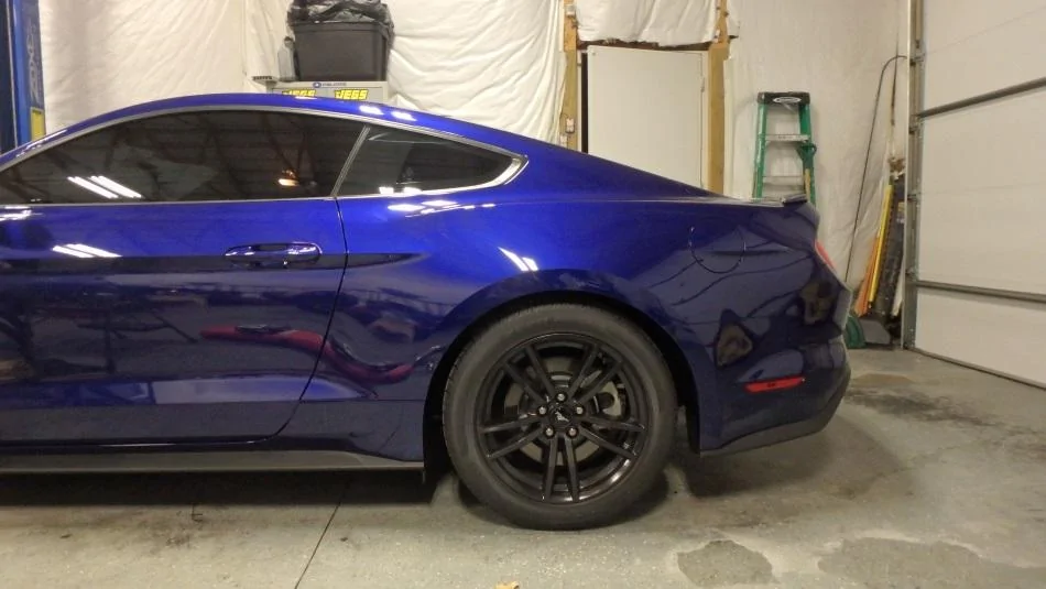

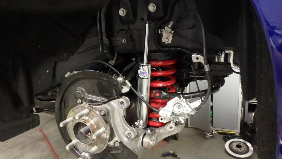

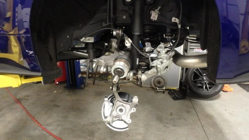

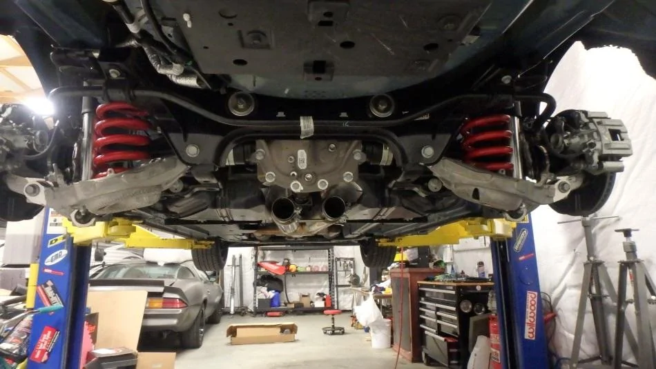

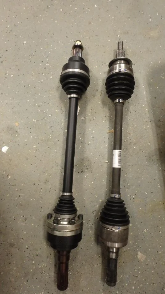

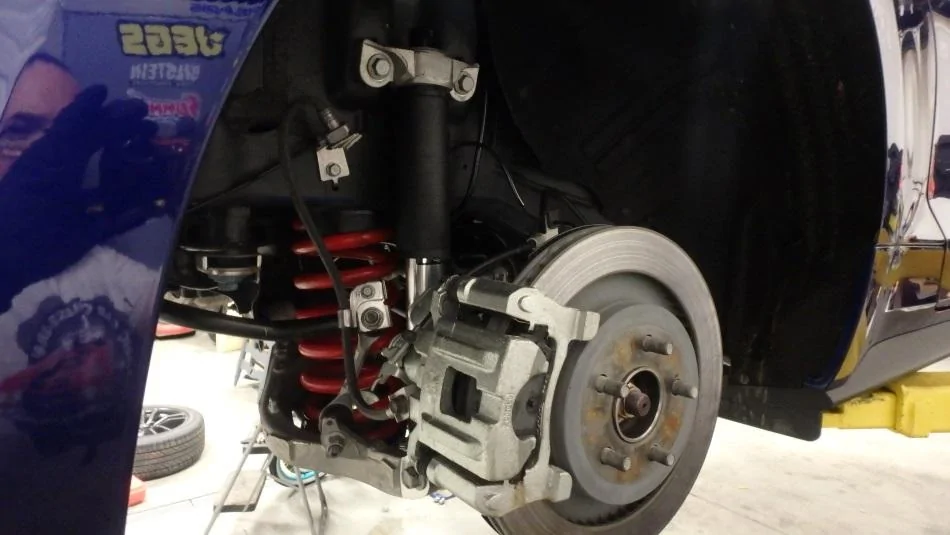

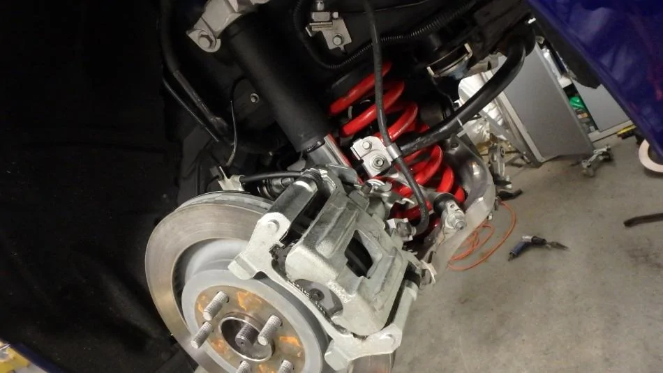

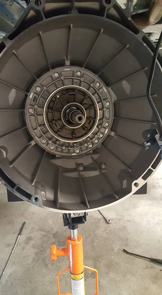

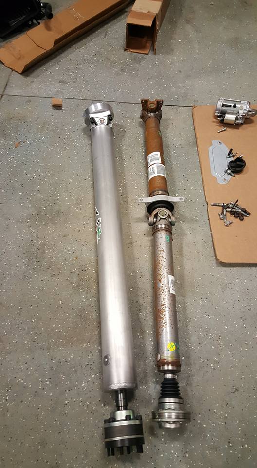

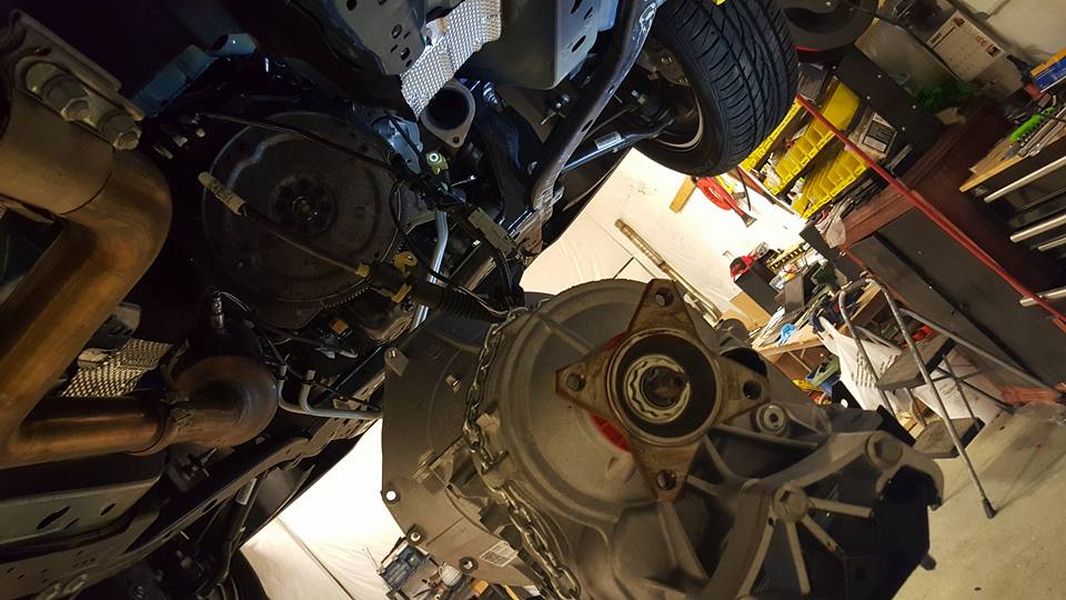

Got some of the stuff installed myself yesterday.. Decided to do Axles, rear portion of the BMR drag springs and Viking Warrior shocks all at once. Went pretty smooth except the almost 2 hours fighting to get the d/s axle out with pry bars. Would not budge. Had amoment of clarity, went to Autozone and rented the slide hammer and axle adapter and bam came right out. Jacked up the outer ridge of the seal but the inside seems ok. Took it for a 10 mile drive and is still dry. We will see how it goes after a highway drive. I needed it moved off the lift and cant wait 5 days for a seal to show up.

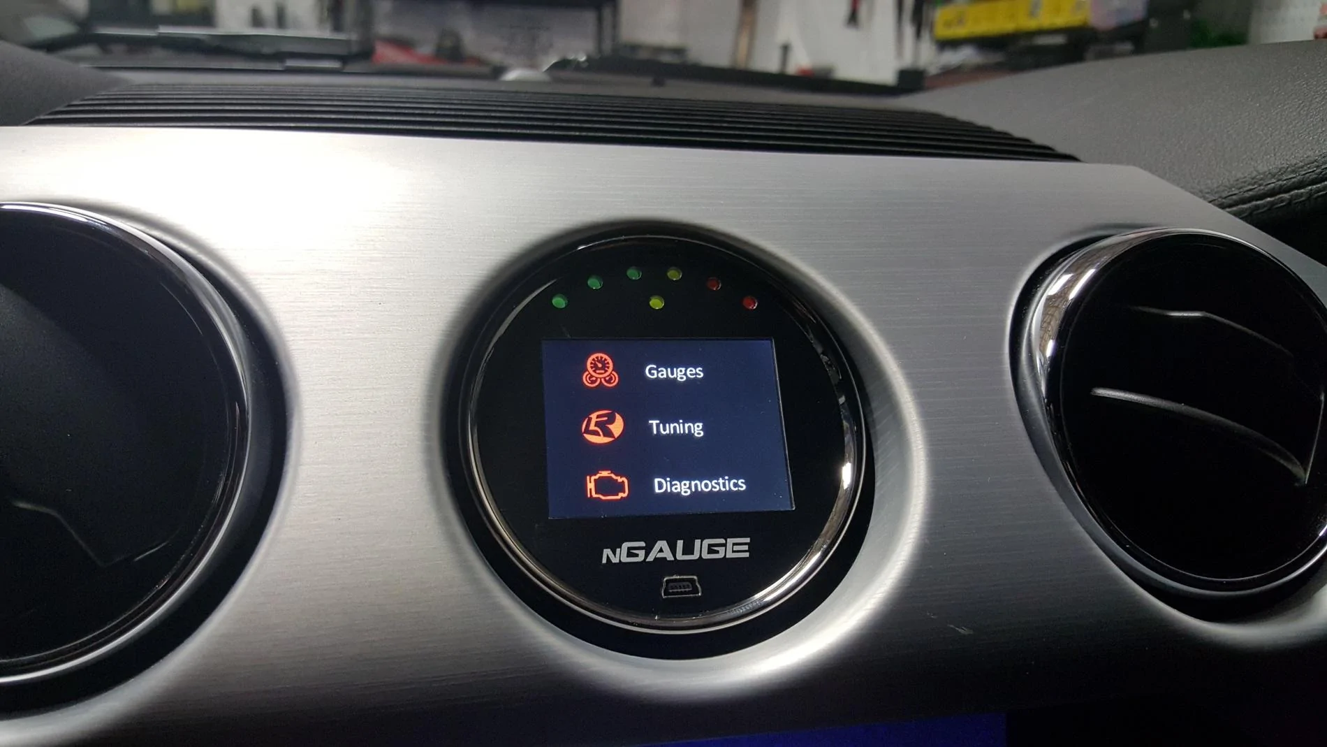

Also installed the Ngauge today.. Install was simple but it powers up by the OBD cable but cannot "connect to the car" all fuses good and wiring tight. Not sure what is up with that.. have a message in to Lund to see what they think.. Cant really do much without being able to datalog/tune!
the BMR springs lowered the rear a slight bit, 1/4 " on p/s and a little less on the d/s. Installed the shocks in neutral position on the knobs with no adjustments yet.

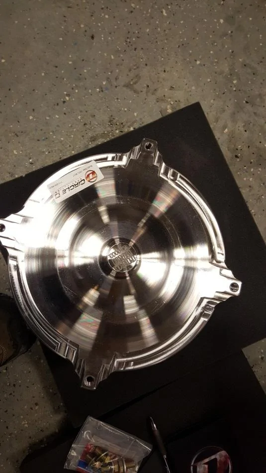

Should have some free time after Christmas to get a free weekend with my help to do the converter/headers/ driveshaft and hopefully get my transmission jack as HF does not stock the high lift model in the store.. Which job would be easiest to start and finish with to do all of that at once efficiently??
